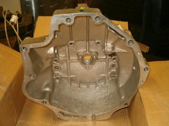

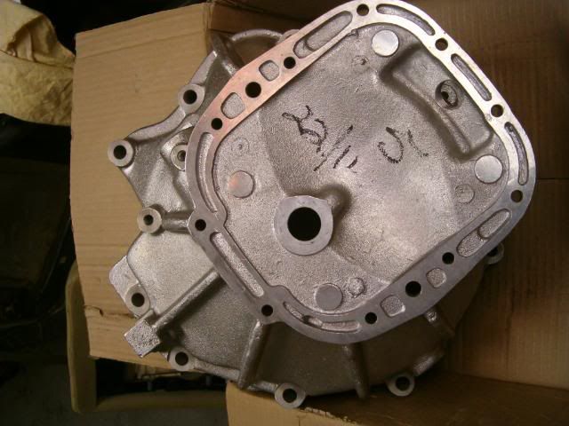

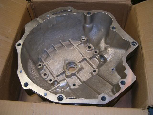

- Posts: 170
- Joined: Mon Sep 11, 2000 12:01 am
Re:
I would love to have more info on this piece if possible.
I'm trying to adapt a 4.2 Audi V8 to a porsche drivetrain, the bell housing I have is from an early 924 turbo, and and only aligns in 2 bolt holes.
this piece would solve a bunch of my woes.
Dutch VeeRod wrote:Have bin to busy with other things last few weeks so not much done on "De Konjel"
but Finally after almost a year searching I have my bell housing to bolt my Audi V6 to the T3 Vanagon gearbox
. Its brand new and got it from a locall VW dealer in Wonderboom, South Africa
The search went from my locall VW dealer in The netherlands, the import company of VW in the Netherlands, the VW factory in Wolfburg, Germany, then Steyr in Austria, the VW factory in South Africa, and finally the VW dealer in Wonderboom, South Africa.
BART
- ajdenette
- Posts: 717
- Joined: Wed Jan 20, 2010 1:18 pm
Re: De Konjel
ViolentBlue here is what I know about that is the Vanagon South African Bell housing, When VW of South Africa took over Production of the Vanagon they retired the odd Wasserboxer and started installing the more powerful and common VW 5 cylinder gas engine into the T3 Vanagon Chassis in order to mate it up properly they also cast this bell housing it is commonly refereed to as the South African bell housing and unfortunately is getting to be a rare piece to find these days. one side is the common VW bolt patern for the engine the other is the common bolt patter for the 091 vw van gearbox. this is all from memory sorry about no part numbers and I could be wrong as well. unfortunately TOS Vanagon forum where you asked the question is a better place to find answers search for the Limey thread over there and read through all 3 of SyncroGhia's build threads as there is a lot more information about what you are looking for.
