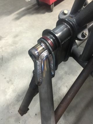

Looks great! What type and thickness aluminum is that?

That metalwork looks superb. Had you done that before or is this a first?

I've done quite a bit of sheet metal work, first time on the buggy stuff though. I still need to grind the welds and do some finishing work. I will start on all that stuff in a month or so.
I have a windshield project coming up soon for the buggy. Gonna tie it in smoothly with the hood.

Devastator wrote:Looks great! What type and thickness aluminum is that?
5052 .063

Thank you.fordfreak wrote:Devastator wrote:Looks great! What type and thickness aluminum is that?
5052 .063

I couldn't leave alone! Drove me a bit nuts.CentralWAbaja wrote:I bet that Tweeds stuff drives a weld guy like yourself nuts![]()
Shock mounts look nice
