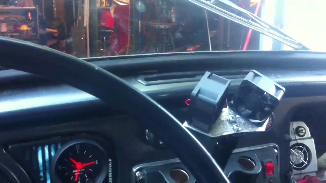

I haven't had a chance to use mine yet - but it should work if it moves enough air. We use a marine bilge fan (like sold in under-the-seat fan booster kits) and hose to de-fog the inside of the windshield in my Buddy's circletrack car. I have heated-air plumbed to the center vent - well if I fixed the heaterchannels

I see, thanks. I didn't see the center vent. Mine doesn't have one.

That is very clever with the cigar lighter mount and all. Well done!

Got the Baja going this afternoon...nut & bolted the few things that got swapped-out and wound-up having to pull the passenger carb off and clean it to get it to play nice again. I was worried the new tires would be louder - but so far upto maybe 45/50 they seem excellent - and the server fans seem to help keep the windshield clear too. Now I've got to start thinking of those trans mounts seriously...after I find the CD player screen I tucked-away months ago - whoops.

Well, finally put a few miles on it - and the dash fans certainly do help clear the windshield, even with no HE's plumbed-in

Glad she's back on all 4s again Chris. Defrost is nice to have isn't it
. I wish I could keep my side windows clear, ...front and rear side glass are usually steamed up if it's cold and wet outside, even when it's toasty warm inside.

My baja is as dry as it gets inside. It's all the people breathing and bringing in the rain on our clothes that steams up the side glass. I need some of those PC fans mounted to the cage on each side to get some air flow over the glass

OK, so when I went out today the Baja had a sheet of ice on the inside of each window...after putting a heater in it and cleaning the windows off for an hour or better I finally put a few miles on it since having performing a front-end alignment - seems better. First time I've had it upto 50 since the wreck and everything felt sorted and nice
Now I need to see about getting some short heat-exchanger-to-body conduits, our spares are all much too long - brrr
The dash fans certainly do keep the windshield clear, it was the only window that didn't fog by the time I got home
