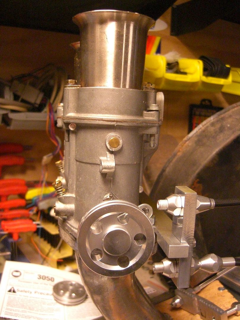

Well I finally received all my parts from the machine shop and I'm getting some kits together
I can put together Dellorto setups, but, I can only do the Weber setup (at this moment) if the carbs are specifically left and right, like the Dells are. I should have the proper bracket for the universal Webers by the end of the week.
I'm also waiting on a DNCF carb to arrive and hopefully get something for that crowd soon
and lastly here's a shot of an IDA setup, I just finished....
more to come....
more to come....
