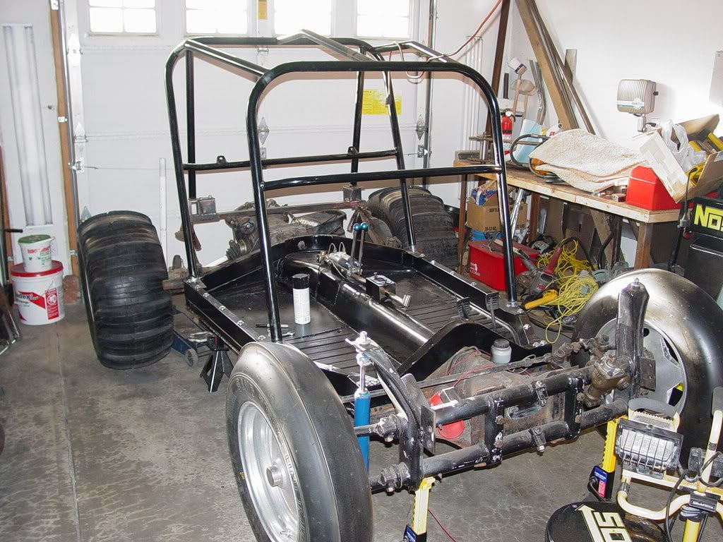

And below is my finished rollcage. I added cross bard down lower at the body line from the rear hoop to the front hoop.

As long as you have about 4 inches of head clearance (that is the accepted figure for the sand at dunes here) you should be OK. I don't know how they came up with that figure but I have been told 4 inches of clearance many times. The guy who built my cage is the guy who modified many of the rails' cages out here after the one particular roll over.
Ryans top bars are quite often refered to as "T-tops" and are OK, an easy get in style cage. Since we have trees and trails in the dunes, the outer bars are often placed more outboard. This is to protect the passengers in case a (slow?) roll/slide into a tree. It causes you to have to fold in the middle to get in and at my age and shape, that is a full days work!

Ryan, are you going to put switches on the flat part of the console or leave them on the dash. I am trying to figure out how I am going to do it on the black buggy. When you are strapped on tightly, it can be hard to reach the dash. I don't want a passenger to be able to panic and reach over and turn things off although in a wreck it may be necessary. Still debating that one. I would also recommend a mast battery switch if you don't already have one.
