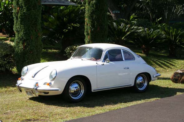

For those of you that need to know, patterns for glass are made the same size as the NEW window holes. I did my lexan windows and they fit perfectly.
Edit: I put a piece of cardboard up to the backside of the opening and trace the hole on it. Once I have a good even fit inide the window hole I transfer the pattern to gator board for a permanent pattern then to the lexan itself.
I have the front glass installed and it fits perfectly, if anything I might make the next set 1/16" larger than the hole.

Fitness..
Can you please clarify.. wouldn't make sense these would fit.. we have a gasket and wire to also fit in
I'd guess there's at leaset 1/8" space needed

Fitness,
Just got done with my chopped glass. You are right about the 1/16 bigger on the quarters. I cut some cardboard for the doors and installed them just as windows with the trim in for a perfect fit. The rear was a bitch! The angle changes so if you cut it to fit the opening, it will be too small. So I cut a piece of luan underlayment and installed it as a window first to get the correct fit. I used 1/4" thick Lexan and a heat lamp to relax it. The lower corners really sucked! I am not sure if I should have used 1/8" thick but I was affraid it would leak. It would have been much easier.
I'll try to get a picture up. Looks GOOD!
