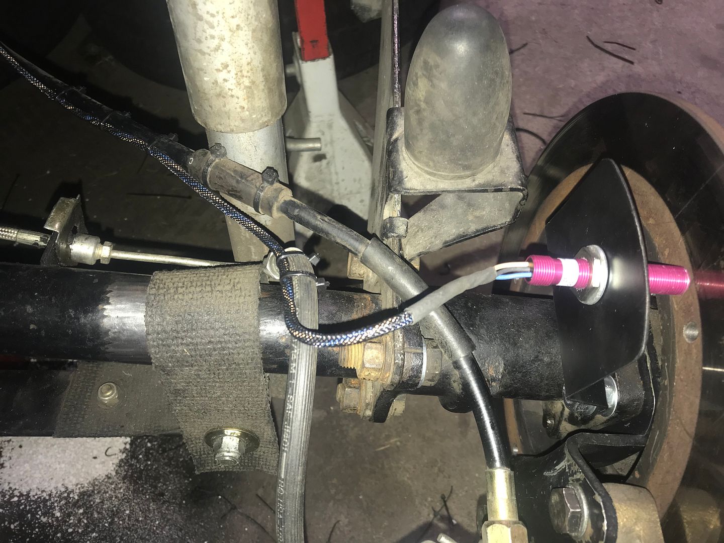

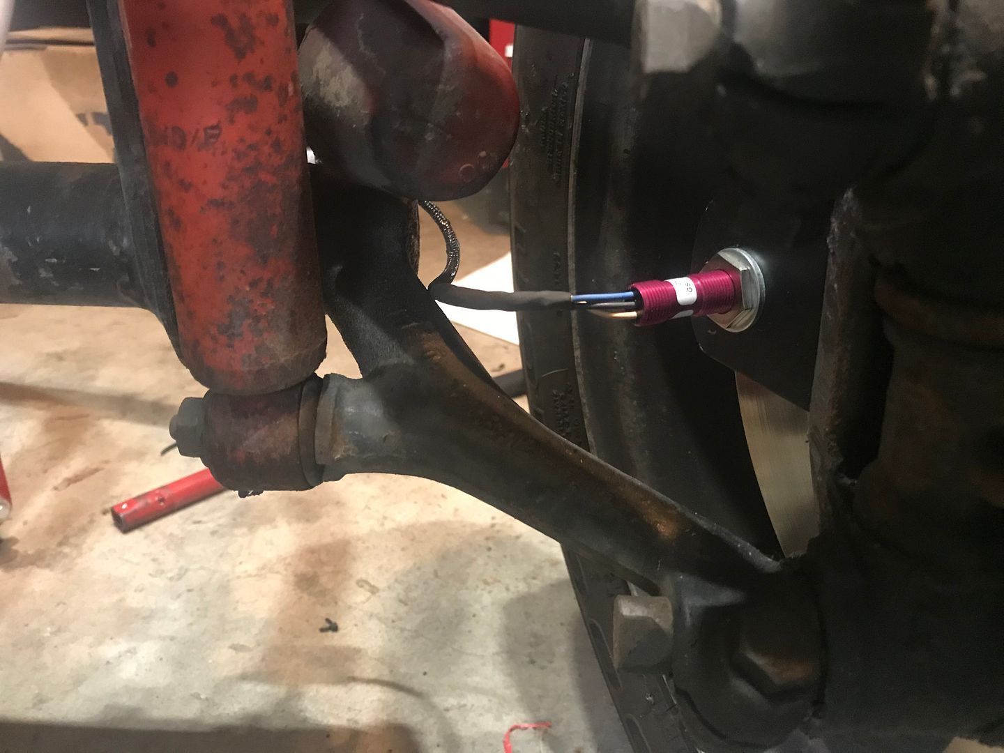

Mine are installed but not hooked up yet....maybe this winter.

Is that a hole you drilled in there? Are those magnetic based?

Isn't that whole part farris material?

Five holes in line with the chev bolt pattern but in the unused area.

buguy wrote:Isn't that whole part farris material?
If it’s raised or relived it sees or doesn’t see it. Mine is on an all Farris part but the bolts provide teeth

Roger that. And i assume you can specify how many "teeth" there are?

Post by Schweg »
Yep, and how big it is that’s all in tuner studio
