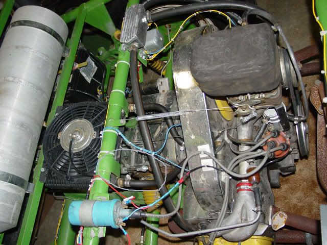

Marc, wasn't there some kind of difference in the front of the engine (flywheel) in the oiling area at the top of the block? Close to 10 years ago I did a type 3 pancake to up-rite conversion. If I remember correctly had to drill out a hole in order to use an up-rite oil casting (I don't remember what it is called right now) in order to make the up-rite shroud to fit and get some oil cooling done... as I remember. Other than the oil routing solution and the dipstick thing it was as you said.
You can barely see the oil lines here that go into the oil cooler I added.

Yes, all type IIIs use m6 hardware to affix the cooler - last used on singleport Type I (1970 in the US). The "universal" cases like your Mexican one come ready for m8 but with no cooler stud - the accompanying hardware kit comes with one m8 stud for doghouse cooler, one m6xm8 step stud for singleport, and one long m6/m8 for the Type III cooler, as well as a couple of bushings to reduce the m8 "ear-holes" to m6 for the singleport or Type III cooler.
Type IIIs also have their oil pressure warning light sender threaded into a boss on the cooler so the sender boss on a Type III-only case isn't drilled/tapped.
Type III DP cylinder heads also usually have some extra "flying-buttress" gussets cast in near the sparkplugs which need to be nibbled away to clear stock Type I DP overcylinder tin.
Re: Worth a rebuild?
Thanks for the extra knowledge, that will come in handy.
