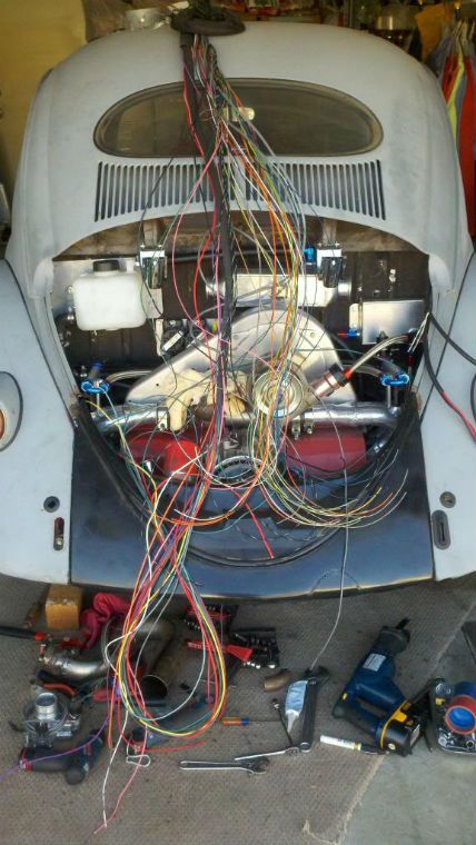

Actually the biggest hurdle I had with MS3 was figuring out what to do with all the extra WIRES.
I have more I/O than I can currently find a use for, but I'm working on it...
..And adding an IOX, for CHT/EGT/oil pressure/temp/fuel pressure/relative humidity/stripper alert/multiple VSS monitoring/traction control and just rediculous overkill.
