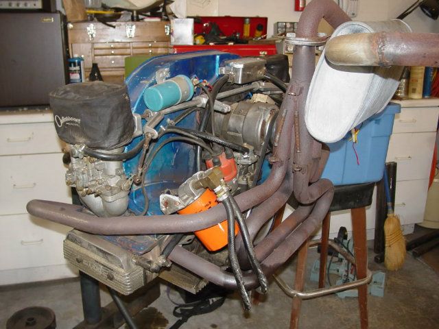

Re: Engine Question - what goes here?
This is how my engine was re-plumbed and not using the expensive stuff. The hose is not at the top of the line; e.g., the heaviest you can get, but I think it was pretty close to it at the time.
Remote oil filter housing runs in the $14 range, minus filter and fittings, while the same mount with braided hose and AN fittings start at somewhere around $114 and goes up from there.
http://www.mooreparts.com/store/product/736/AC117106/. This is an example of a exhaust manifold mount for the remote oil filter. There are others around that add more locations or features but this is quite often what one needs.
