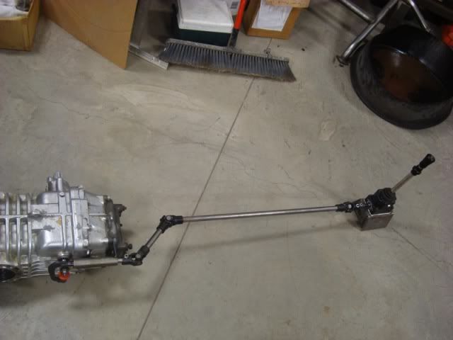

Here's some pics of what I'm talking about. If anyone is interested, call Weddle to get one, as far as I know, no-one is selling it yet, except Weddle.

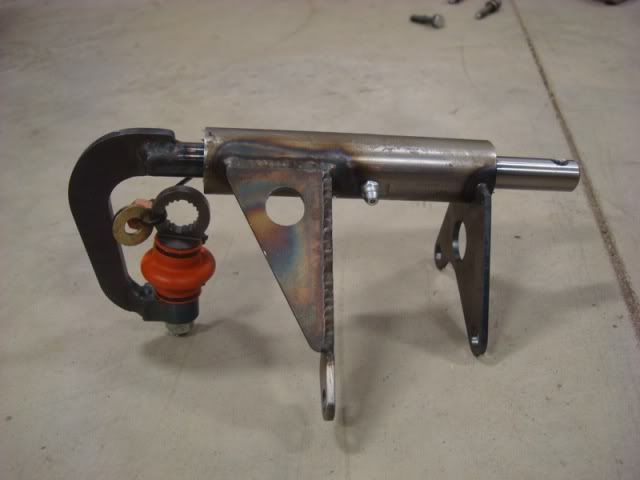

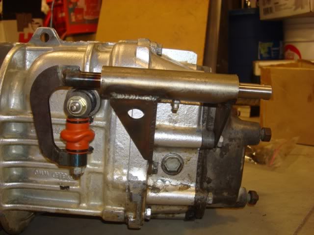

Heres what i came up with..Had to dump that expensive shifter for a modified stock shifter. Now it works great.
Use your good eye!
winifredevw
Posts: 1574
Joined: Sun Jan 07, 2007 7:08 pm
Re: Different Shifter Linkages Thread
Post by winifredevw »
That's only half of the story, what did you do back at the transmission? Give us the Paul Harvey. :)
