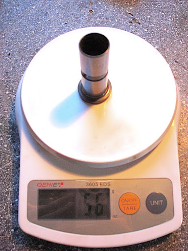

Santa just delivered a set of great new lifters for my project
Pauter P3E8, and CB Performance 71g Lifters are for Sale now
Wish you all merry christmas !

Nice! Mine weighted exactly the same

nice. are those T4 size? no inserts required?

Hi, they are T1 size, inserts are already in the Case

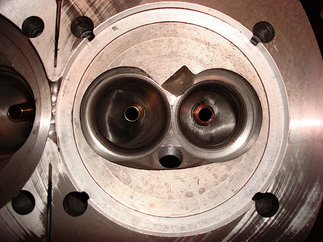

Found their site:
http://www.limflug.de/index.php?page=products&lang=de
German only, didn't see parts available seperately.
aircooledWBX wrote:exactly !ruffbiker wrote:limbach heads come in wbx headstud pattern as standardLimbach is a german producer of aircraft engines, based on Typ1/Wbx.fastback wrote:where cani find more info on these heads??
They are very close to Type1 Heads. Double ignition is applicable, maybe i wanna use it.

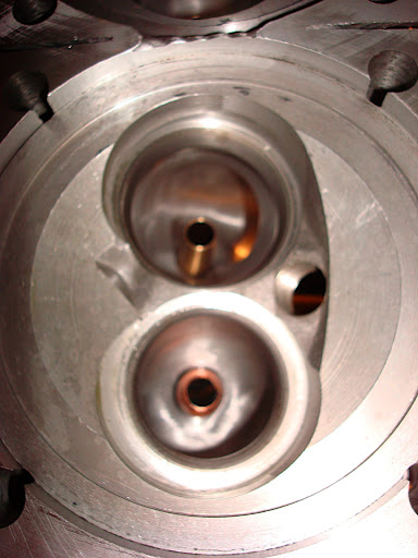

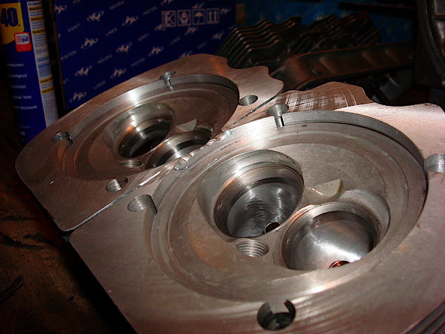

aircooledWBX wrote: -New Limbach heads with 42mm and 37mm valves
Greets from Germany,
Nick

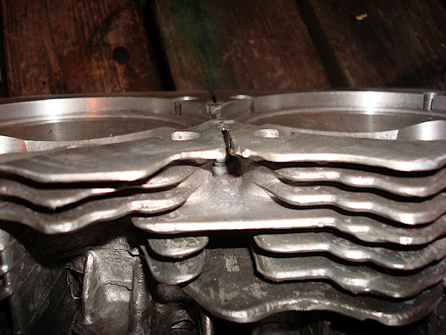

Did those heads require welding between the cylinder bores ?
Kinda looks that way.

Hi and a happy new year !
yes you're right, they are welded.
At the moment I think about using 100mm Deutz cylinders.
I talked to someone who builds oxyboxers all along, an he said, the
103mm bore woud run perfectly in a low compression engine with about
150hp, but for more rpm/compression/hp, smaller bore would be the better way.
So if someone wants to build an high-torque oxyboxer for his Bus an searchs for cylinders/pistons
pm !
And if someone has a set of Deutz cylinders /100mm Pistons
pm !

Why does a 3mm difference in the bore make a big difference ?
- Posts: 33
- Joined: Wed Nov 04, 2009 1:59 pm
Re: aircooled WBX 2546ccm
At the moment the bore is 103mm, the cylinderwall at the top is 3,5mm. With a 100mm bore i'd have 5mm cylinderwall.
Thats about 40% more thickness. Im not sure what im gonna do
Also depends on if somebody wanna buy my 103's.

Some of the Type 4 guys run 105mm, using the same casting as a 103.
- Posts: 33
That may be, but they still have a 5mm wall in a Type 4. The bore in the Head of a Type 4 is 115mm.
Mine is 110mm.

What does this guy use for pistons and barrels ?aircooledWBX wrote: I talked to someone who builds oxyboxers all along,
an he said, the ... smaller bore would be the better way.
100mm = 3.937"
- Posts: 33
He uses modified Deutz Zylinders and Porsche pistons.
