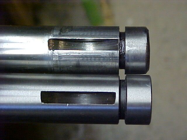

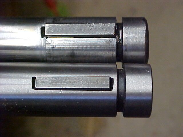

JB17Atita wrote:
david58 wrote:Seems like a keyed pressed on gear would be a lot better, than just a pressed on. I wonder why no one has designed one?
huh?? what is a keyed gear? pardon my ignorance
This is an example of a keyed shaft without the key.
This is an example of a keyed shaft with the key the gear would have to be machined to accept the key.
JB17Atita
Posts: 38
Joined: Sun May 24, 2009 6:07 am
Post by JB17Atita »
Nice!!!!!! woodruff key!!!
and I suppose that a pressed gear is without the key
just a smooth shaft, right??
Thanks for the pic david58
