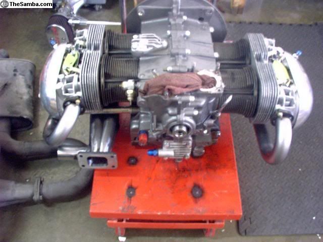

I've just bought the same style of exhaust as you.
I can see where you have reversed the left head manifold and presumably added an insert to clear the water pump.
Did you need to do anything to clear the oil filter?
Ta :wink:
Stephanhipwell
Posts: 94
Joined: Wed May 14, 2008 1:59 pm
Post by Stephanhipwell »
AMBROSIA wrote:I've just bought the same style of exhaust as you.
Ta :wink:
oi cheeky, yeah i added a slight bit and did a couple of slightly angled cuts before and after the filter so it bends round it.
i'm waiting on a couple of tools to come and i'm gonna make one like this as it will A be a bit tidier and B ready for turbo in the future. :)
AMBROSIA
Posts: 248
Joined: Wed Jul 27, 2005 5:37 am
Post by AMBROSIA »
Thanks for that.
I better get some spare pipe bits then :roll:

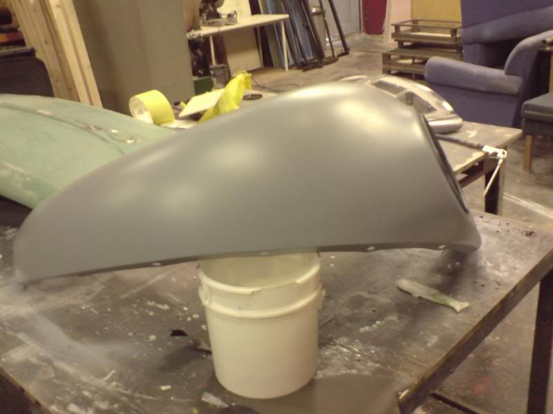

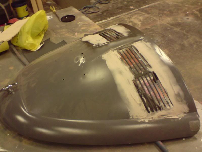

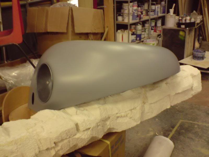

engine stripped and i've started to clean it.
also doing bodywork stuff:
