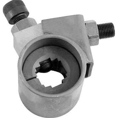

Skidmark wrote:The type of adjusters he has stripped right out (in camp). Had to come along in his Toy 4x4...
Yup...didnt even make up that little hill :x. but dont worry if i do put adjusters in they will be the this kind, not the stupid avis ones.

Leatherneck wrote:If he stripped these out then we need to rethink this whole thing. These do pretty good. I have not had any problems in taking off or landing.
Yea i didnt even leave the ground...but they were the avis style ones. The "teeth" (circled here) just stipped almost off when the suspension compressed hard.

My last beam had the adjusters posted above (not the Avis style ones) They took a pretty good beating, but they ended up bending that bracket thing and then they shoved the threaded rod down thought the jamb nuts.
My new beam is cut and turned and I don't know anybody that has had that fail, but I'll probably be the first :D

Big Dave wrote:My last beam had the adjusters posted above (not the Avis style ones) They took a pretty good beating, but they ended up bending that bracket thing and then they shoved the threaded rod down thought the jamb nuts.
because they were designed to off road with, the avis ones were designed for lowering, look at how the leverage on those adjusters would change from the lifted position to the lowered position. im suprised you even broke those dave.

I have front adjusters but they don't look like either one of those...
Mine has like four bolts pinching the beam together in the center and two allen bolts with jam nuts on the outside. To adjust you loosen the four bolts and the jam nuts. Then you rotate the allen bolts to raise and lower the front end. Anyone know what I am talking about? I can't get a good pic with the shark mouth on the car. I may have an older pic....I will look.
