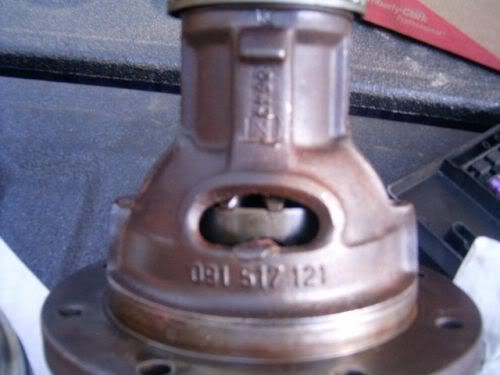

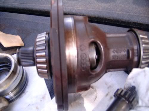

I bought this 091 carrier with the lockrite in it. I put it in my 002 3 rib.
All i can is you point it and it will go, get a push sometimes when riding in the woods. Got to use the clutch or let off the gas and it will turn. I might be getting a baja if so then it might turn better in it.
