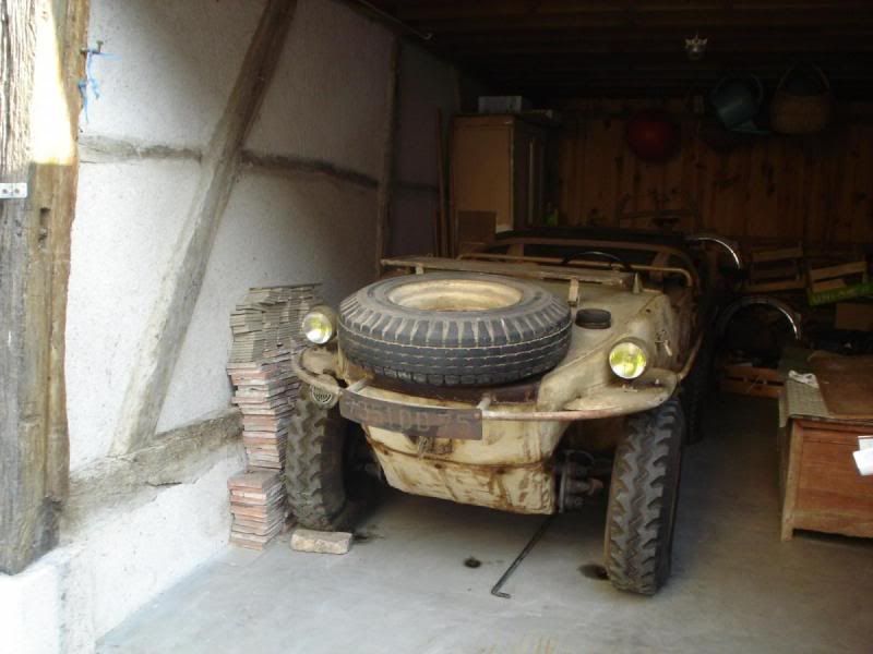

Now, here is a lucky Schwimmer story, A real nice VW166 has been discovered in France, and snapped up by a lucky dutch man.
The vehicle had been owned for the last 60 years by a french guy that bought it in 1950 from a scrap dealer in Normandy region. I guess he is knocking on now, so deceided to part with it. It is a great thing to discover and purchase something like this, I really envy the new owner.
