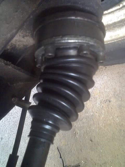

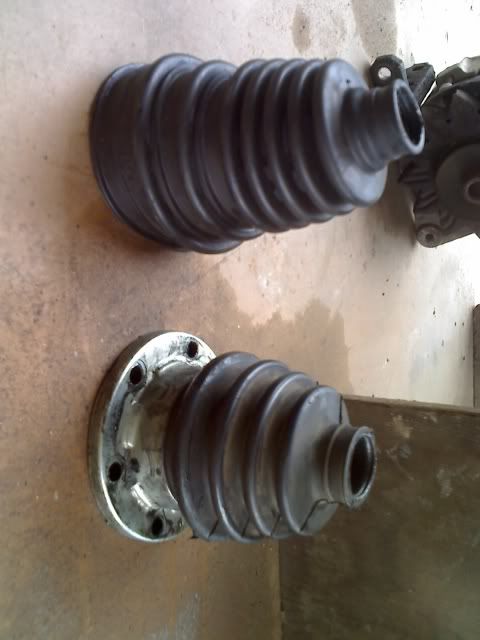

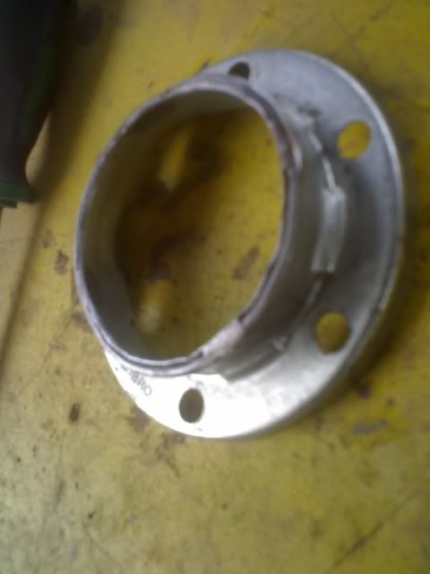

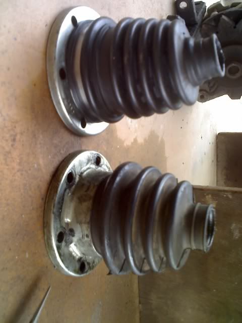

Quick thing that has sprung up over the few months - I found using the T4 cv joints race prepped that my cv boots were breaking up every few trips. What it turns out was happening, the axle was actually chewing out where the rubber boot is folded into the tin section of the boot. The stock T2 boot only allows for maybe 20 degrees of travel.
So here is a quick fix for this using toyota hilux IFS boots. As a bonus these are alot more flexible rubber and cost about half of the vw boot and alot more avalible
Is a really simple thing really. cut the boot off the tin, grind the inside out of the tin (the bit the axle is hitting)
Weld a piece of 1/8 wire around the outside and make sure there are no sharp edges
Cut the bottom ring of the toyota boot, they appear to be generic boot used on more than one type of toyota and have three different locating rings stepping down in sizes. The second fits very nicely over the vw tin and the welded wire fits inside the locating ring.
The very bottom ribs of the new boot are quite tight on the cv bolts and may be a bit of a fiddle to get on now, but I think as a bonus this may help stop the bolts from working loose
Sorry about the cell phone pixs by the way
happy motoring
nils

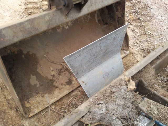

Now that is farmer ingenuity; bending a skid plate with a tractor. You would blend in nice here in Idaho!

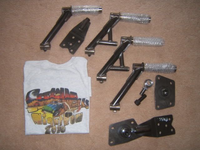

The front arms bent while jumping it on fraser island (LR brand - shouldn't surprised really) So the aussie dollar being so good at the moment have a set of Eagle arms coming. Also have noticed that my rear tyres are wearing alittle funny, turns out I some excess toe in happening, so getting some coilover conversion plates coming from eagle aswell. Big shout out to BAJA5 for helping me out will those again, am really liking those things you boys are building.

Got my packages in the mail this morning. New set of arms and coilover conversions from eagle, Also a little surprise extra from Baja5, thanks man. Measuring up a few nuts and bolts needed to change things over today aswell as turning that engine over, has been close enough to 2 months.

remember, the plate marked "pass" goes on the drivers side.
