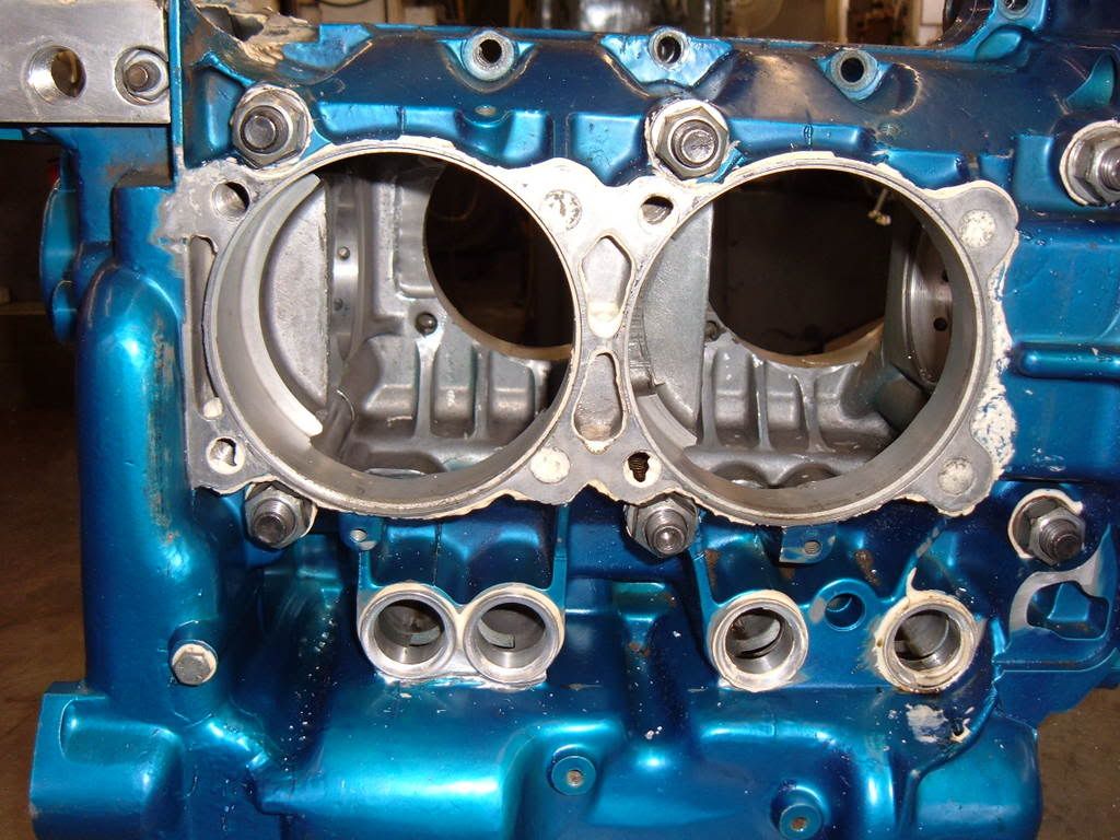

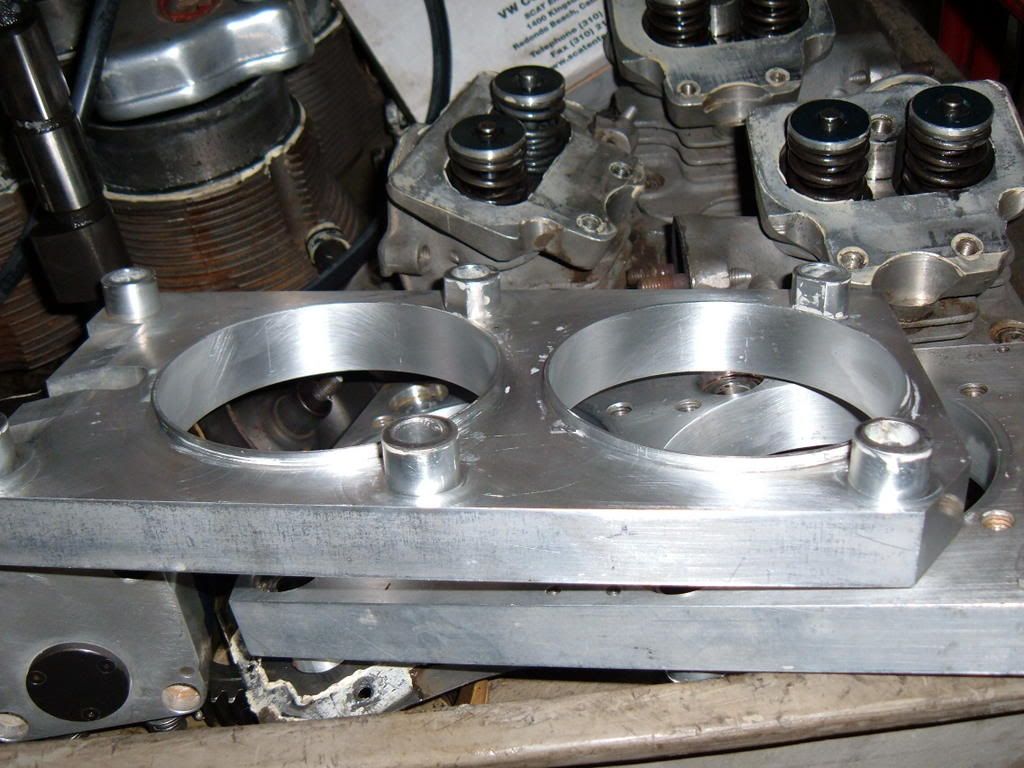

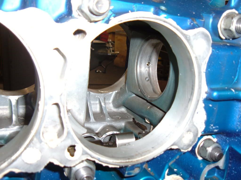

No I don't believe the cas was decked very much, here's a pic of the back side of the plates and a couple of the case. Saw the motor in the buggy, it was a mid engine with a 914 901 5 speed, didn't gets any pics of the buggy.
Stroke was 84mm and the rods were 5.850"
Richard

Thank you Don, I think those pictures were a big help. Do you know who made the plates? It would be nice to just be able to buy some.

M-Owen wrote:Thank you Don, I think those pictures were a big help. Do you know who made the plates? It would be nice to just be able to buy some.
Hi M-Owen
If your talking about the plates just previously pictured, I posted them, and my name is Richard, Don is a nice guy, probally the nicer of the 2 of us... :lol: ...but these arn't his pic's.
I know the guy who made these, and was gonna see if I can get him to make me a set, if he doesn't want to much ? These do have some time in them, but he made them for him, so don't know if he will do any more ?
When he had the motor down, I was gonna see if I could have borrowed the plates to have them scanned, then a CNC program made, but the guy that does CNC work had to take off, so wasn't able to get it done that way, at least not yet ?

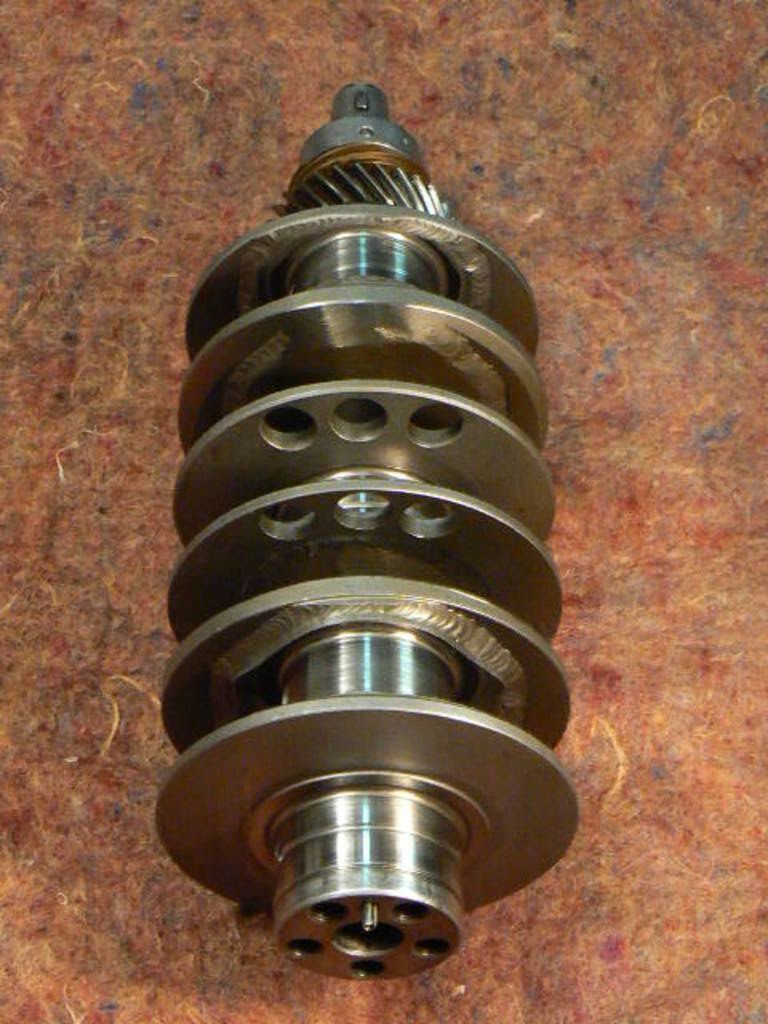

Here's a Pic for Don, Type lV 66mm.

Frallan, do you know what the stroke on this crank was ?
And no one has commented on the rod bolts being backwards... :lol:[/quote]

Hi Frallan
Thanks for replying. I was wondering about the stroke ? To be able to run 10,000 rpm and live since 1977, and in a Type 1 case. I think is very interesting. As is the guy who builds 47mm stroke Type 4's that turn 14,000 rpm.
The thing is getting these motors to live at these rpm's, then there's getting the valvetrain to work at this rpm. The overhead cam setups makes it alot easier., but the guy who does the 14,000 rpm motors does it with push rods.
I just picked up the full circle crank I pictured earlier, and will try to build something to turn some rpm's. Maybe even with a Turbo.
