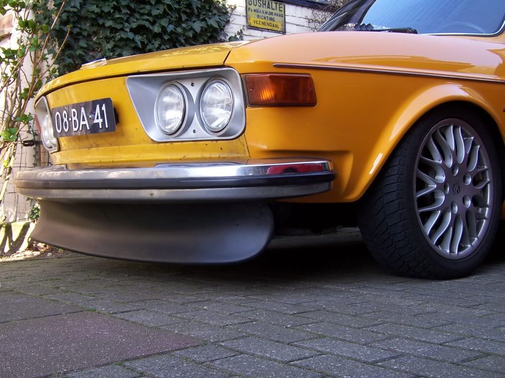

Kamai, originally for 1302/03 models.vwfye wrote:what is the spoiler off of?
before anyone gets further ideas: Its not mounted and the original holes do not match. Its just hung on the bumper, wedged onder the front tow hook..
