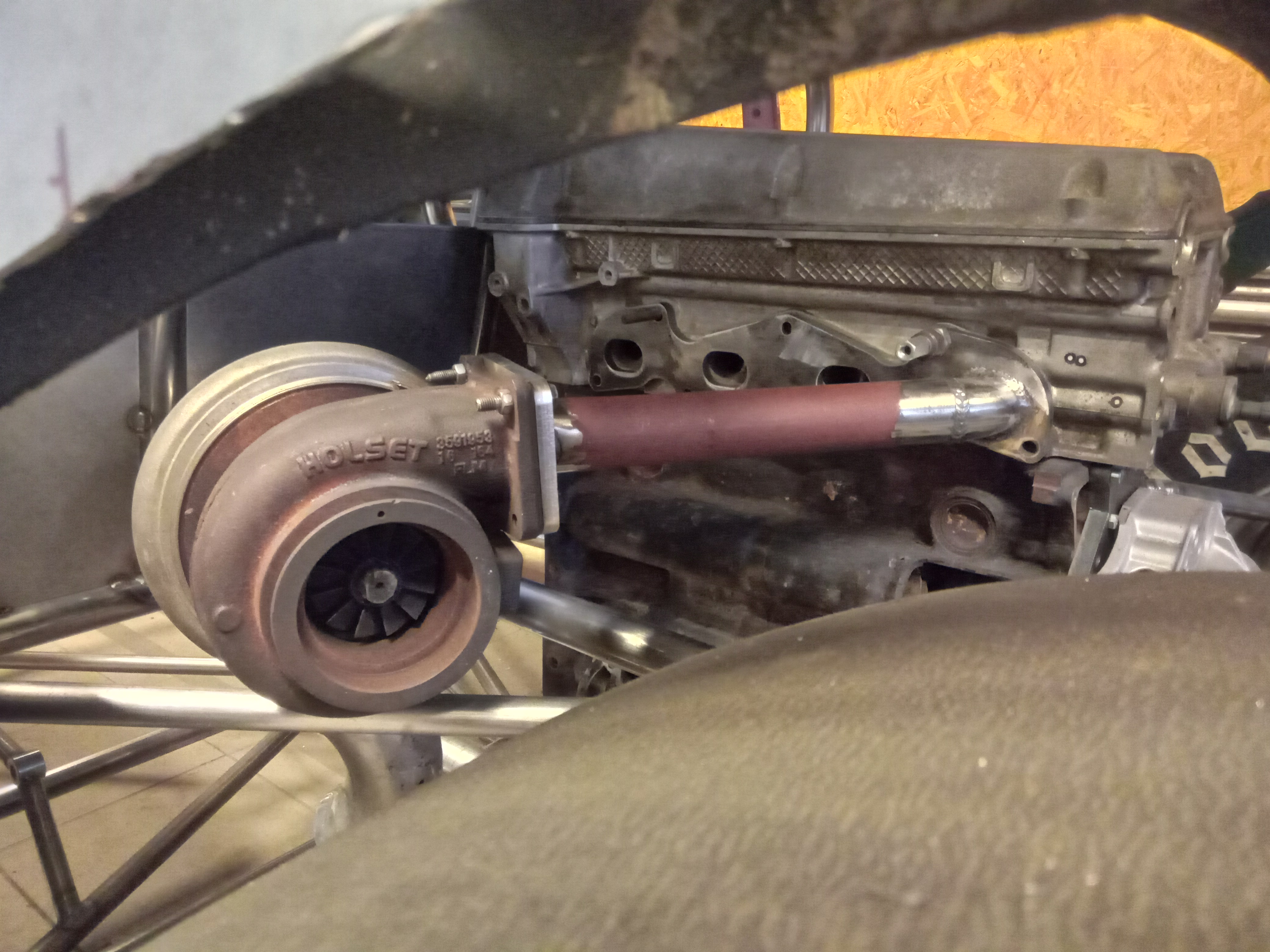

For my car YES, I'll make intake and exhaust. Have done few turbo plenums, some itb setups and tens of exhaust manifolds. Actually its the easiest part of that car and not worried about that at the moment. Planning exhaust as direct as possible / split entry. Liquid intercooler will be with icebox mounted in front. Wouldn't needed with methanol or under 30PSI with ethanol but this time we go between 40 and 45 PSI and still ethanol. Its all based on that it really needs that power and it puts that down (we race on concrit and its prepped no more than 1/8th usually so you cant go insane after that.

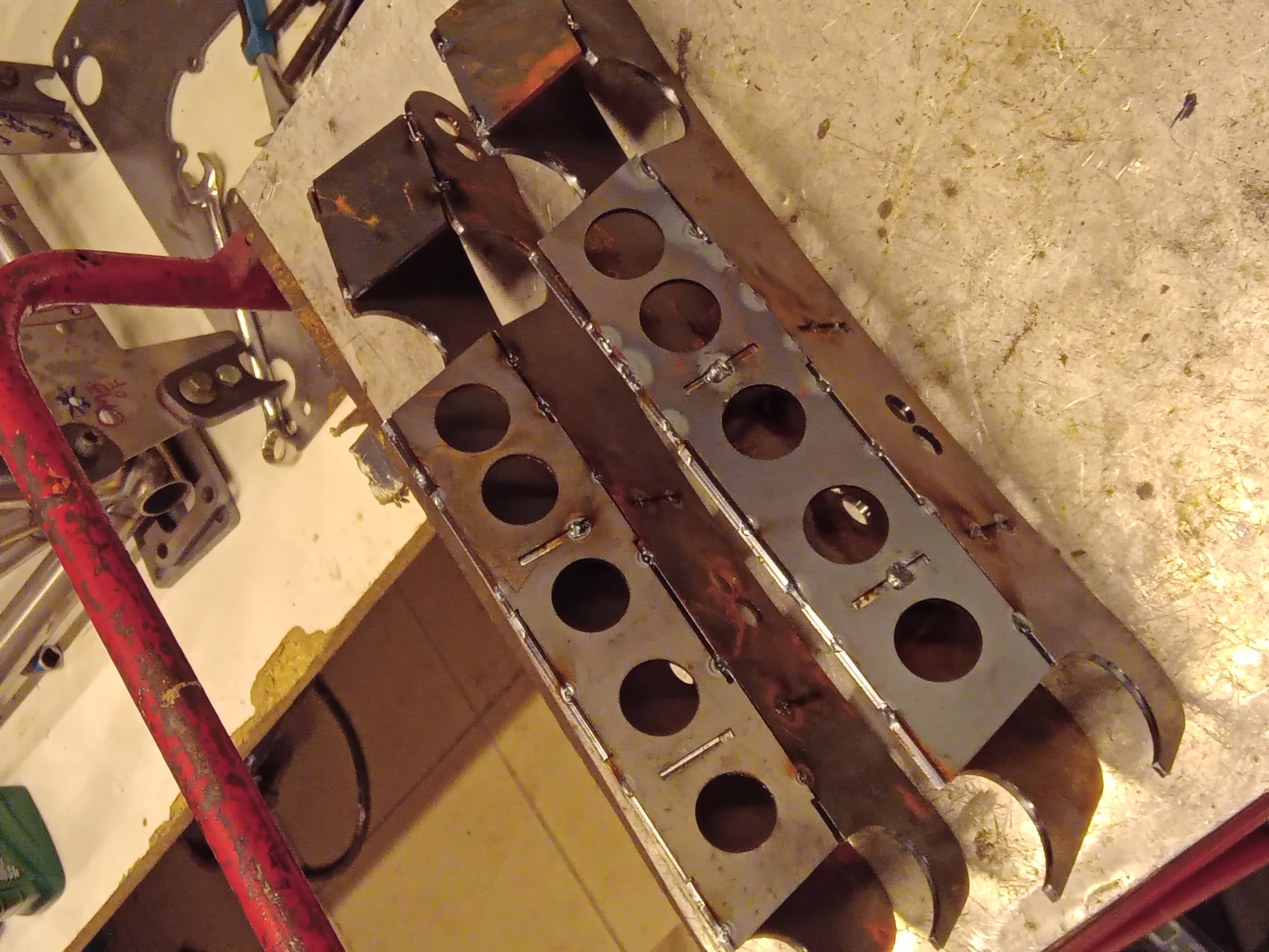

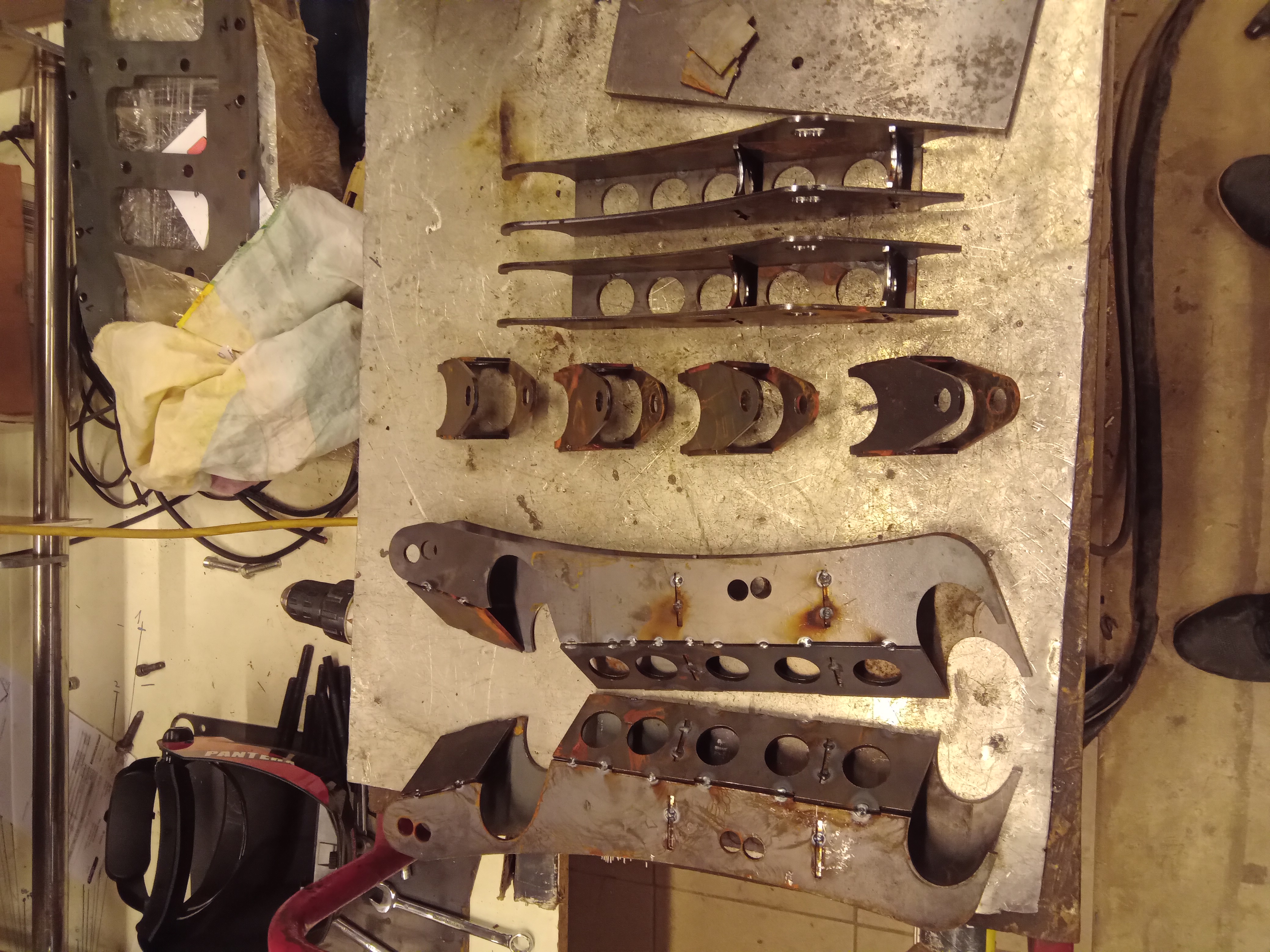

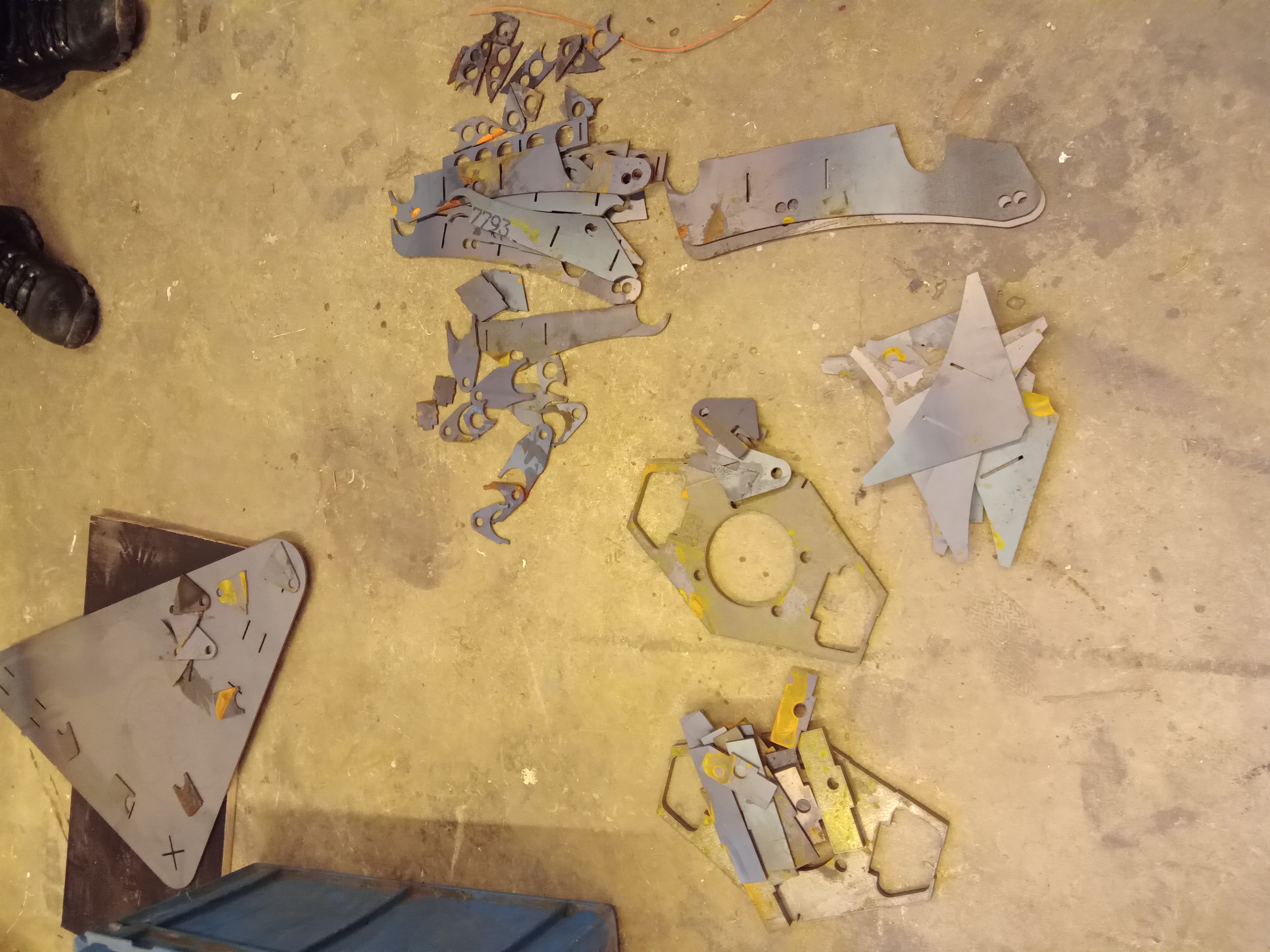

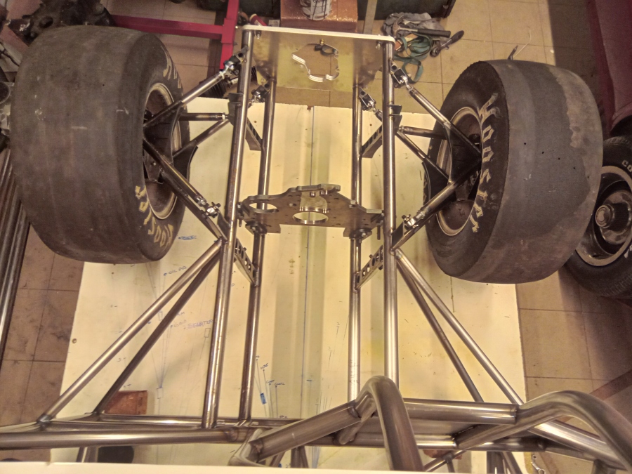

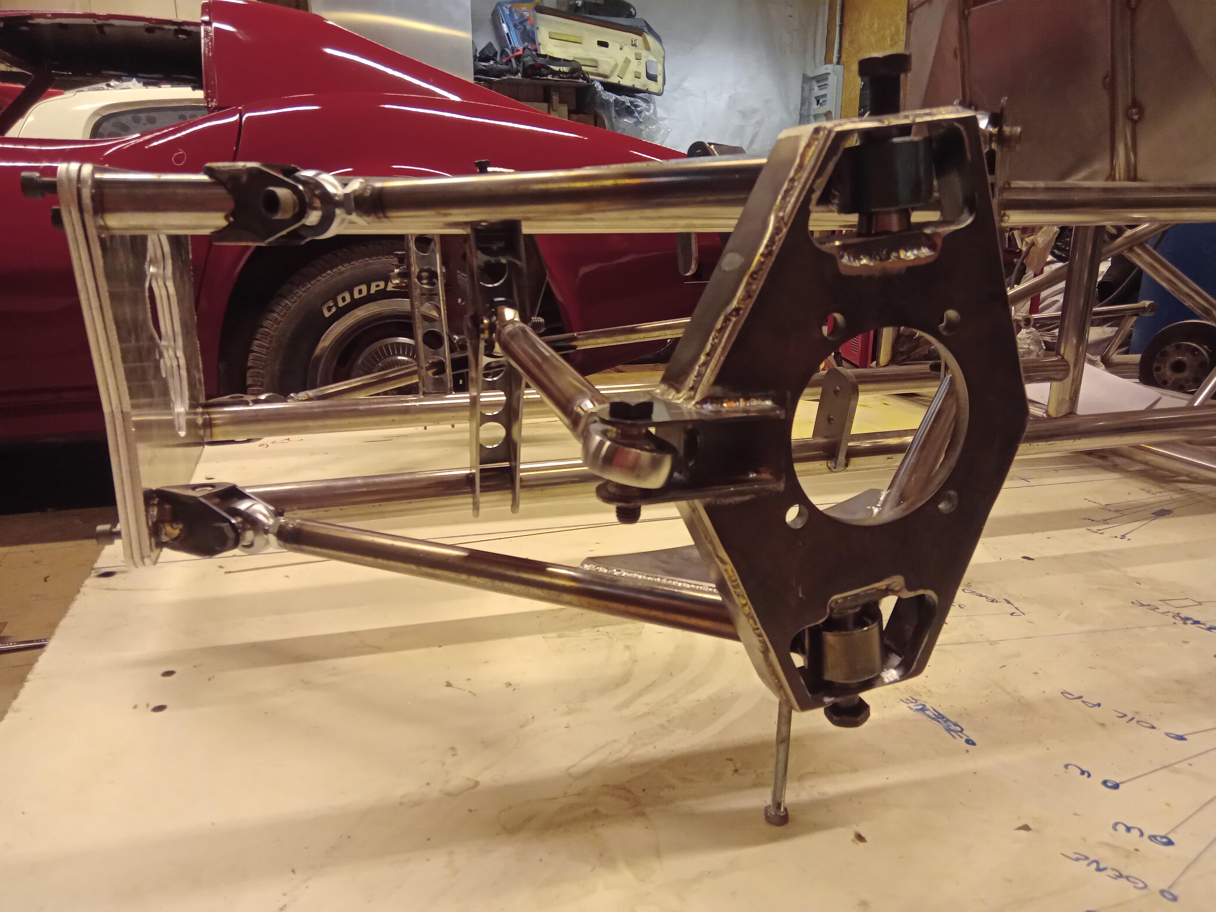

One important point for me, its on its rear wheels
A lot of modifications compared with last car.
This time its 40cm tighter
That was the main reason for inline engine.

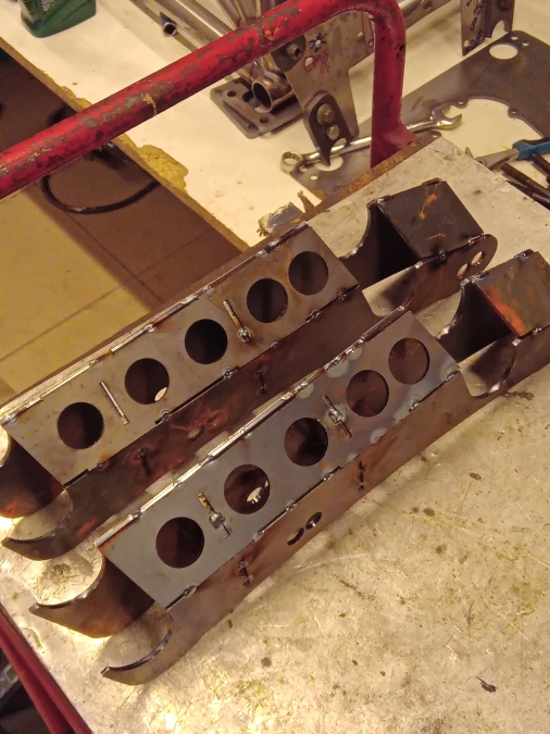

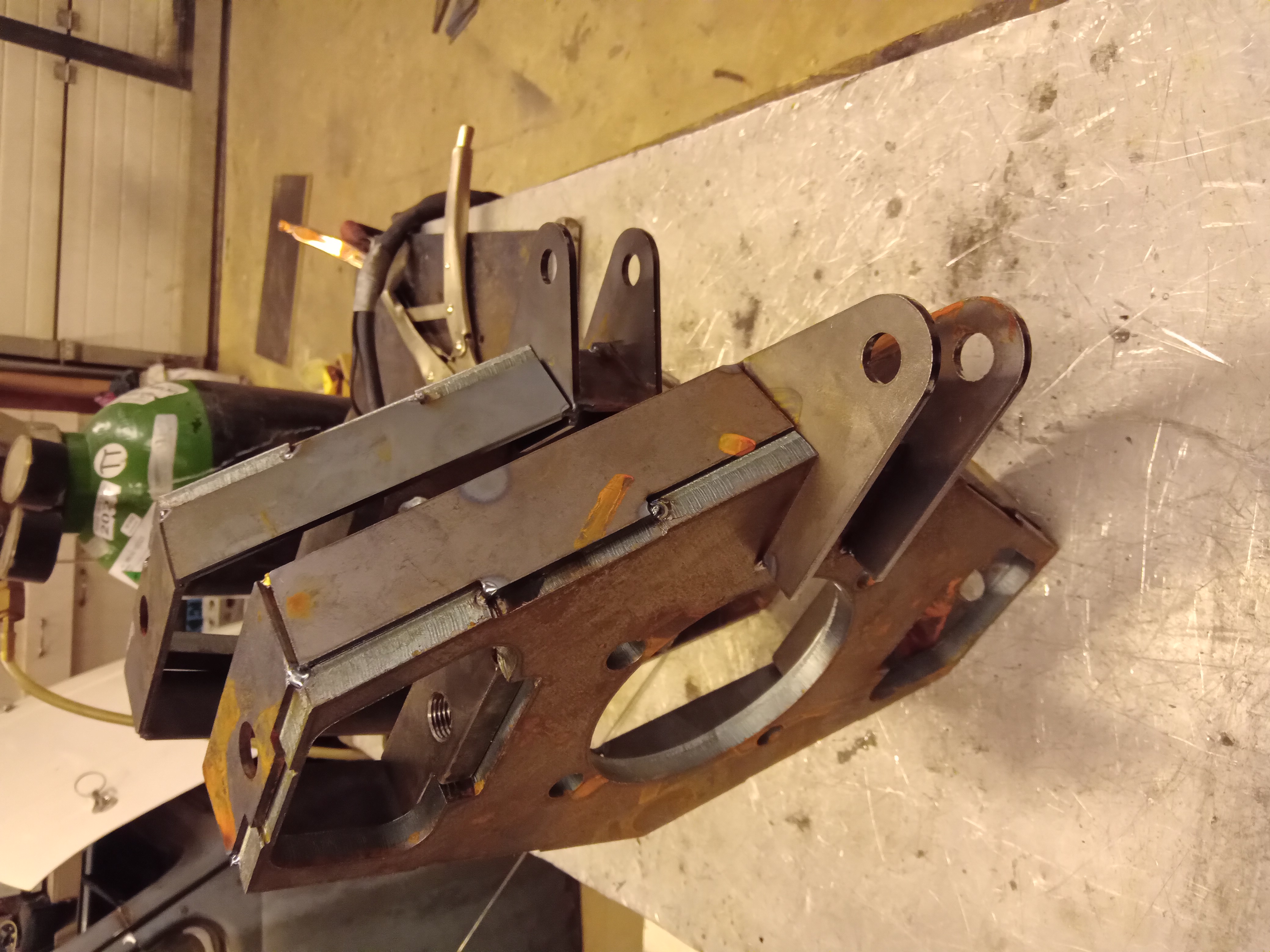

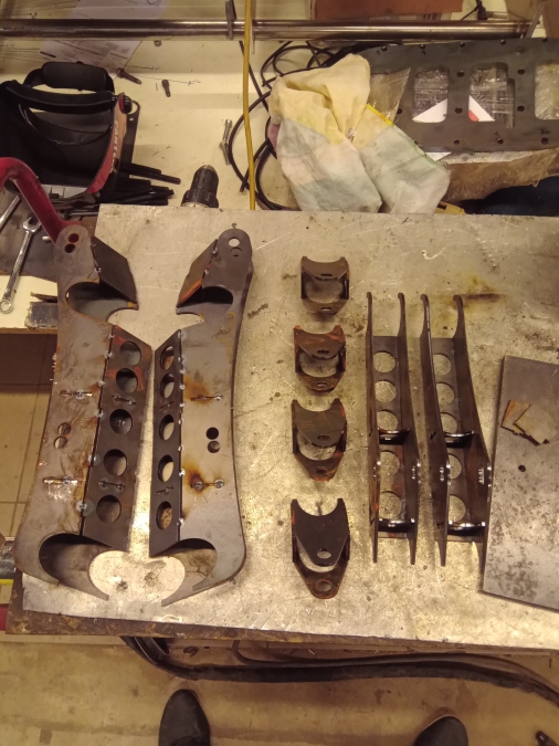

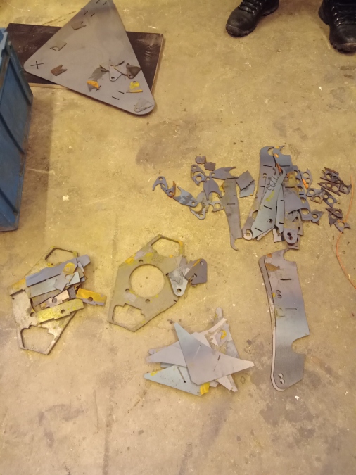

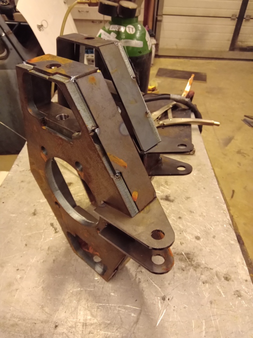

Docol R8 is amazing and it comes really light.
There are less antisquat points because we learned that we never go under 100%. This time we have 100 and 120% variants with AS (last cars min was 75 max was 95)
Learning the TIG welding, so its not perfect but it holds - I'm sure

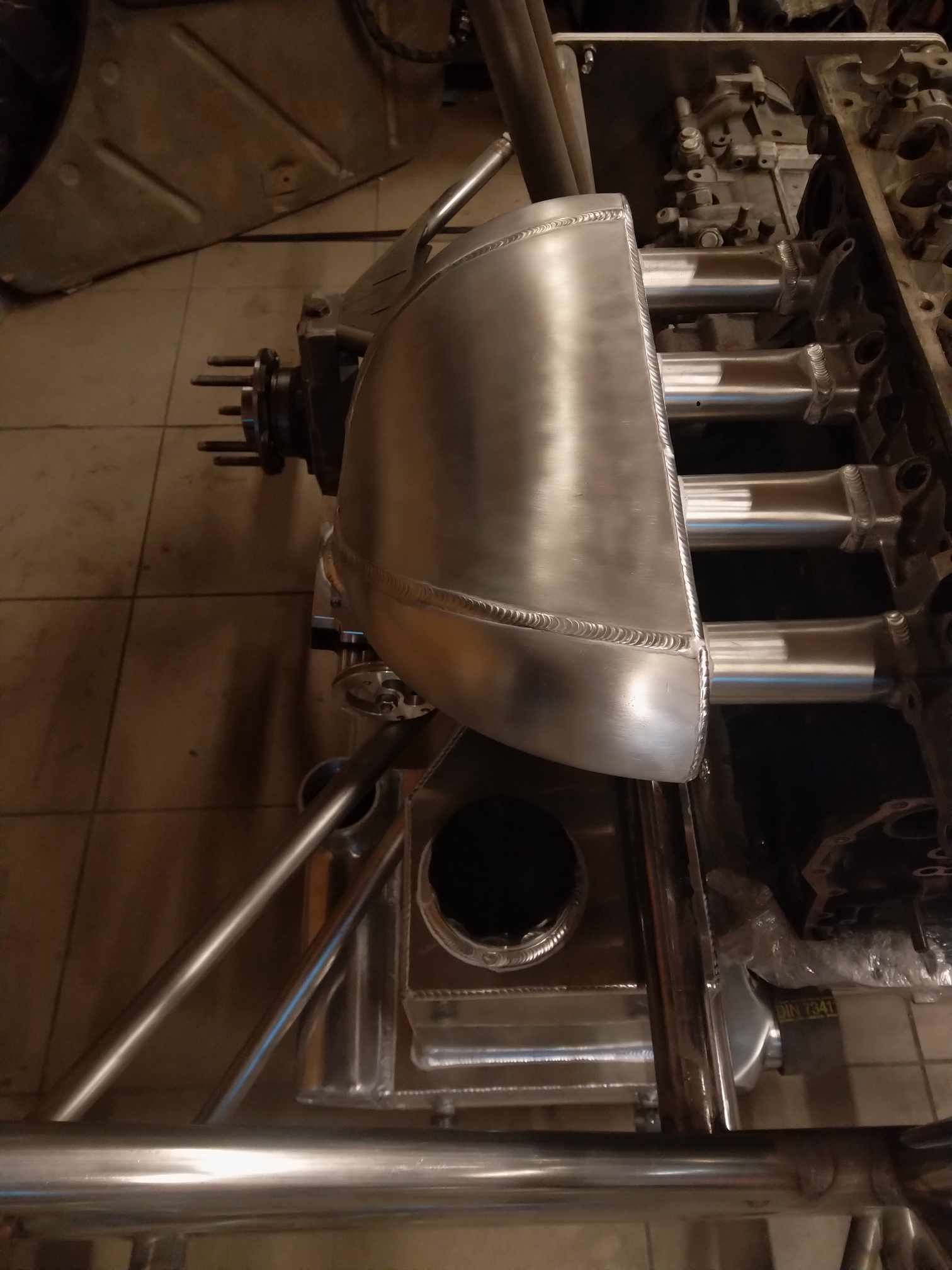

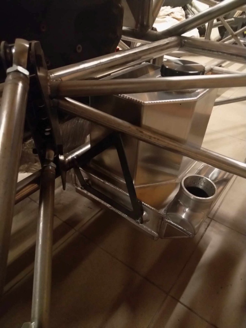

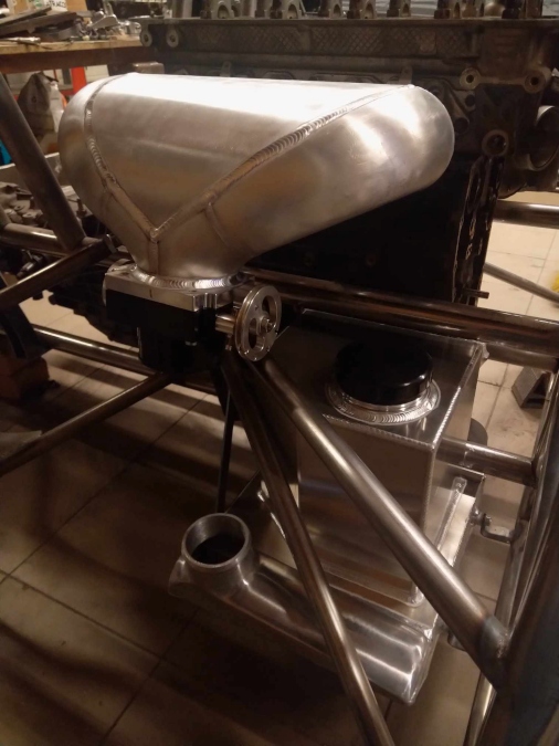

Got the cooler finished, and intake going, welded by my friend (Thatswhy I don´t try to do it myself on aluminium)
Now I need to roll few intake parts and finish it up, ad a throttle and make a 1 short pipe from cooler to throttle.
The head is also almost together after I get the grinded valve lashes (I´ll go with solid lifters this time)
If you want to see the updates quick you need to check my facebook page: https://www.facebook.com/WhlsUP

It goes really slow but now got intake welded (by my friend) and made a brakets for cooler.
Also got new 80mm throttle (10mm larger because it has thick shaft inside and 70 would be too much resistance when target is near 800hp and one day maybe a 1000. Intake plates were rolled from 4mm aluminium and welded as good as possible, should hold up to 4bar of boost but I'm quite sure my first target comes under 3. Also I have 400kpa map sensor in my own ecus (Estecu)
It all quite tight because there are only few mm between pipes and frame, ic and frame etc but that´s how it was planned and I´m happy to see it all fits.

Re: My next drag beetle build.
The intake design is ingenious for its use of bends and flat rolls. The craftsmanship on all of it, the SS, the aluminum, the frame, all amazing.
