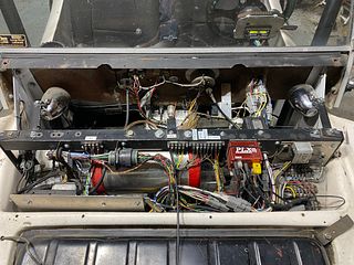

I have soldered many connections on my wiring harness....especially the first go around way back when. I also used Terminal strips for connecting wires.
I now have graduated to using the terminals for all the different plugs that a wiring harness uses.
EFIconnection.com is a great place to get new plugs for a lot of sensors especially for the GM brands. You can get the EV1 style for injectors with terminals, all temp, map, tps and others are available along with the IAC valve plugs and terminals.
Mario at theDubshop also has terminals and plugs if you want to order from him.
I have also switched over to Deutsch Connectors with the solid pins for most any connection I need in the middle of my harness. I love the way they fit and you can easily disassemble them if needed.
I even use the round 35 pin connector and I have a 31 pin connector on the bench ready to add.
It's taken me awhile to figure all the correct terminals to use and some of the GM plugs are a PITA because you insert the wire through the plug, crimp on the terminal then pull it back to click which means you can't disassemble it without cutting off the terminals and redoing them.
Nothing is cheap if you want it to look professional and you end up having to buy three different crimp tool to do the correct job.
I always get extra terminal so I can practice to get the correct crimp then build the harness.
