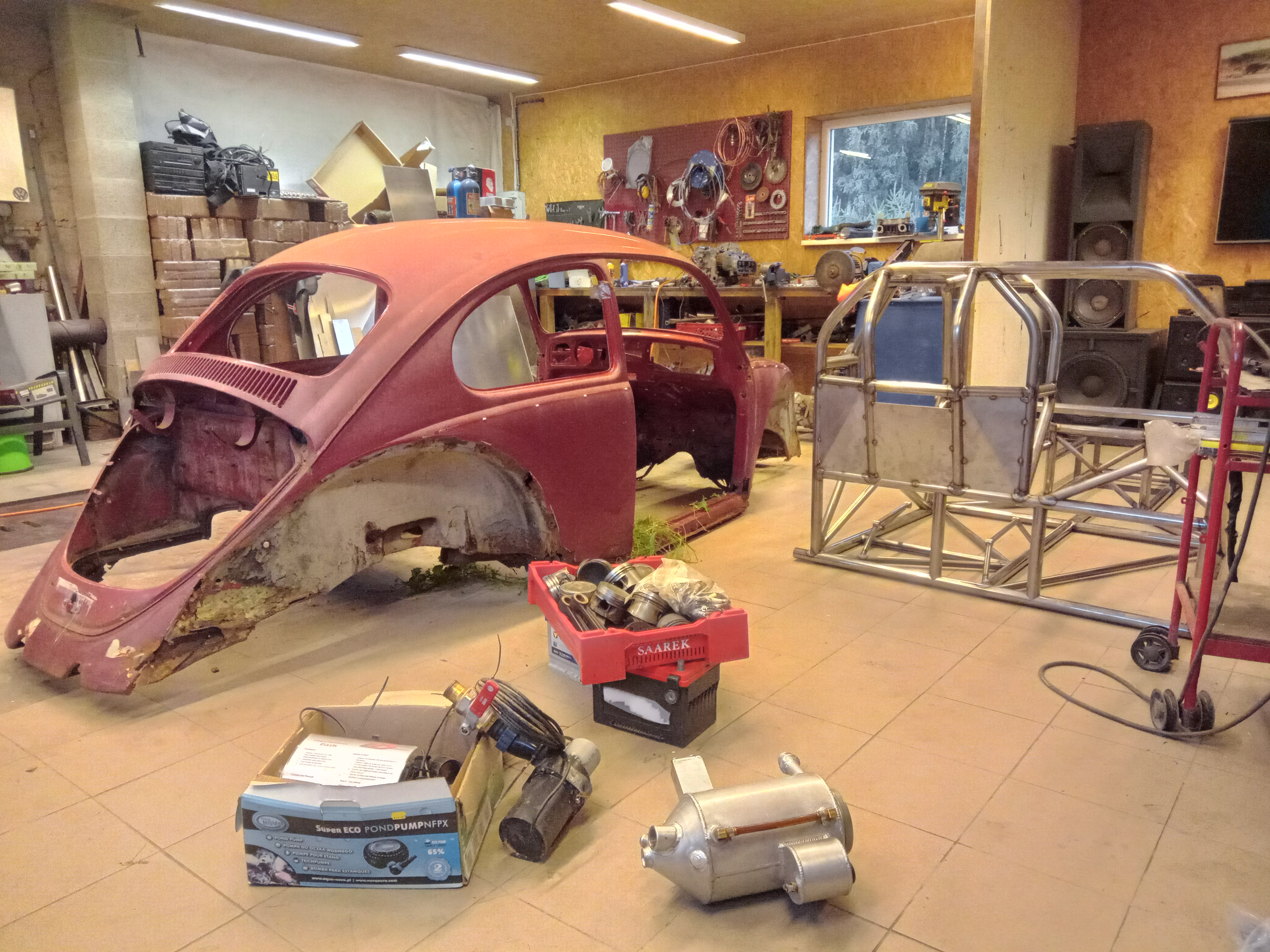

New vs. old:

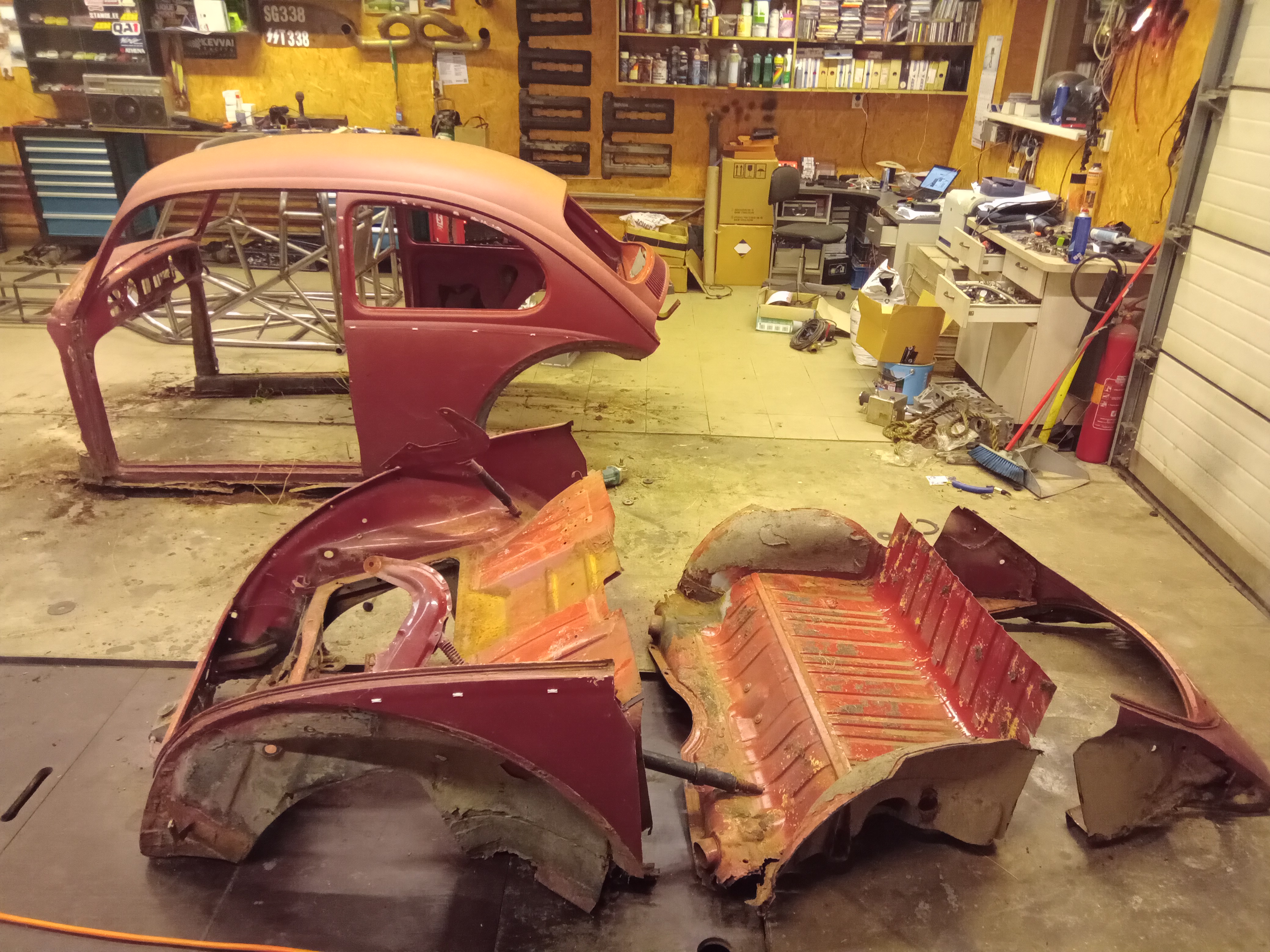

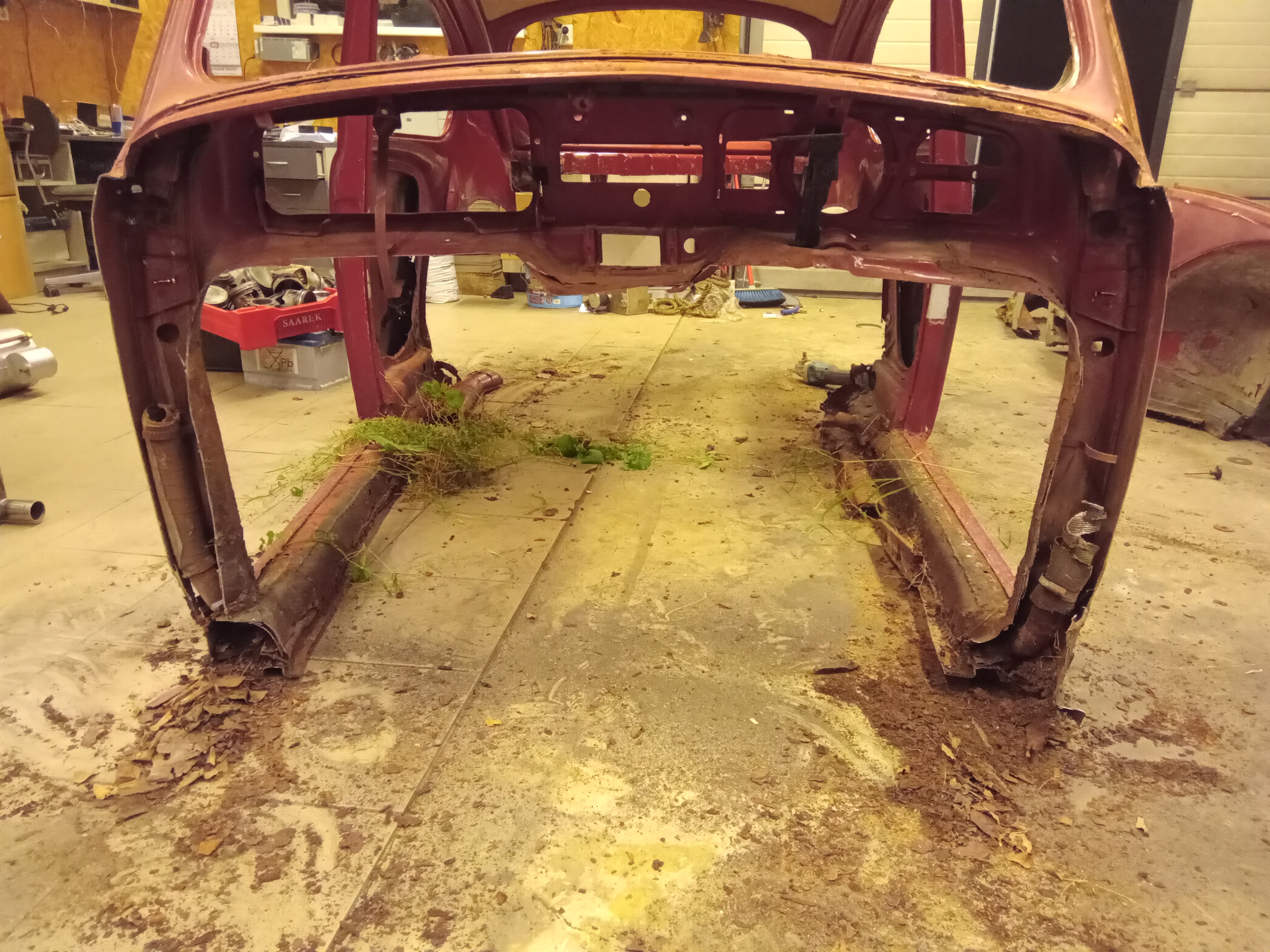

Body that somebody donated me:
After some cutting:

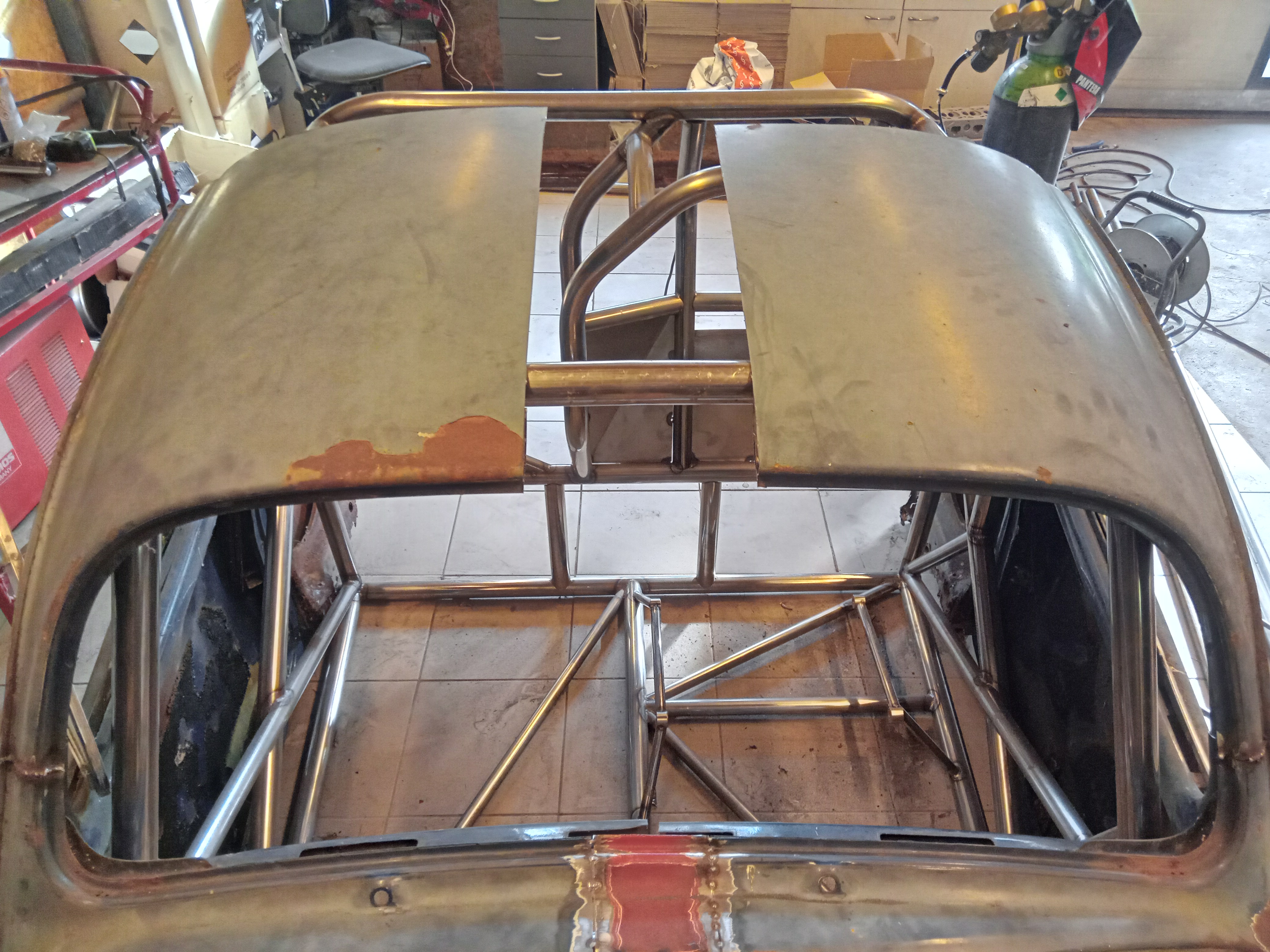

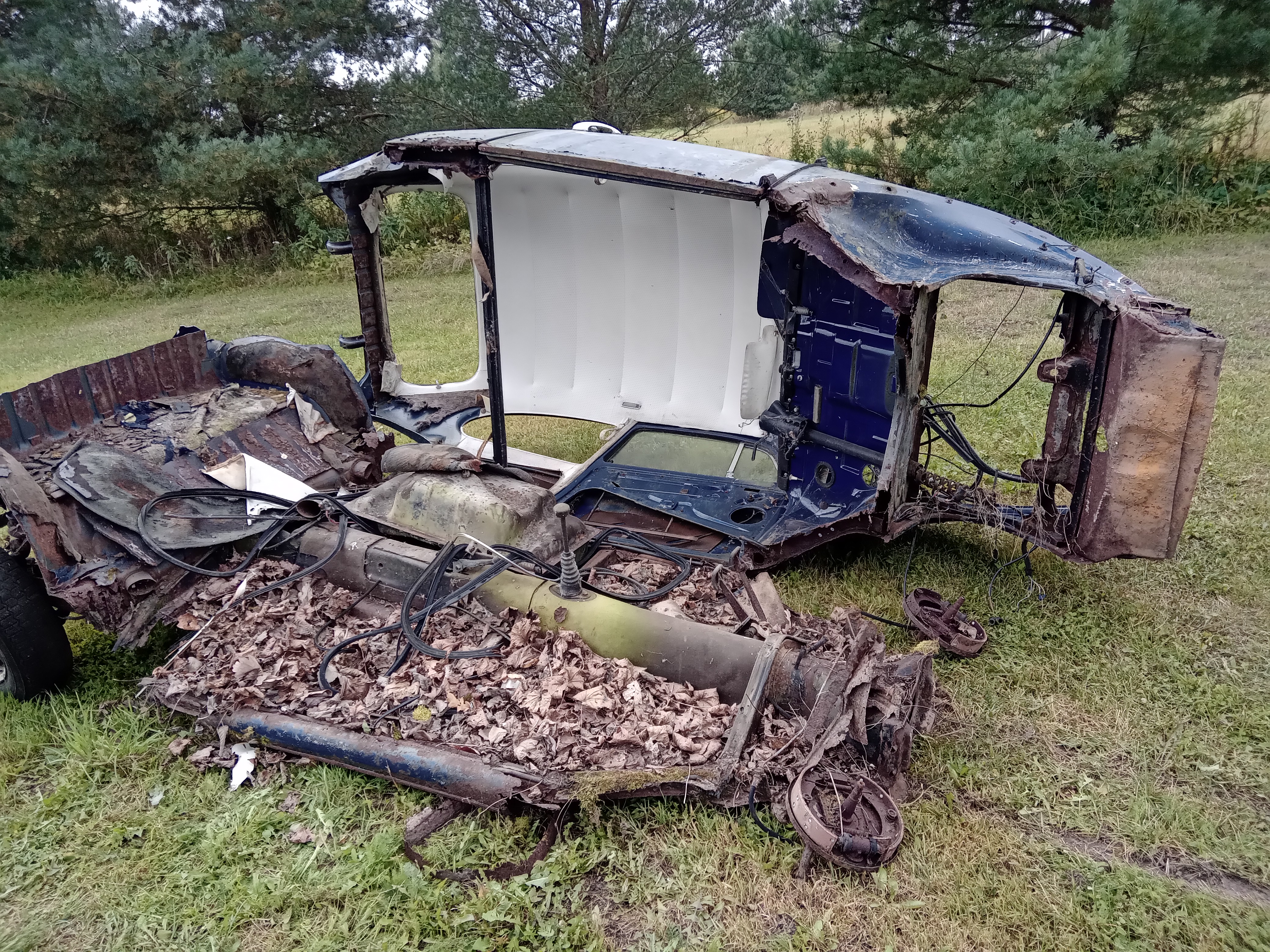

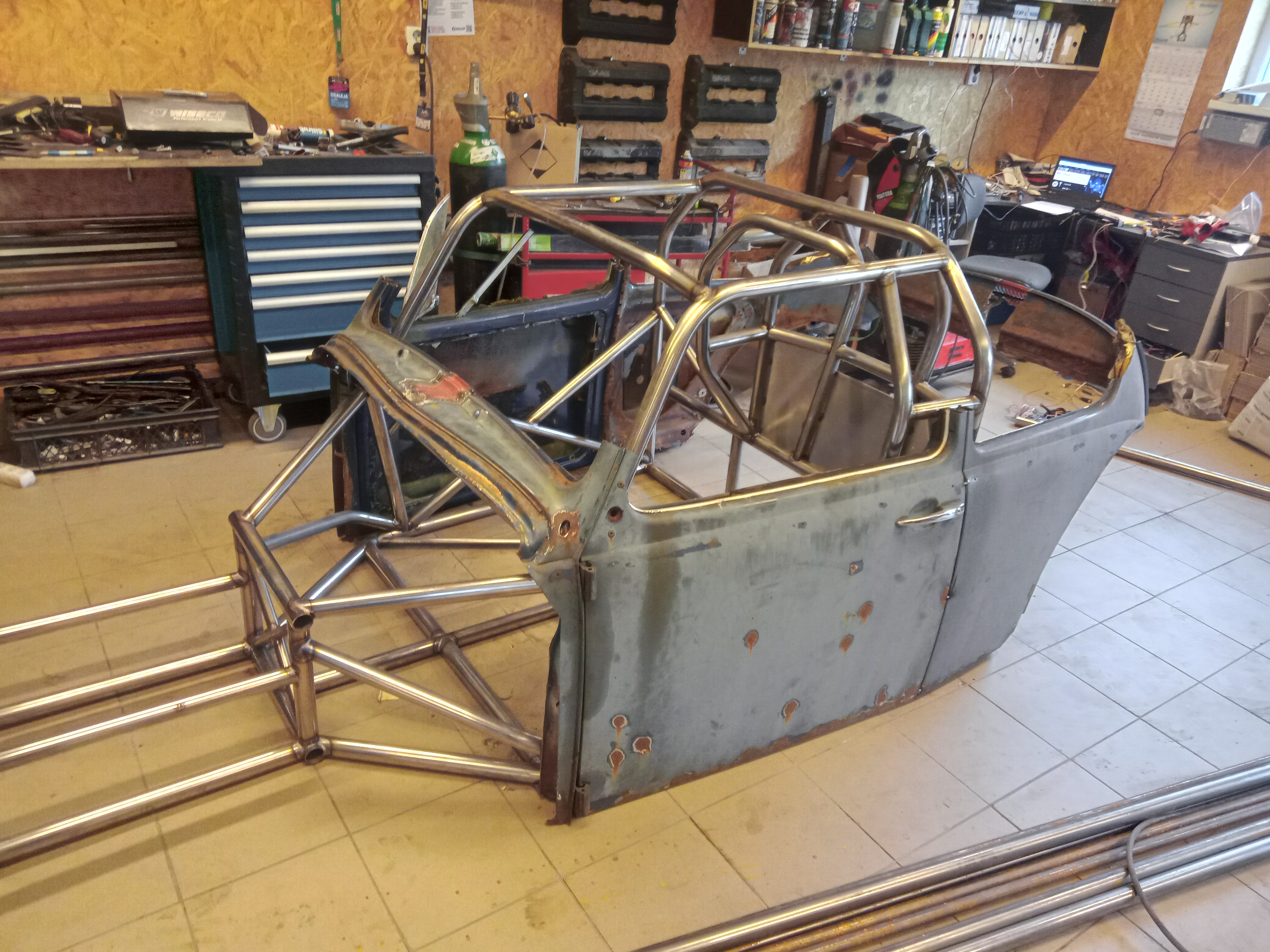

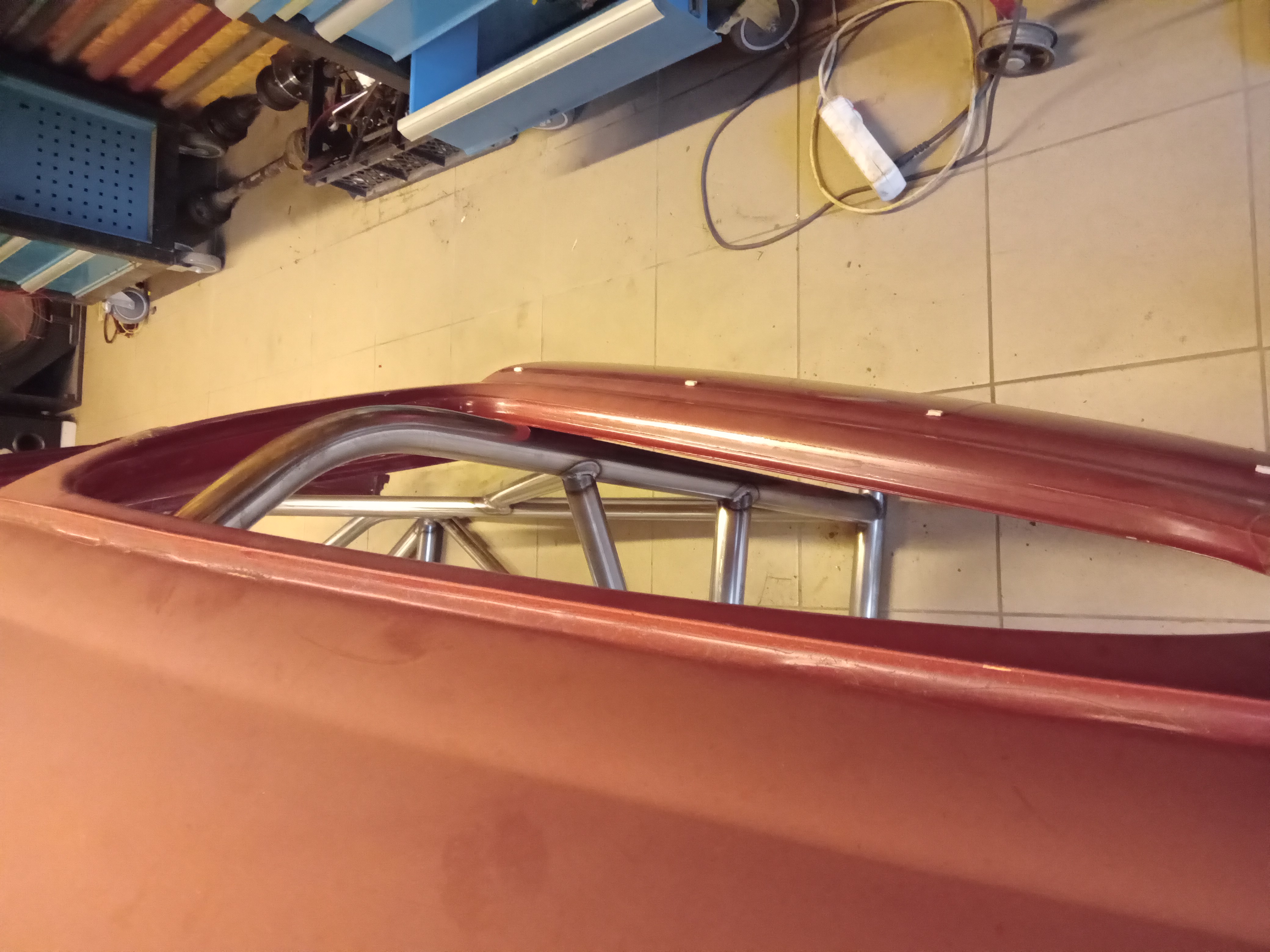

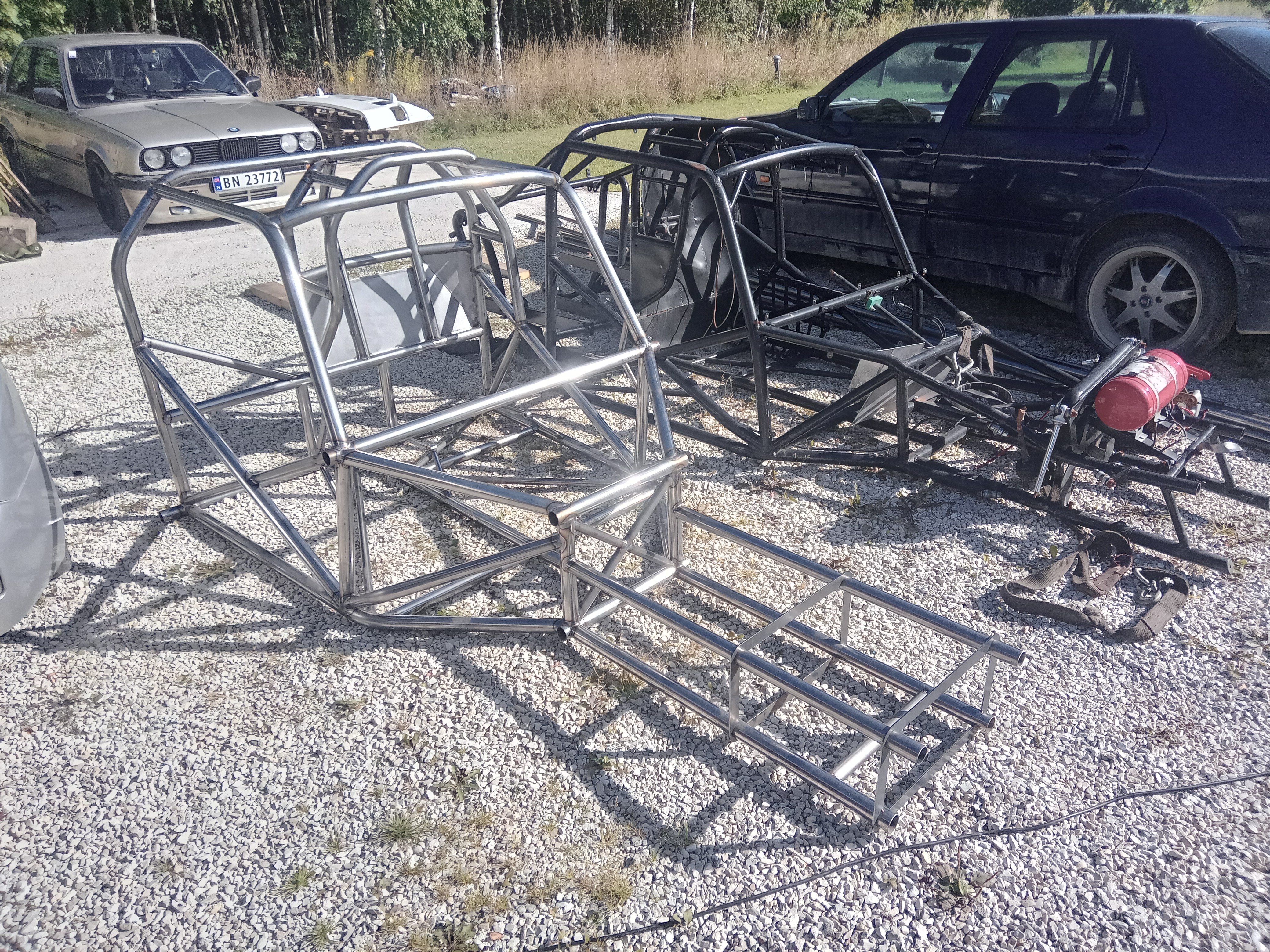

The moment I realized that something is really wrong and new frame is ALOT wider that beetle can fit :S Please don´t ask how but 15cm wider. I needed some doors and quick (To weld them in and cut body to half)
My friend ingmar had a doors for me:
But I loved that blue too much (I have had 10+ red cars)
I hope you forgive me for cutting these cars but they were at the end of their lives, no documents, no engines....sorry
Next time I quess I have to step back with that build and show some work we have done in computer with that project because metalworks are not going as fast as I would like.

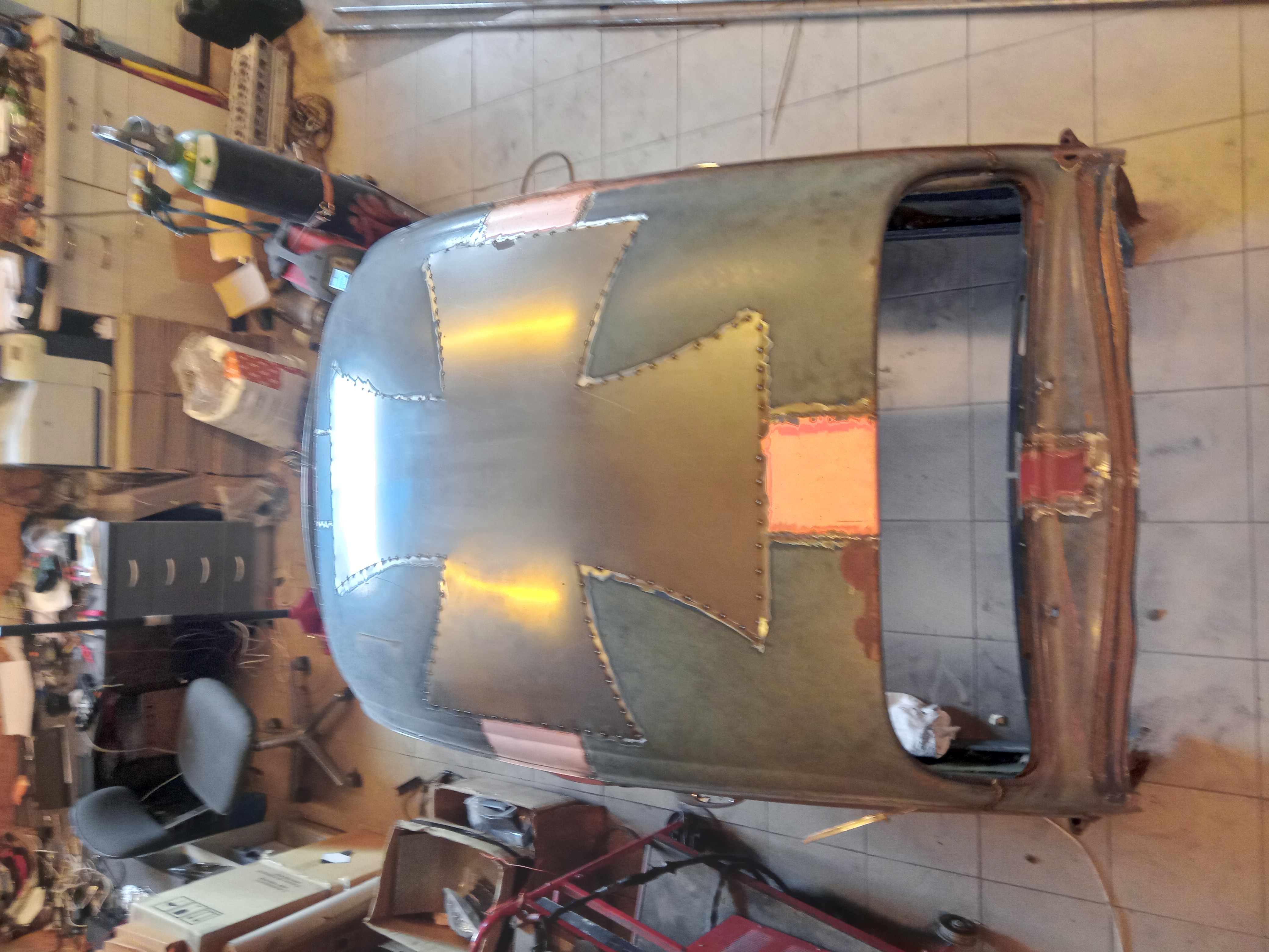

An impressive start!
I like the insignia in the top of the body which also acts as a doubler and spreads loads around.
The cage design is something I don't remember being seen before but looks to be very strong.

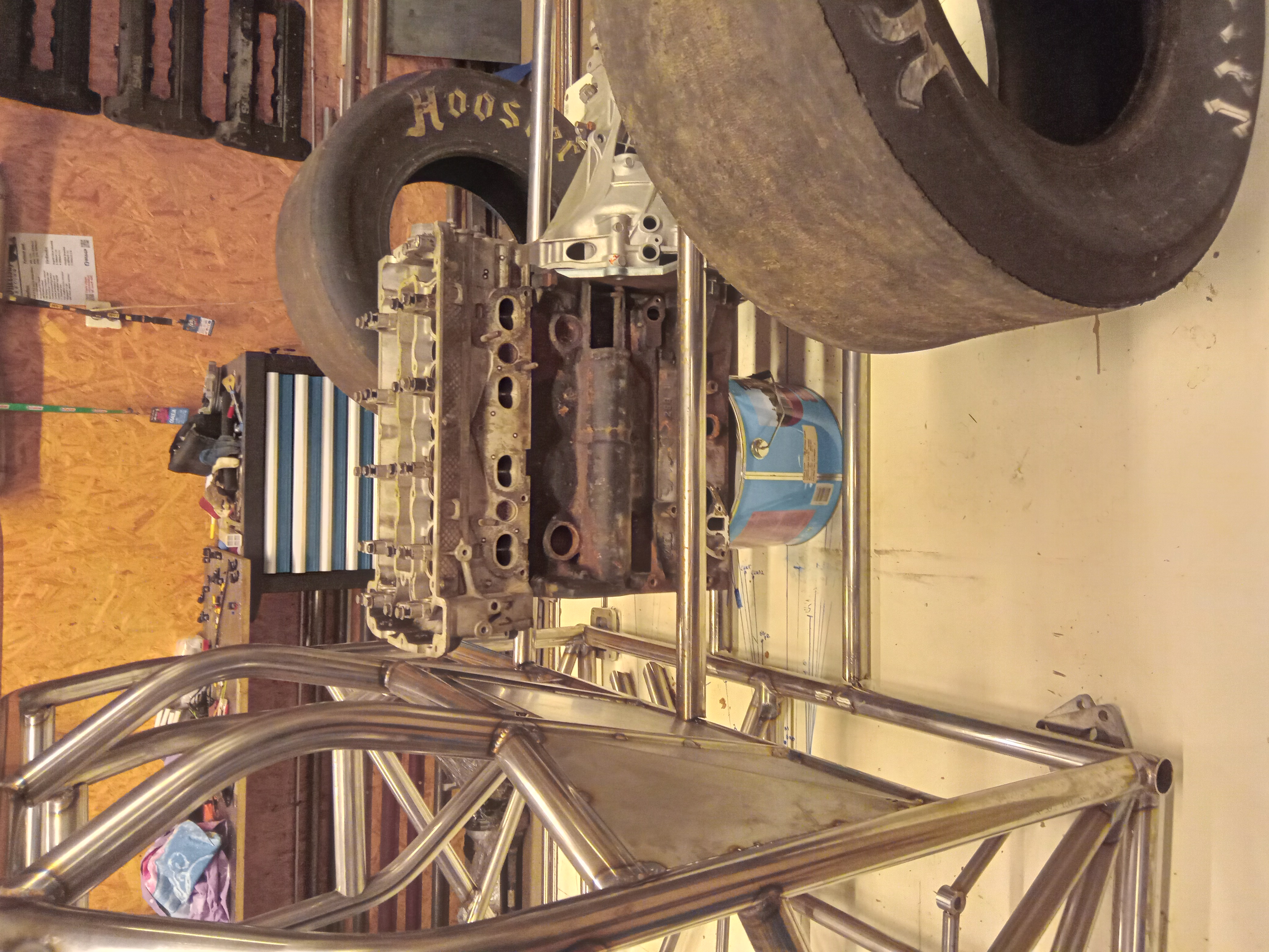

I have to explain this non traditional engine choice. My last car was with audi V8 and it was incredible engine but with some little problems. In midengine build it was too wide and added nonwanted width, I thaught it was too heavy (actually it was a lot lighter as I was thinking but that came out later) Main problem was that there were no parts available (pistons, rings, metal head gaskets, main bearings, rod bearings, head studs etc) so I had do use a lot of used stuff and just hope they are good enough. I pulled 600kw 1000NM from wheels quite easily (only rods were not stock) but I quess that stock parts limits were quite close and finding good shape engine case with OK bearings was harder as years ago when I started with that engine.
My new target for the new engine were: inline 4, cast iron engine case, turbo engine for good aftermarket part, cheap and a lot available, 2+ Liters of displacement for better spool with 1000hp turbos. And Saab was hitting all these points. it costs nothing, engine case looks really tough because it has 14mm between cylinder bores, all 2 and 2.3L engines are quite identical (same bore, same block, same head) and they are made 30+ years and tons of them available with really cheap.
So I bought my first engine and starter with measuring the weigh (it was 30+kg heavier as I thaught)

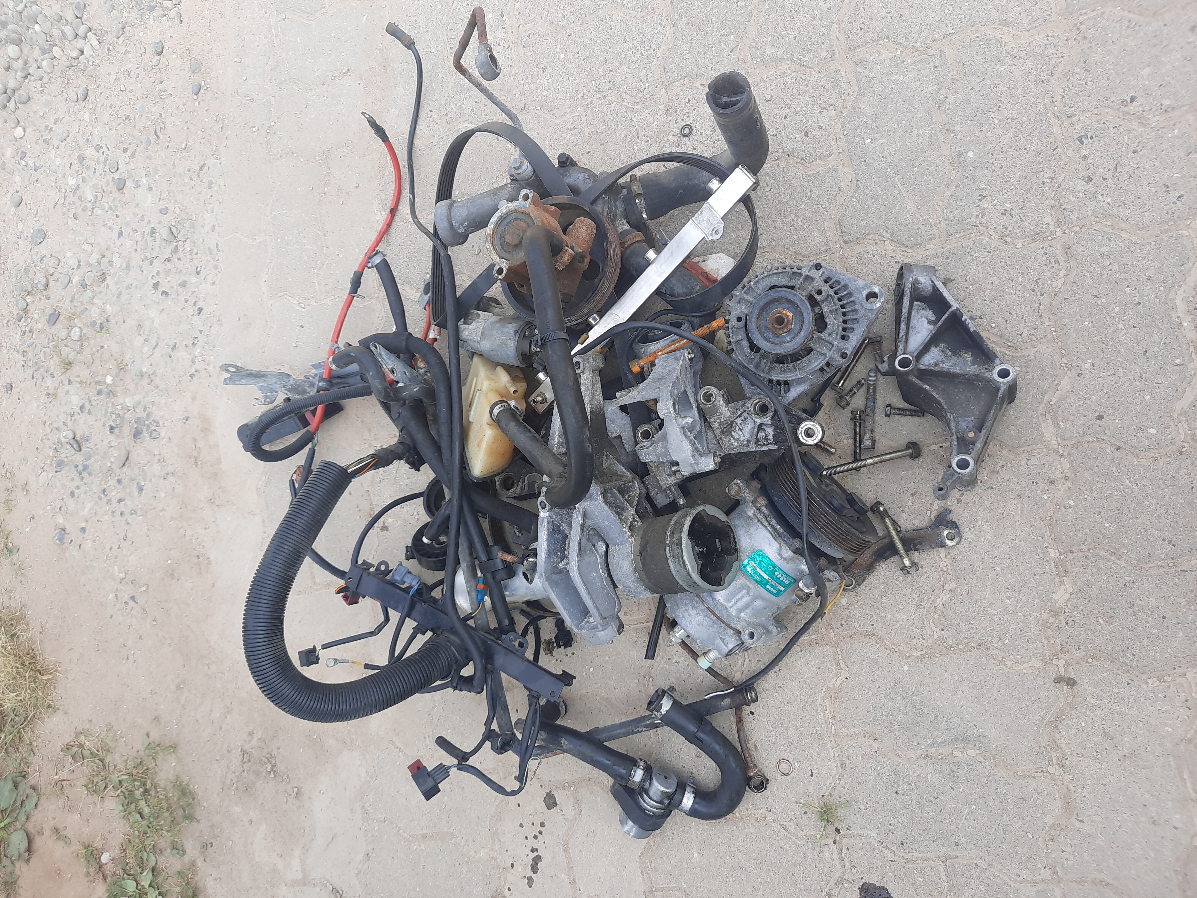

After removing some parts I dont need...
...it was looking a lot better (aroung 60 kg lighter than my aluminium v8 was)

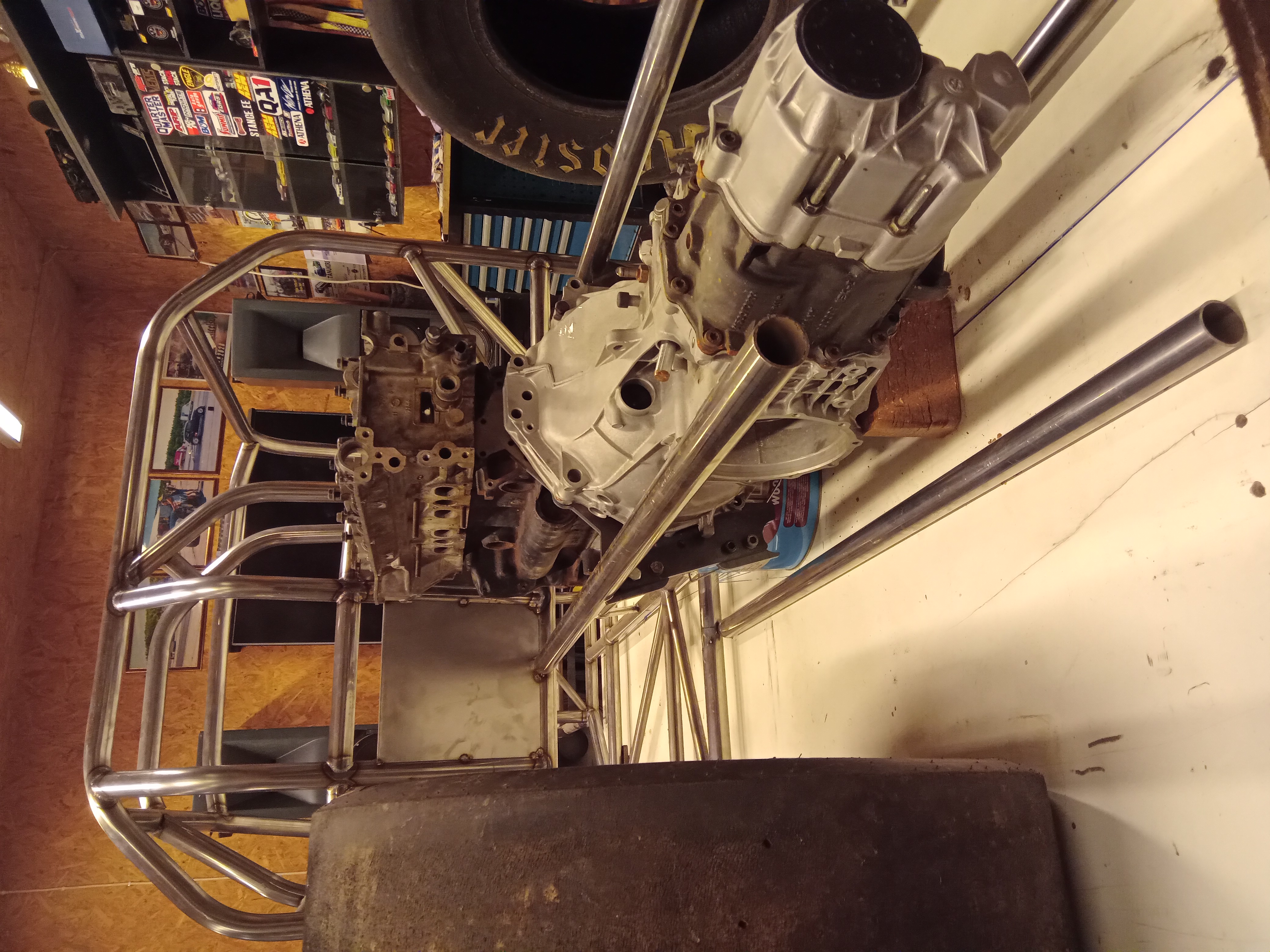

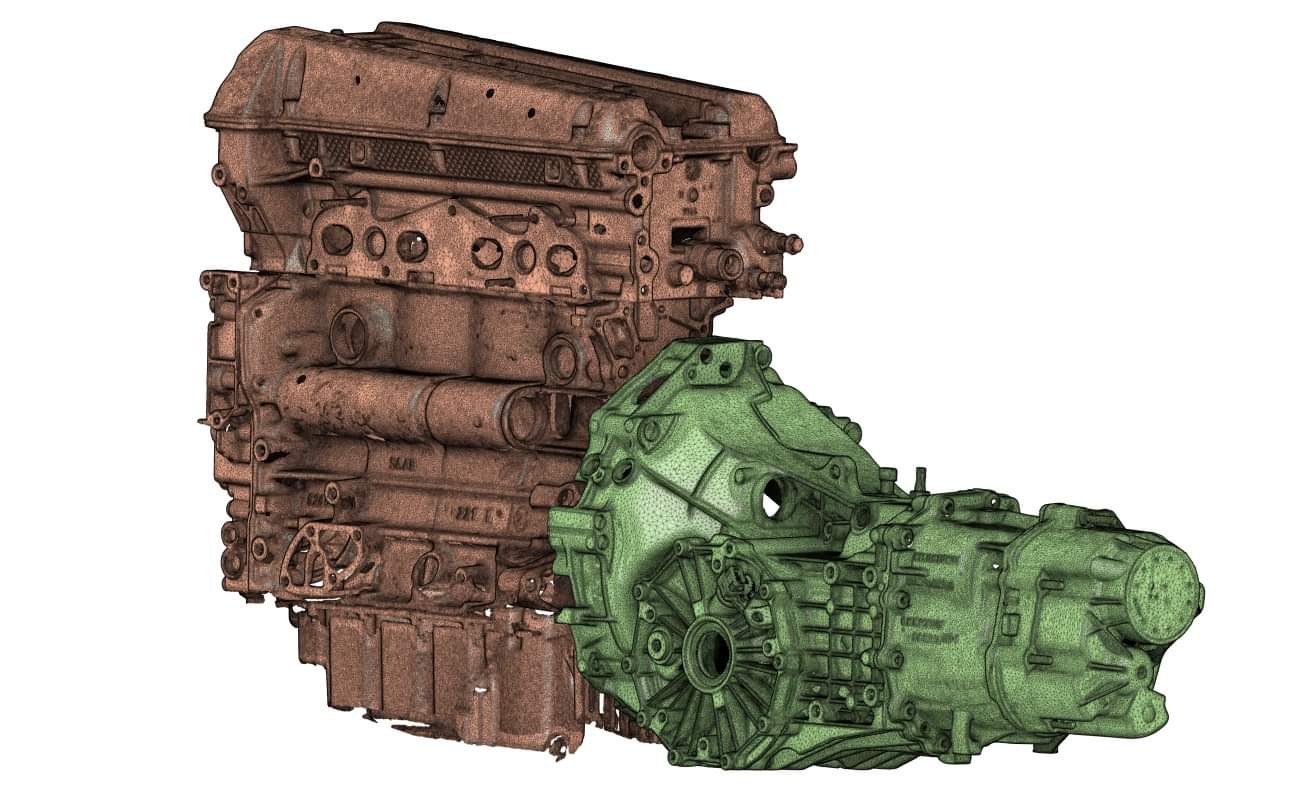

Then we had to started scanning parts to make adapter plate for SAAB engine and AUDI Trans.
This is the part we are actually working on and I hope I will get that in few weeks max.

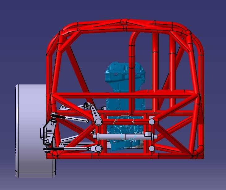

In computer they are already sitting next to each other

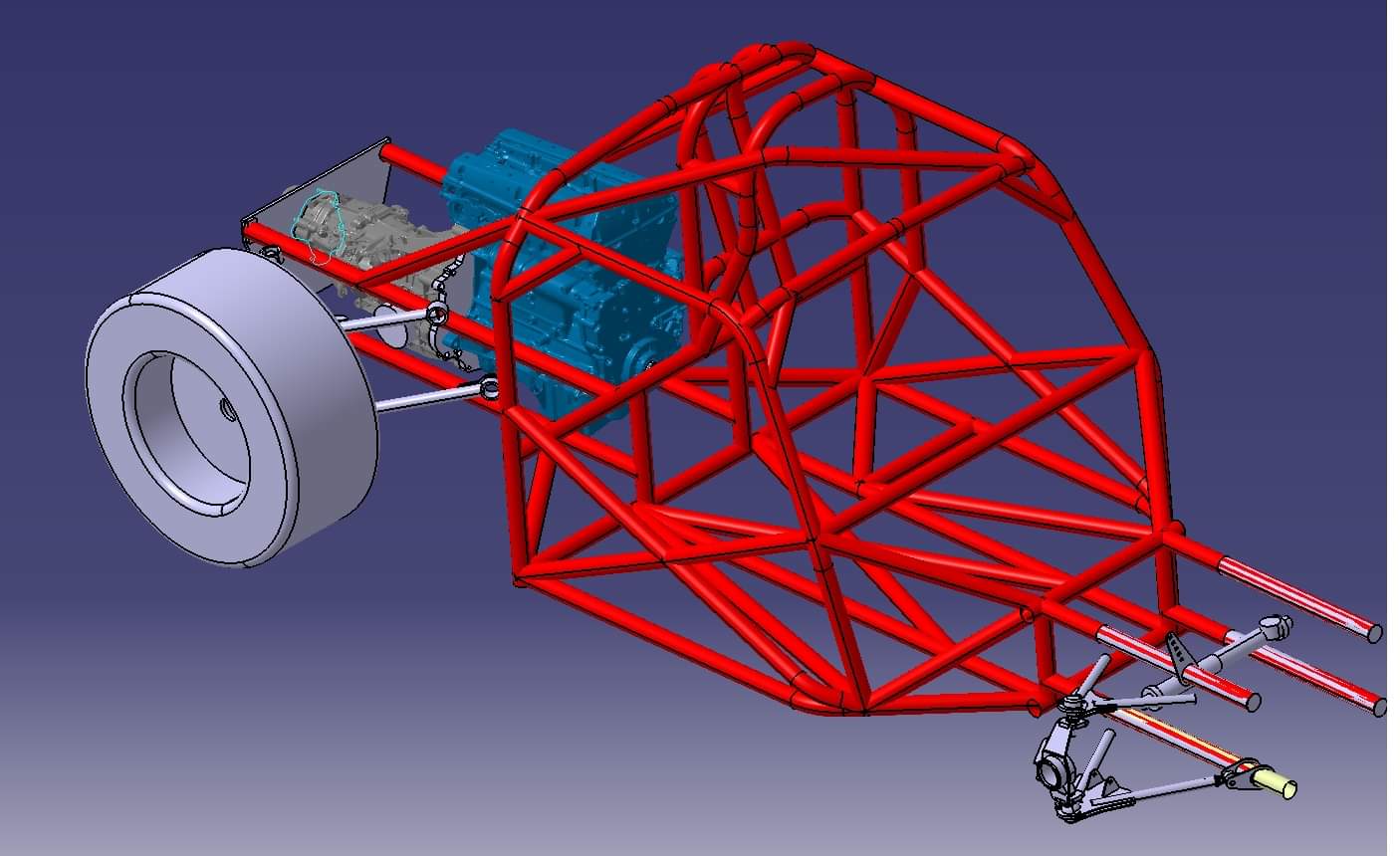

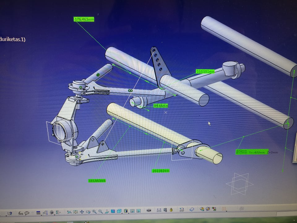

When my friend was calculating me a new front axle...
...we came to idea that maybe we add some pipes and we easier to imagine how it comes together.
...and it really helps to see tight spots we need to redeal
Now I have to start working to make some new content for that forum :D it really helps me because ads some pressure.
This all we do in computer helps to make changes I want, compared to my last frame. I wanted some more headroom because it broke my helmet when I crashed. I wanted safer seat with better angle, I want to make it 5cm shorter in front and add 7+ cm hehind my seat for better weight ratio. I really would like to know new ratio because it pulled to rear wheels even with 3rd gear with 37/63 ratio -50kg from engine should give me atleast 3% difference I quess, maybe I can start harder then. I really hope to get it from 1.36 to 1.2 @ 60ft. One old video when it had only 600 horses and I tried that is it possible to make it with second gear https://www.youtube.com/watch?v=7HxSvyq9zSo

When I retired CAD was still waiting for the necessary CAD program development of 6 axis milling machines... sounds like they may have made it :lol: .
Your designs look good/interesting, but some small angle joins could be added for handling stress and load transfer on the tubing. Like electricity, stress does not like 90° type of sharp corners when trying to move down the surfaces (inner and outer surfaces) of the tubing. An open-end angle joining the tubes (for welding) eases the load transfer directions for them.

Most of the frame comes from the rules but yes, there are some part what can be done several ways. I decided not change a lot because I see my 9x360 spins lived cage every day and just want that if needed, the new cage will be atleast same strong. (Crash video in first post)

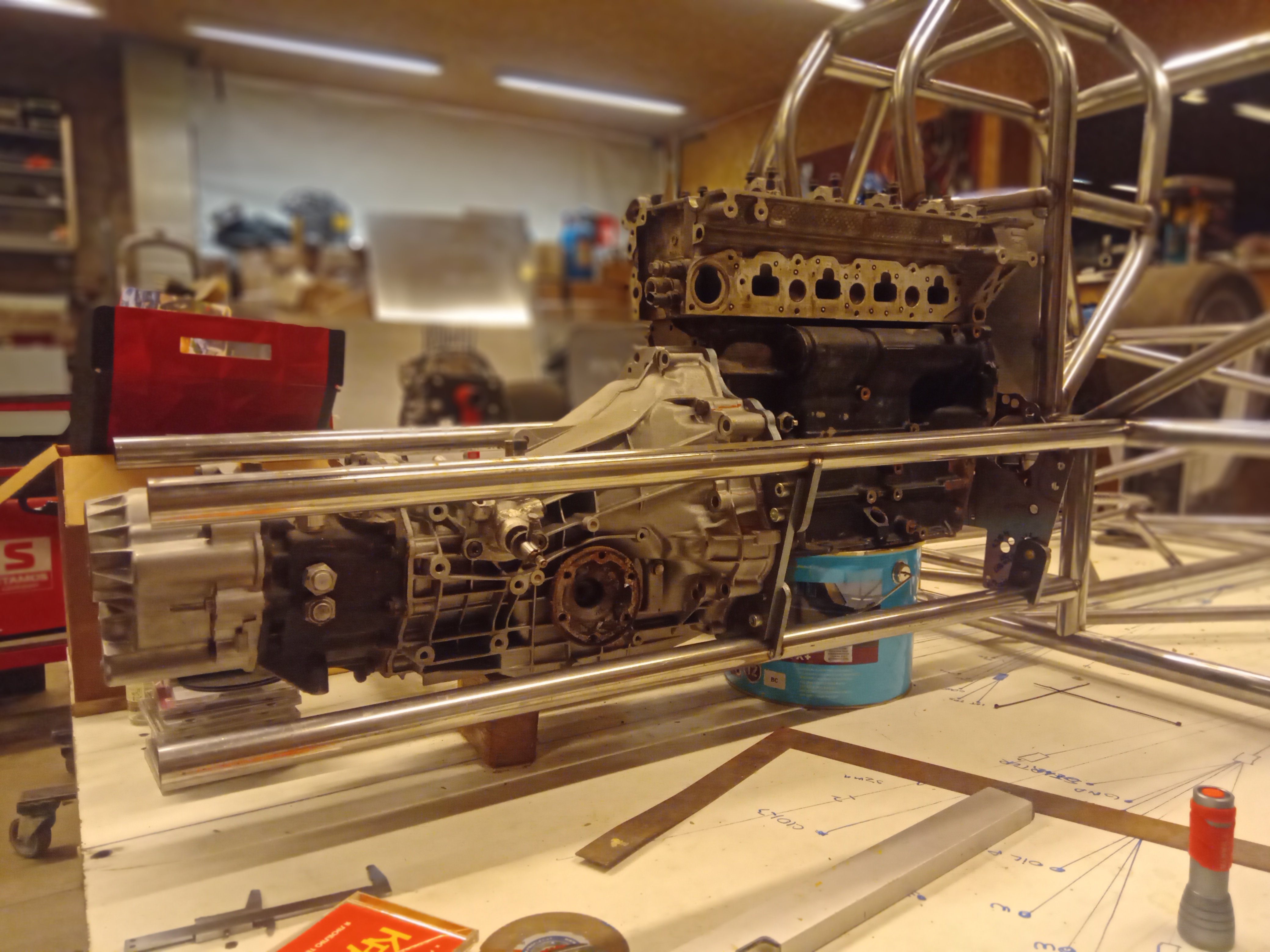

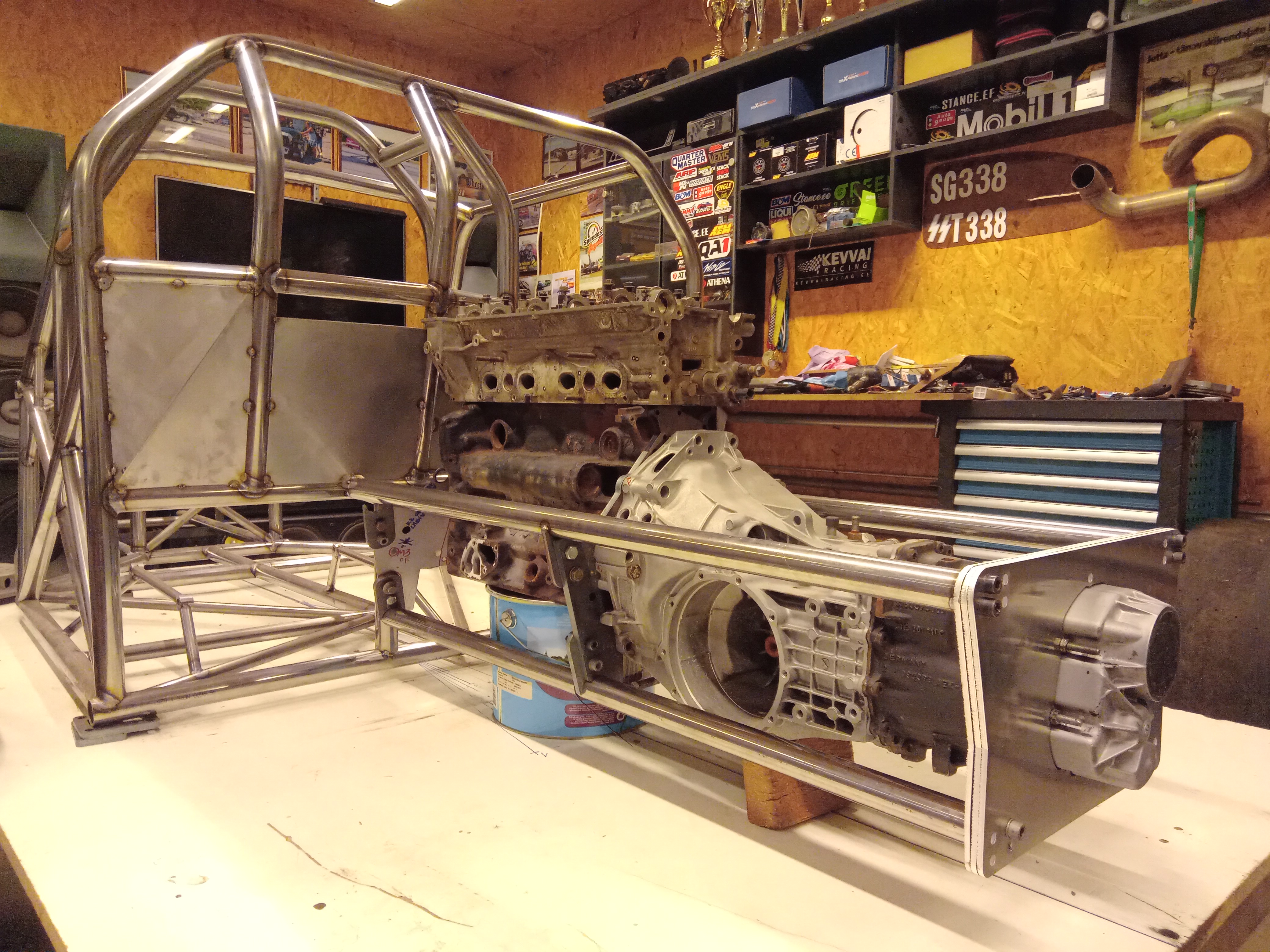

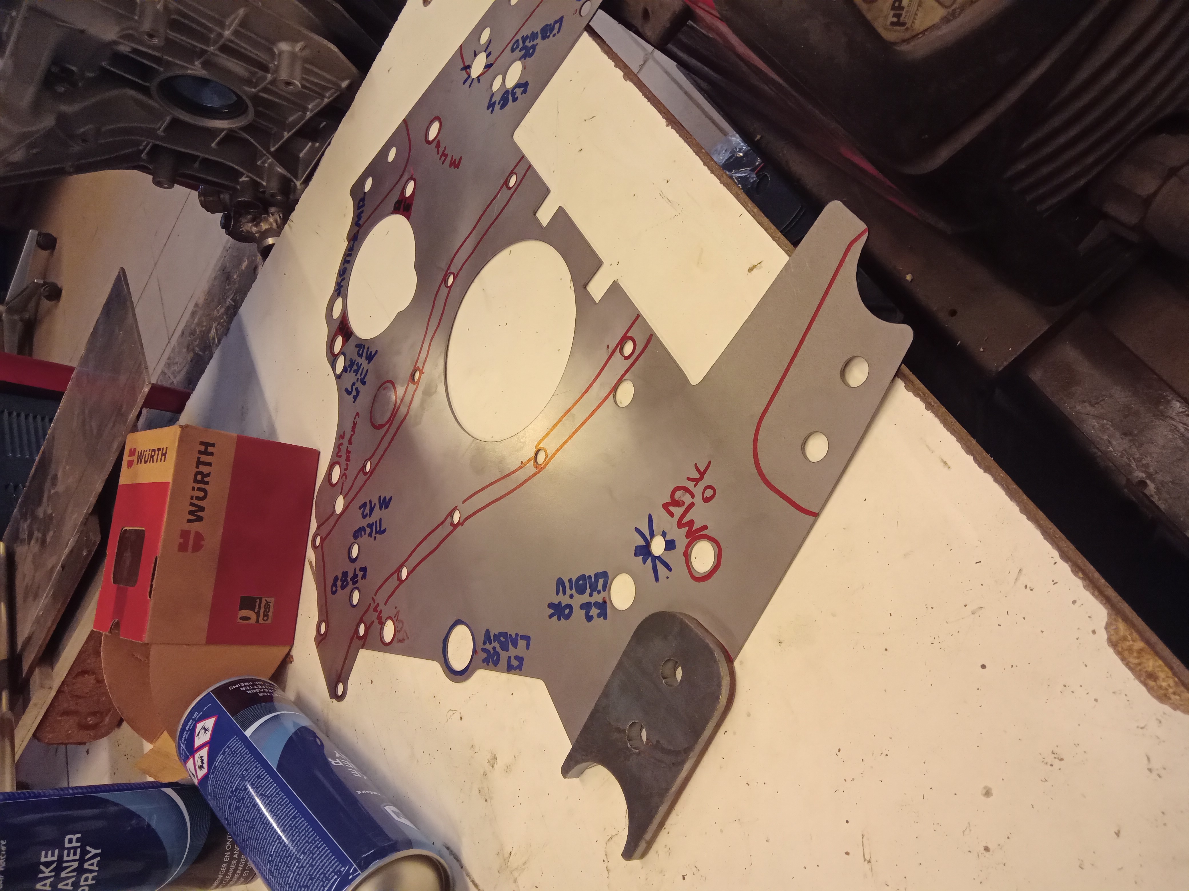

Some DXF files + lazer cutting and now the positon of engine and trans is fixed. And I have to wait for rear axle parts to see where I can add some tubes and just weld it all together. Pics should be easy to understand, so I don´t make long comments :)
Just for testing, I cutted 1mm thick middleplate between engine and trans. It was good idea because we need to change some things.
