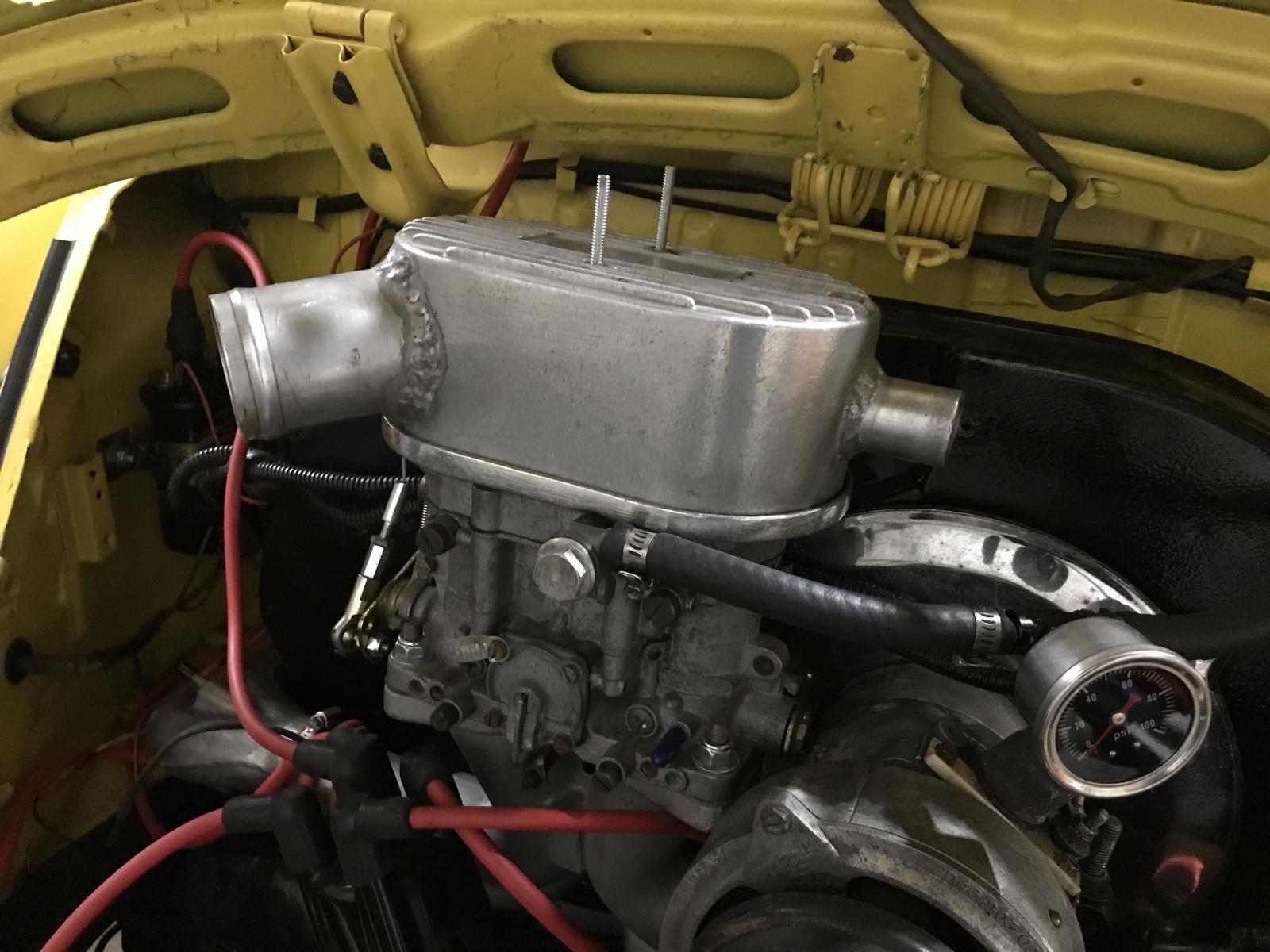

Got this turbo hat in the mail today. I already had a new one with no holes in it. No I don’t have to find someone to weld the pipes on. Win, win, I hope.
buguy
Posts: 6180
Re: Another blow thru 1600 build
Post by buguy » Thu May 26, 2022 2:07 pm
Nice! Your getting close!
