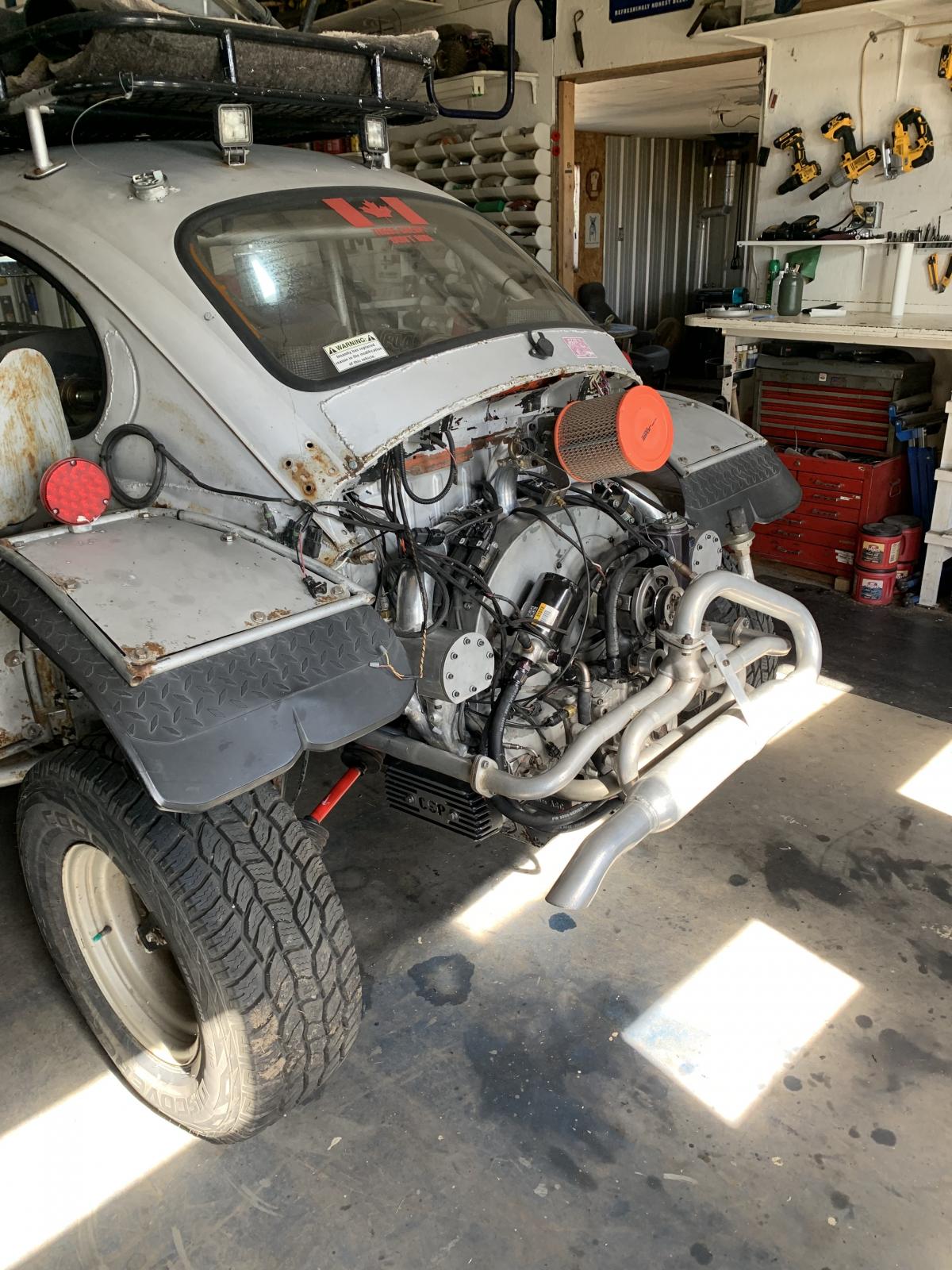

Progress is slowly coming together. Have the motor all freshened up replaced pistons and cylinders with JE forged set, replaced heads with SL1 racing Turbo prepped heads. Made some plenums and rearranged the intake plumbing to get rid of several coupler's, plugged holes in shroud and bolted on a better formula V mini sump found a 50 mm ford throttle body I am sort of digging this arrangement
I then packed it all up and took it to the car
made a clutch torque measuring tool sealed and pressure tested from the throttle body to the plenums and bottom of intake manifolds as a assembled unit. I stopped raising the pressure at about 70 lbs with no leaks haha. Bolted it all together and stuck it in the car. Made a throttle cable and tried to wire the TPS. I could not get it to make sense or jive. I suspect I may have damaged it while playing with it when I first got it
put the old exhaust on and found a cheapo filter for the TB, made a PVC pressure oilier and filled it with 5 liters of GP1 break in oil through the pump side of the oil filter. Fired it up for a couple seconds with out the TPS sensor and the old tune with new injector size and took a data log which I have yet to look at. Hit the mens mall on the way home from the farm and located another TPS sensor off a 99 Ford Sable. The plan is to seat the rings in naturally aspirated then add the Turbo and intercooler
AND THAT IS WHERE WE ARE AT Getting closer
Thanks for all the inspiration and advice you guys are great I love this place
PSAny one know the pin out for a Ford TPS sensor off hand it is from a 99 sable I think
