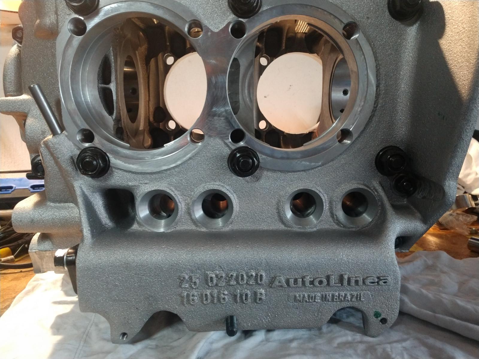

So i think this one is going to be a 2176. I picked up a new 78.4mm CB crank from a guy at a show a couple months back for $200. Couldn't pass it up. Grabbed a new aluminum case and a set of those fancy light 94mm drag race JE pistons and AA cylinders on the AA black Friday sale. Also got new bearings and a few other misc parts for the new engine. I haven't worked out the details on it yet, but i think I'm going to make a high rev engine this time. I also ordered some CB 5.6 VW H-beam rods so it should make some pretty good power. I'm going to call and talk to Pat D more about it, but it will probably get CNC wedge ports or maybe super pros. Undecided on those and cam until i make a decision on the rpm. I'd kind of like to make it an 8500 rpm screamer just because it would make nutso power and I've never had an engine like that, but also, not ideal for the area i drive. Most likely will pick up a new BW turbo for it too. It will have to get/make a new header and maybe go to a 2.5" intake instead of a 2". I should have a fuel system that is already up to the task. There is a chance i will hit more in the middle, like maybe 3500-7000 rpm... Just have to see what i come up with. This will be a slow build since i only have 15 miles on the last engine i built.
I thought I'd put it up here to get some thoughts and ideas.... And of course to document it for later reference.

Nice parts, sweet pistons, crankcase seems to have change a bit in the casting since mine...
is it normal that there is no case saver?

The case came with 8mm case savers and 10mm case savers that the user has to install. It also has all 6 shuffle pins.
