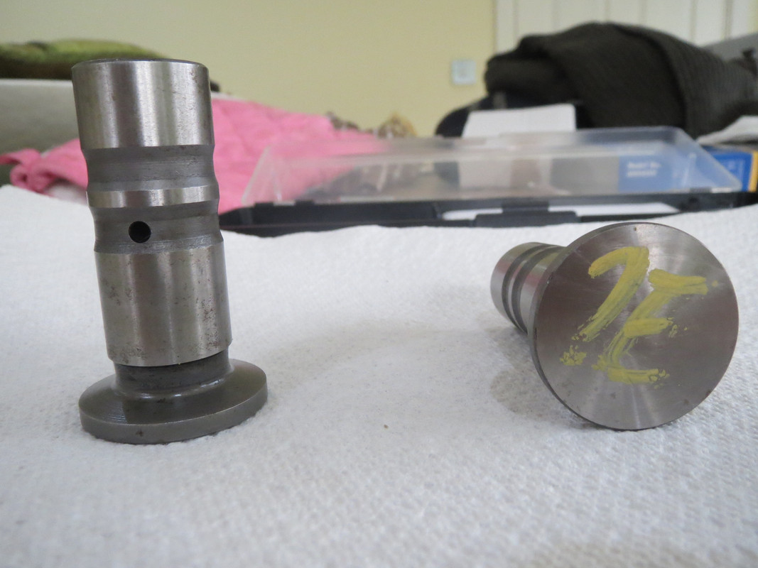

See if this works, not posted a photo on here for a while lol
The original VW lifters I have seem to have feet about 5mm thick, these are tapered, about 3.5mm on the edge and about 4.75mm by the upright
Cheers Rob

Stock lifters are 82g. Scat "Lightweight" lifters are 94g. That is why I call them Scat heavyweight lifters.
