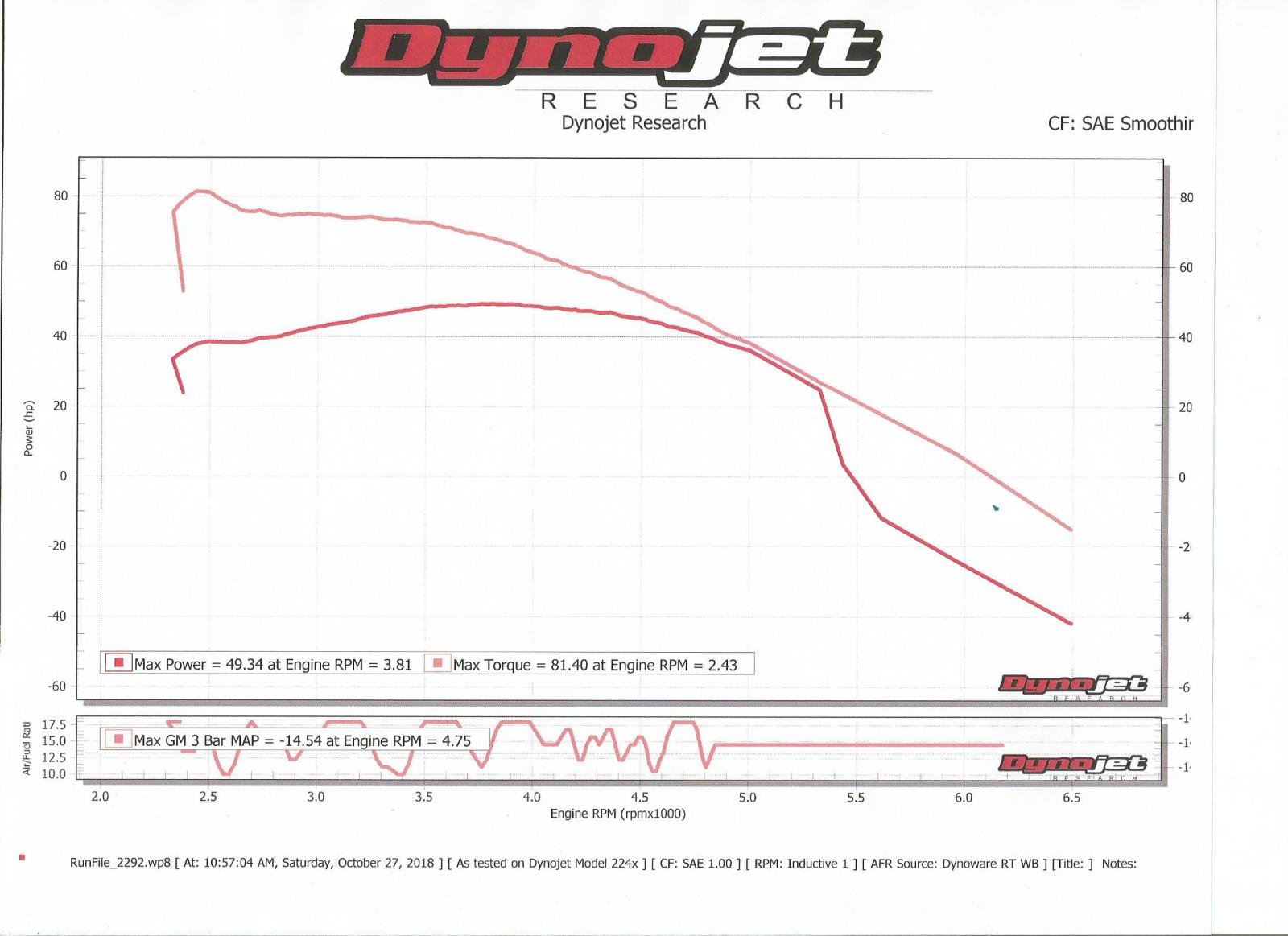

After almost three years of working on my 68 Sedan, i finally got it on the dyno. I had a turbo on the car but removed it. I wasn't happy with the way it was setup. Figured before I reinstall the turbo i would get an all-motor baseline. Engine is a 1600cc DP with stock cam and 043 Mexican small valve heads. Using Megasquirt 2 to run a home brewed EFI system.
Here's a short vid of the action. Enjoy!

Nice! What is your hp goal with that when boosted

I'd like to get to triple digits. Maybe 100-110hp. My injectors will probably max at 120hp. I'm not trying to be competitive, just a fun street car.
