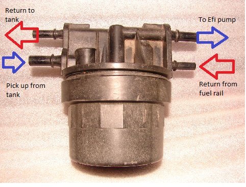

Piledriver wrote:NO.
Also trying to pick one of these up from a place called BC Broncos. But they are closed today will have to call on Monday. http://www.bcbroncos.com/store/product_ ... cts_id=119
It's a 1 quart fuel accumulator/filter. should work good in the rough
NONONOnononononono. No.
It doesn't really look like its actually even drilled for 4 fittings, it should be if done right.
PLEASE realize you can duplicate that $73 (ridiculous) fuel sump setup for about $20, or ~free if you are a packrat like many of us.
(I don't know how those folks face themselves in a mirror)
It's a simple generic remote oil filter mount with a pair of extra fittings drilled/tapped for the feeder pump and return.
The filter mounts cost about $10 + 4 brass fittings...
The airtex pump is a generic pump for a mid 90s Ford.
Not a bad choice, but check the part# and shop around.
He guys I realize i am late to the party but Ford used a nice little return line fuel res. on the mid to late 80 pickup and vans and can usally be picked up for around $15 or $20 at a junk yard
Have been running on on my 5.0 EFI swap in the PYl for years now works great

Nice find 5.0 Chero ! Might be a little late as I picked up a remote oil cooler adapter {$17} and hardware store fittings {$10} this past week Dilled ,tapped and assembled on weekend {15min} looks good now just need to find appropriate size fuel filter. ThanksPiledriver :D Going to stop by pick a part yard and have a look at that reservoir though. Thanks for the heads up. Should receive a Stepper motor and distribution block from CB performance tomorrow. Then I can pass along its connections to Mario so he can finish up wiring harness. Will order 4X EGT and CHT sensors from him on Friday. That should leave me with 2 MAP sensors , 4X LC2 wide band sensors and some fuel line and fittings away from a complete EFI set up 8) Can't wait to dig in!!! When Mario's order comes in I can see what will be needed for fuel lines. Oh yea will also need 3 relays and a fuse block. Coming along nicely I think

Posts: 22760
Re: Help me decide on EFI for Frankin bug [hello Mario]
That nice Ford bit looks to take quick disconnects, they can be had in pairs at most parts stores for ~$7.
They have barbs on the other end.
The GM ethanol sensors take the same fittings.
MarioVelotta
Posts: 4086
Post by MarioVelotta »
Here you go Terry :mrgreen:

5.0 Chero
Posts: 74
Joined: Sat Jun 20, 2015 7:47 am
Post by 5.0 Chero »
Piledriver wrote:That nice Ford bit looks to take quick disconnects, they can be had in pairs at most parts stores for ~$7.
Yes you are correct I was able to plumb my EFI fuel system for my Chero from the wreaking yard for about $20 of course this was back in 2002 but I am still running the same junkyard lines without any issues and it is my daily driver. I also used an external EFI pump and filter from a Ford pickup Ford used a Bosch pump from the factory and I just run junk yard ones. From 2002 to 2006 I went through about 6 or 7 pumps. After I found the res. and installed it 2006 I have used 2, no more cavitation or fuel starvation to heat up the pump
