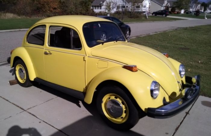

Im new to the forum and pretty much new to VWs. Been around hot rods and drag racing for a long time but never really VWs. Ive taken possession of this 74 standard that was my grandpas. 59k original miles and in really good shape. He bought it in San Diego in 1990 and its sat in his garage ever since. My dad says its been driven maybe a few hundred miles total since 1990.
The yellow is actually a lot brighter than the pic seems.
It didn't run, had a lot of light issues and zero brakes. The entire brake system seems to have evacuated all its fluid over the years. MC reservoir is bone dry. I have it running pretty good now and all the lighting issues fixed. Now its on to the brakes.

Welcome to STF. You have great looking start there.

Welcome to the club!! 8)
Nice ride.
