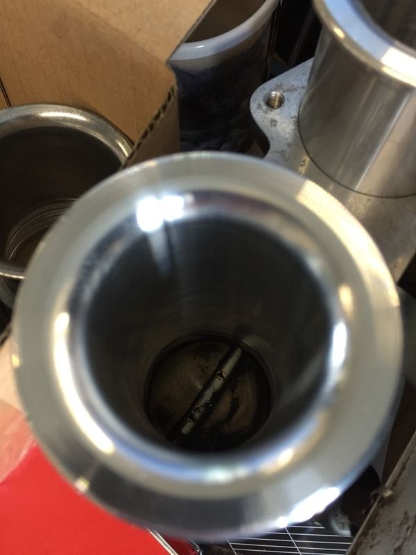

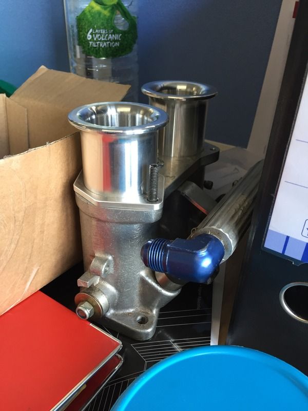

I had these made up.
I've got a set a 36mm and a set at 40mm
Just need to weld the mounting tabs on.
I can get a set made for you if needed but they are not cheap at a one off but still cheaper than a new set of throttle body's

Now that is a slick solution!! Way to think out of the box!!
How are they working out for you??
- Posts: 14
- Joined: Thu Feb 14, 2008 1:52 pm
Re: Where to get venturis for CB's 48 mm throttle bodies >?
Thanks Nate
They are running smooth and pull really well.
I was worries about the step back to the 48mm valve but it runs fine with no hesitations.
I was thinking of changing the valve to the 40mm and just sleeve it straight through but i was worried about the valve catching.
Nic
