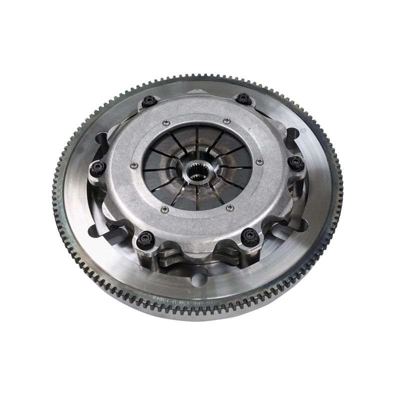

Rev-6 twin disc clutch from Ron Lummus!

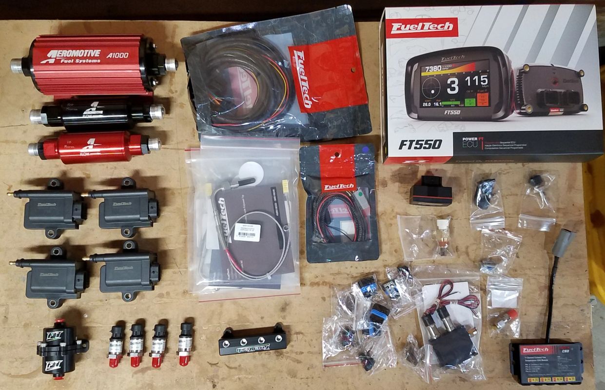

...and I realized that I didn't show a pic of a lot of the new engine management stuff...
