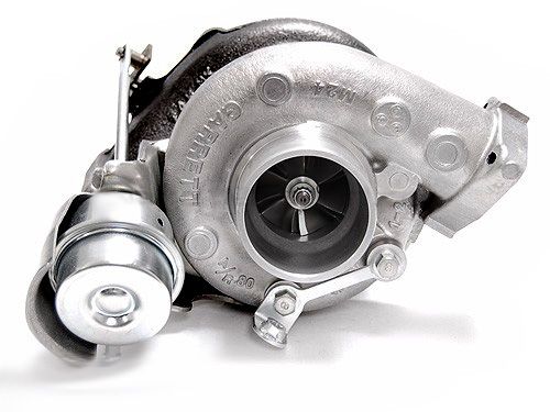

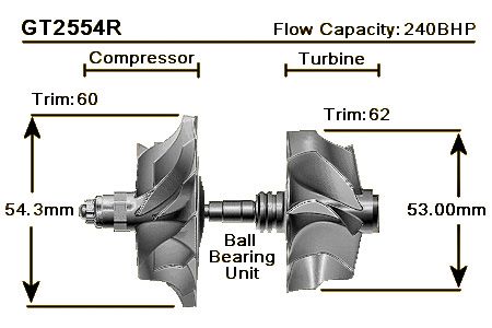

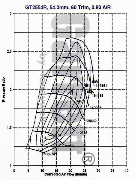

I quite like the look of the GT2554R (BB turbo) which is currently on sale at one of the UK distributors for only £60 more than the journal bearing GT2056. (Both a similar size)
I have been advised in the past to get a T3 turbo but have read on other forums to go with the GT series of turbos as their design is far more efficient than the older T series.
My car is mainly used on the street so I'm after a quick spooling setup, ideally with a nice flat torque curve which starts at low rpm, without sacrificing too much top end power.
Before I go spending my hard earned cash I wanted to know if you guys think the above turbo would give me what I'm looking for or whether I should consider something else?
Thanks in advance for any feedback. :)
