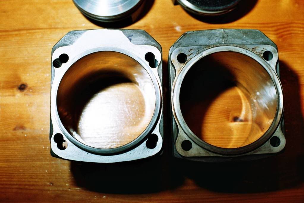

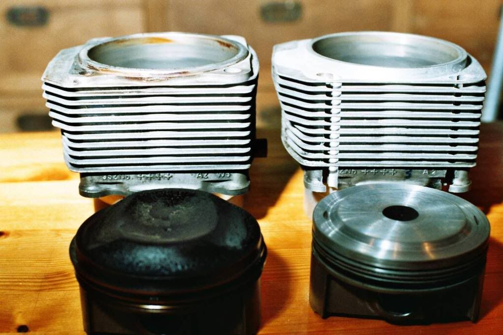

Hi Frallan, just reference at the moment. I've always had this thread at the back of my mind all these years and I've finally picked up a set of 964/100mm pistons and barrels cheap on ebay.
My main question at the moment is the depth of the sealing surface at the top of the barrels is very shallow. I guess it just gets the recess machined a bit deeper down into the barrel. Any pics you might have will be useful. :)

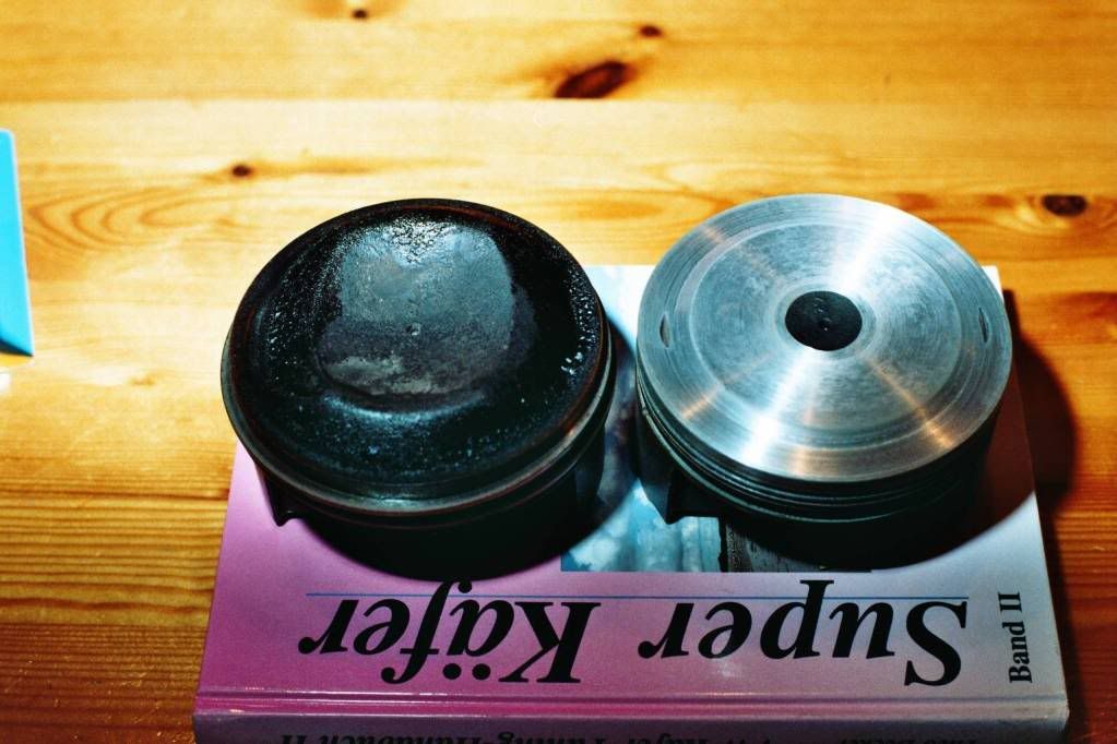

I remember the pic of the top of the piston being machined down but that's about it.

Actually, that IS about that... just do it and keep the sealing surface at the original 6,5mm wall thickness, which means about cutting into the heads about the same opening as for 103 barrels. That will enhance heat transfer from the heads to the barrels :wink:

Something like this?

Wow! Thanks Frallan! You star! :D
