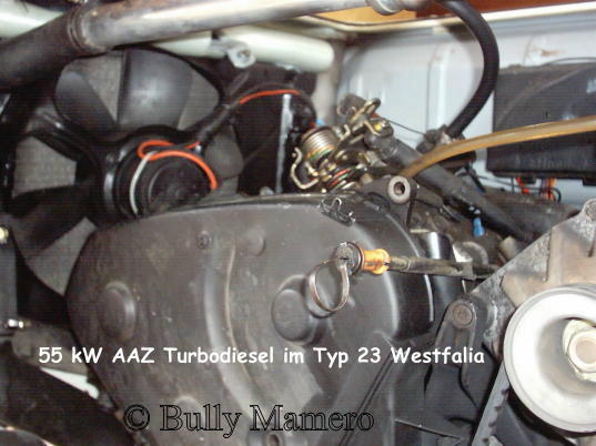

is it just me or does putting the rad on/in the rear deck create a bunch of access problems?
Seems like there are better places to put it. e.g.
See http://www.birkmamero.de/news.htm for description (in German)
