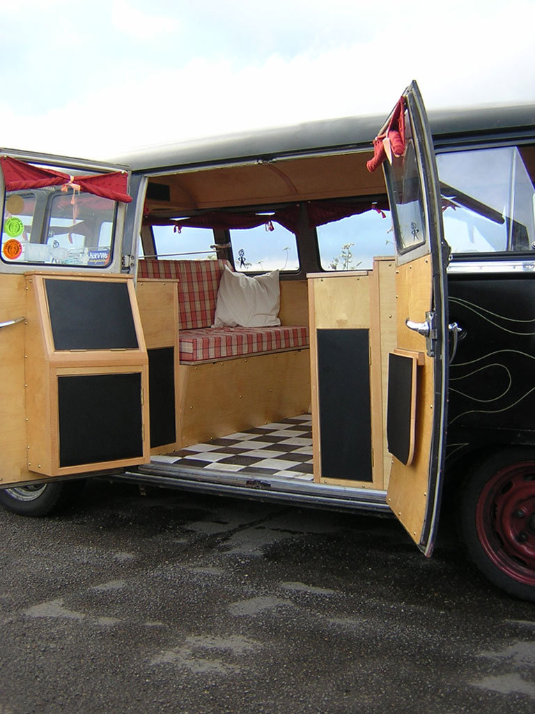

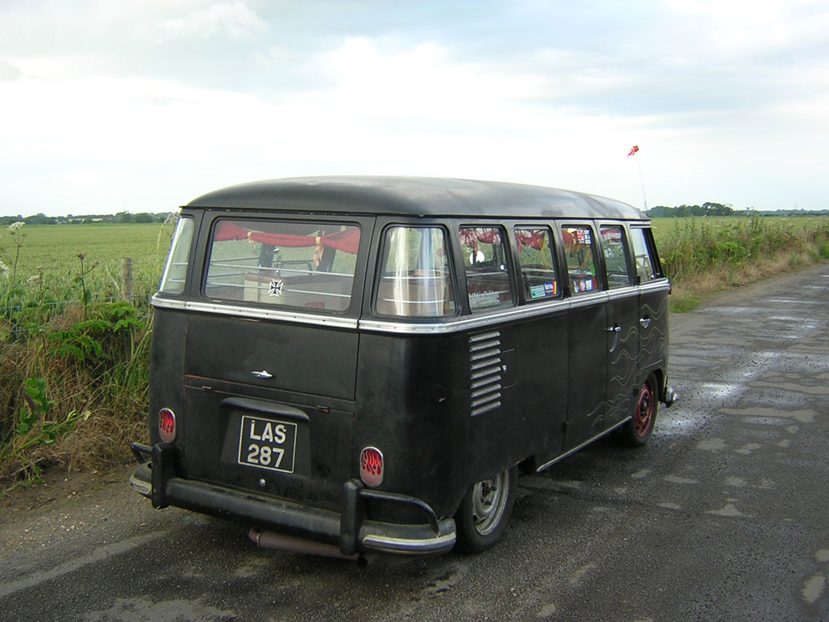

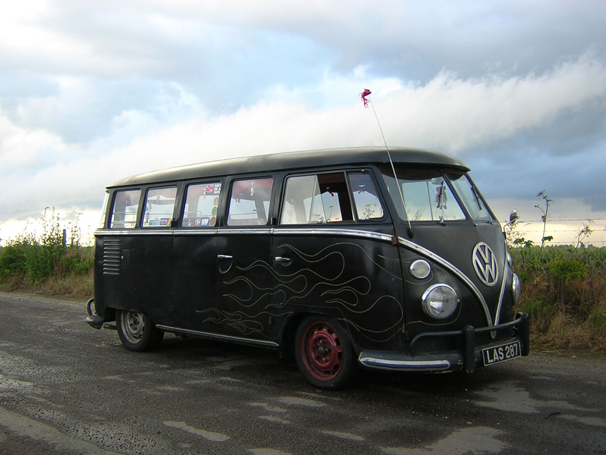

A couple of pics.As you can see originality is not an issue.
