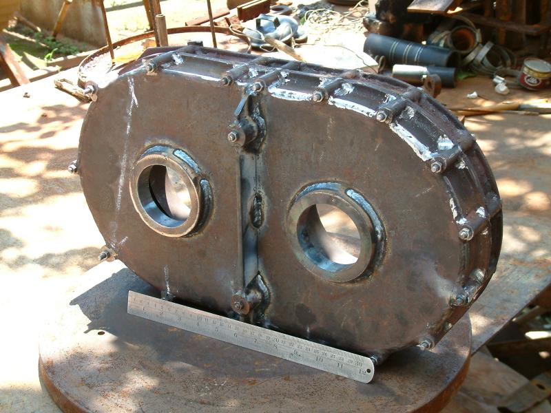

This is the back of the case (the side you would see with the decklid open).

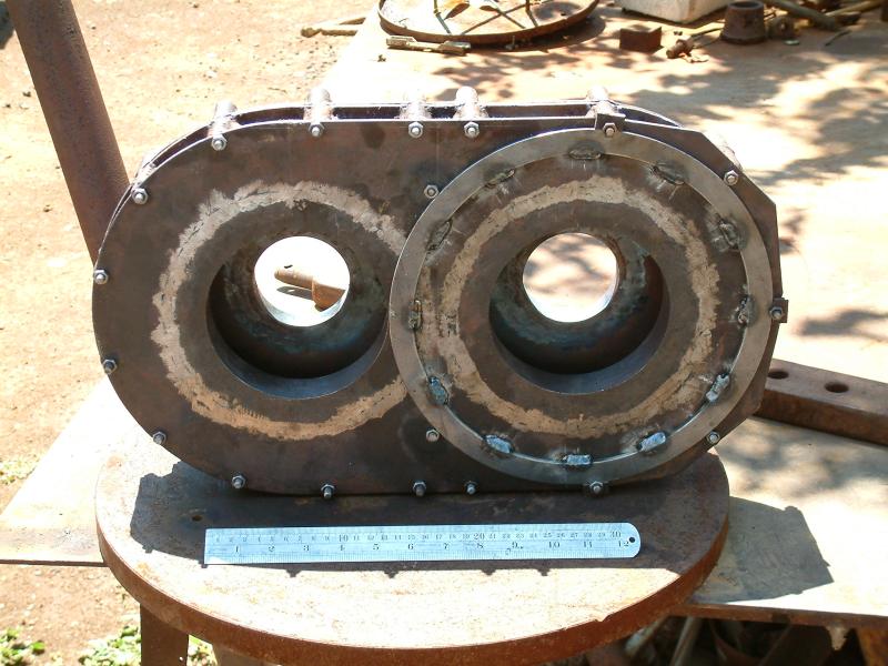

An angled shot of the case from the back.
The front of the case. (part that the engine and gearbox bolt onto) The left of the box is the top and the right is the bottom of the box. The large ring is for locating the tranfer box onto the gearbox. It still has to be machined down to size.

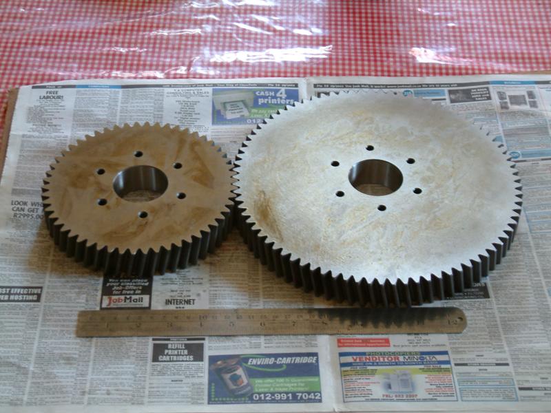

Here are the monster gears. They are over designed and heavy so I may try to lighten them if they cause any rotating mass hassles. They are made of EN 36B and are case hardened and have a ground finish. The distance between centers is 211.36 mm (8.32 inches) and the ratio is 1:1.5 which will give me a 120 km/h (75 MPH) cruising speed at 2600 RPM.
The transfer box consists of 95 pieces of steel that have been cold forged and welded together. It's a collection of angled steel, flat plates and round bar. It weighs 21 kg (46 lbs) without the internals! Yes very heavy but it WILL NOT break when I supercharge the engine up to 400 Nm (295 lbf feet) of torque.
