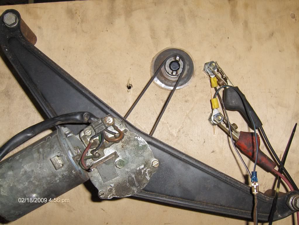

David.. is this your test board?
Posts: 14100
Yes it is. I did a little modification to it. I used a VW wiper motor to turn the Dist. Still waiting on an aolog volt meter from Radio Shack I ordered that hasn't came in yet. :evil: I used a dirt devil vacuum cleaner belt. :lol:
