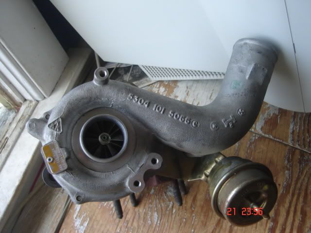

Here's the compressor pic, try not to use plastic t's, I went through a 3 pack of them getting it to work. You could always drill a hole in the same spot on the compressor outlet and tap it yourself, but there should be a blank raised spot to drill. Some guy wanted $50 for that little boost fitting used and you can guess what I told him to do with it. I taped it and got one for $1.00 at auto zone.

Post by blacktruck »
sweet
that little nubbin at about twelve oclock seems likely but its awfully small
what about the spot where the tag is riveted?

Post by jweir »
That little nubbin is it. Mine was that same size before I drilled it out and tapped it, it was a tiny hole. these turbos aren't good for over 12psi, so that little hole should be fine. I tried forever to find a fitting that would keep me from tapping it, but my patience ran out. I see you have 4 bolts on your exhaust intake, what car did it come out of? I hope you have an easier time with the flanges and gaskets than I did. I also had to rotate the housing to get the oil drain in the right position.
