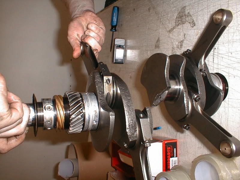

One of my mates just stripped down his 2332cc motor to see what suddenly caused a nasty metallic bottom end knock after 15 thousand miles of road (never been on a strip) use and found this. :shock:
Its a CB Performance 84mm forged chromoly crank.

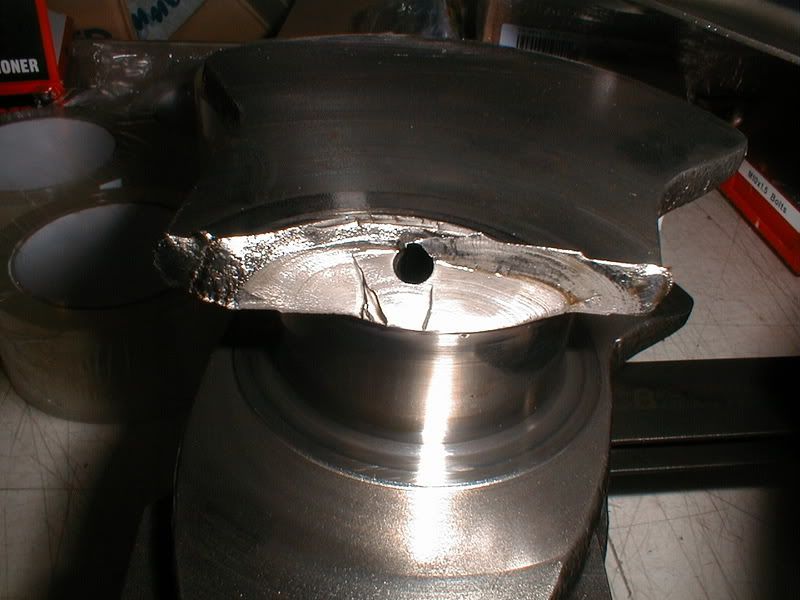

A closeup of the break.
CB performance have basically said words to the effect of "there is not any kind of warranty". :(

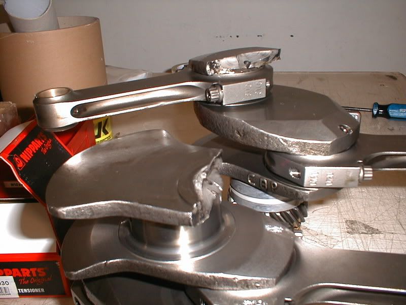

So thats one wrecked crank and a damaged case.
Is this just a one off thing or has it happened to anyone before?

Camera could be playing tricks on my eyes, but is that porosity I see? Those two spots look way to clean in the pic to be sheared. --Ryan

My mates gonna get it checked out by someone that works for BAE making plane parts and has access to all the tools to have a proper look.
If it is a manufacturing fault is there likely to be any way to get anything back off CB?
I know they are all made in china or somewhere but there still should be quality controls in place.

It is an excellent example of the famous two part guarantee, "if it breaks in half, you get both pieces" - it looks like there was a flaw that worked itself back & forth until it snapped. Would a magnaflux have caught this?
