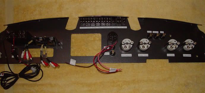

Momentary set back... DelCity botched a part of my order, so they will need to resend a few items. In the meantime I finished setting up the dash and started laying out the "Control Panel". The Control Panel will have an 1/8" rubber base so that if any wire happens to come loose that it will not immediately ground out the circuit (Thanks Bob). Also, I will be removing the relay mounting clips as seen in the pic once install starts.
This is how it is laying out so far...
And the back of the dash...

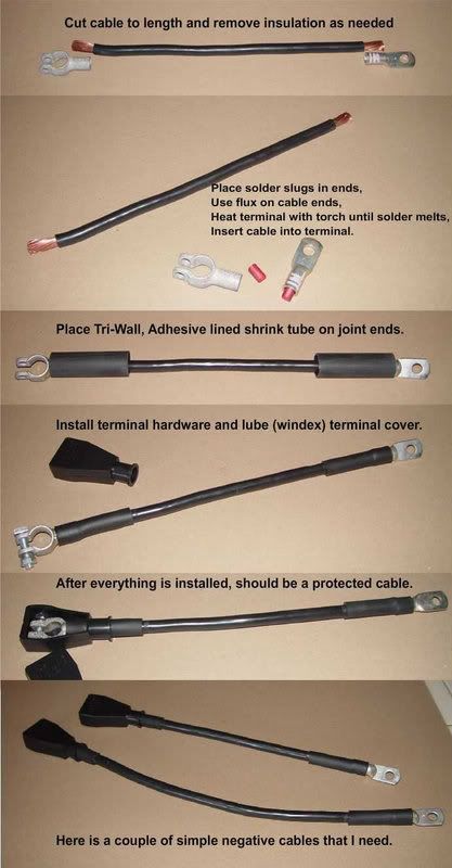

As far as "how I am making my cables". This is the process that I am using to make all of the cables that are in the above diagram. Hopefully, these will be stout enough... :wink:

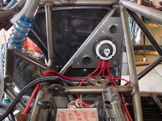

Completed the back half of the above diagram... up to the maxi-fuse. Everything is basically in its final place with minor adjustments when I put the batteries in. Hopefully, my missed items from Del-City will arrive soon so I can continue up to the Control Panel.
So far everything has been done in 1 Gauge and 4 Gauge (4 Gauge is from Alternator to Starter, and the main feed to the Control Panel)
Also, re-positioned the Marine-Grade amp for the satellite radio to under the passenger seat.

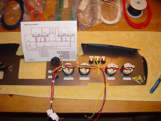

Waiting around for my items to show so I can continue up to the Control Panel. After the Charging Circuit is complete I will be wiring the Computer and Engine, so I wired up the dash cluster tonight so I can incorporate it into the Computer/Engine harness.
The first pic is the diagram that I wrote out to use. From everything that I have read, this is a pretty basic set-up and universal in nature.

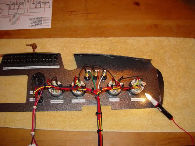

The second picture is the start of the wiring. Since all "sub-harnesses" with have Weatherpack connections, it makes it able to do wiring inside the house with the A/C. I used garbage bag twist ties to hold everything in place temporarily while I was making the connections.
The third pic shows the final harness zip-tied up. After I made all of the connections I did a continuity test to each wire. After that I did a "cross-continuity" (probably not the term) to make sure no wires had continuity that should not. The Weatherpack connections will be added just prior to placing into the car.

really digging the idea of labelling the back side of the panel.
Stealing this one.

2088 bob wrote:What did you end up with using to mark the wires with?
I'm using a different color of wire for each circuit. Found a vendor that was low-priced and an even lower minimum buy.
Timbolaya:
I initially labeled the back so I didn't get corn-fused when I was wiring different stuff. Now it might even come in handy if I have any issues on the road.
