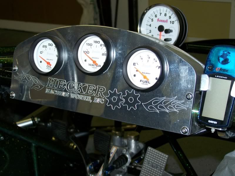

I made this dash for my car. I have a separate switch panel. The boost gauge and tach and mounted separate as well. Maybe not what you had in mind but it may give you some ideas.

Posts: 14100
That's one simple and clean cockpit.

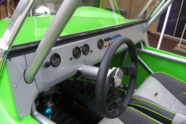

Here's mine in the rail buggy I'm currently building. I bought it blank for $20 from Fisher Buggies and cut the holes myself.
One thing that really helped is I took all of the pieces that I wanted to mount and CADed them up one day at work (boss was gone :D ). I drew all of my OD's and the hole each piece required, then I drew my panel up. I then was able to lay everything out to make sure it would fit, and then printed a few out at full size on paper. I used this paper as a cutting template on the dash. This way everything turned out lined up and even.
