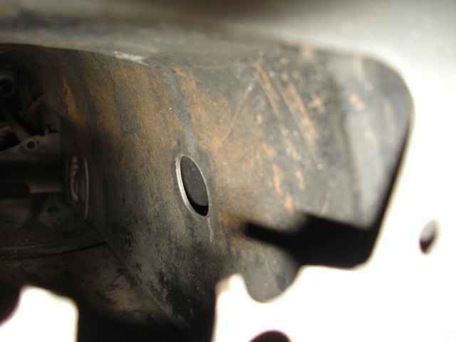

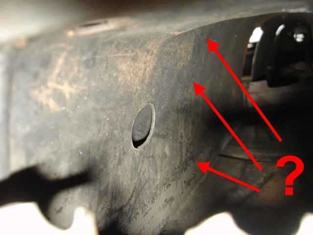

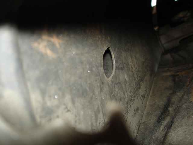

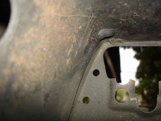

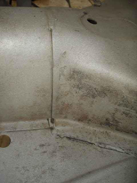

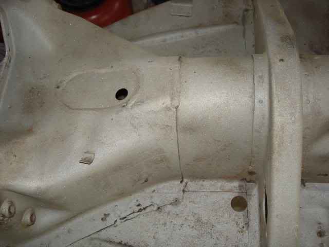

below in red arrows are some of the spots in frame head tha is welded in main chassis tunel...
if it was welded ...shouldnt have a small cut line or weld marks inside? (see below pic)
blue arrows are the spot where firewall is (i will remove it as it is rust) and red arrows where should be some cut. or weld marks should be if the frame head was welded from the factory as a part...

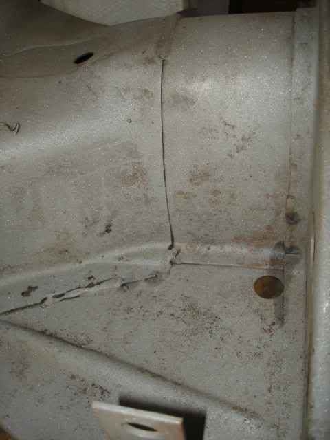

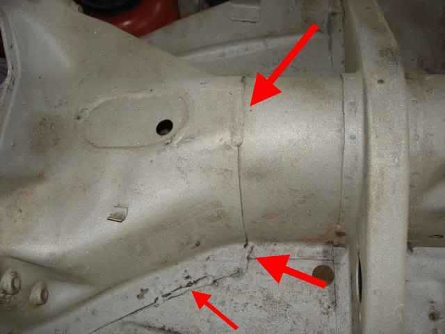

I know on my 74 SB, the framehead connects to the rest of the body beneath the firewall/crossbrace. I would assume that the standard beetles from the same era would have the standard framehead connect in the same area.
Maybe you should get the new framehead first (if you haven't) and see where it attaches before cutting out the old.

Wow! Great pics. Sorry I don't have any to share. I recently did a ball joint
for ball joint head swap. Much, Much easier than I thought it would be.
Bought the head, measured 2-9 times, cut, cleaned, welded, painted=done.
The frame head I used was slightly "female" if you will as the old frame tunnel slid within the new. Prior to attaching I drilled holes through the new tunnel so I could weld the old and new together in the middle of the overlap
and not just the end seams. It came out great!!! Good luck with yours!!

One other thing. The rear edge of the new frame head landed underneath the the firewall lip. I replaced that too.
