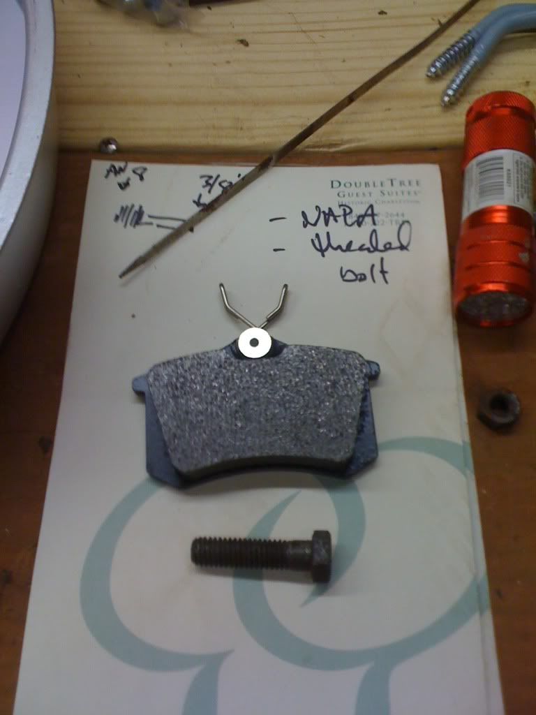

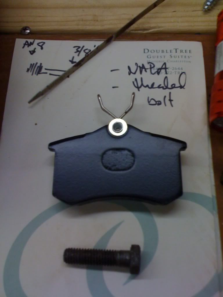

We just converted our road race '73 Super (we've taken to calling it the "Super RS" :D ) to 4-wheel disks. They are EMPI, and the front brakes are definitely the 2-pin ATE/Varga style pads that you pictured. However, the rear pads are totally different. I thought I read somewhere that this is the same pattern as some of the older SAAB sedans but am not too sure. We are eager to get some Porterfield pads for race use but want to make sure we order the correct ones. I realize we can give them tracings and have them custom made but I imagine that would be a bit pricier. Anyone recognize this pad pattern (that is a 1 1/2" bolt for reference)?

Hi Yodogg,
Some good news. Our experience with rear disks (and drums) is that a good quality rear pad works if you have the Porterfields or similiar genuine high performace pads up front.
We've done this enough to advise that you can get by with "stock" rear pads. Just have two sets ... and in practice, "season" (burn-in) both front and rear sets in fifteen-minute runs, going through the usual gradual braking and backing off for cooling phases.
If you're street legal, you can season in the pads before race day.
Take your rear pads to an auto parts store and see if they recognize them. These disk brake conversion pads are usually off a Ford Fiesta, VW Polo, maybe even the current small Chevys.
Or send Porterfield a tracing and ask them if they have a pad to match -- don't ask for custom work.
