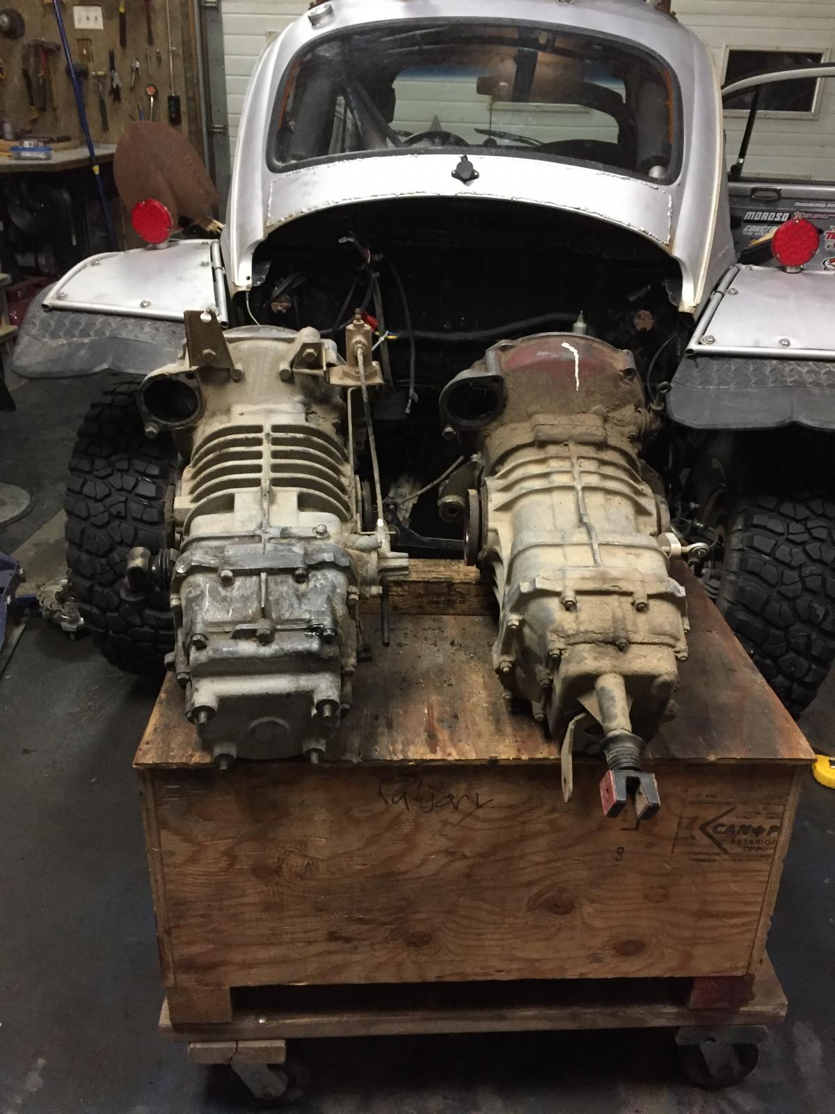

Hello I have been wanting a 091/1 transaxle for my Baja bug off road car. Well I finally got one. Cleaned it up a little took some measurements.seems like it will fit physically. removed the 10* mount I had on the 002 that was in the car and tried to get it on the 091/1.. no go so started to remove bell housing to switch to the 002 bellhousing and wondered if it would go from the back side. Bingo with a small amount of clearancing it fit yahoo. Just have to alter the front urethane bushing. Any ways I was able to get a measurement for the shifter so that's real good. Apparently came out of a 1984 water boxer no model given. Seems real clean inside when I had the bellhousing off with only a little fuzz on the drain magnet

side x side with 002 its a good bit stouter

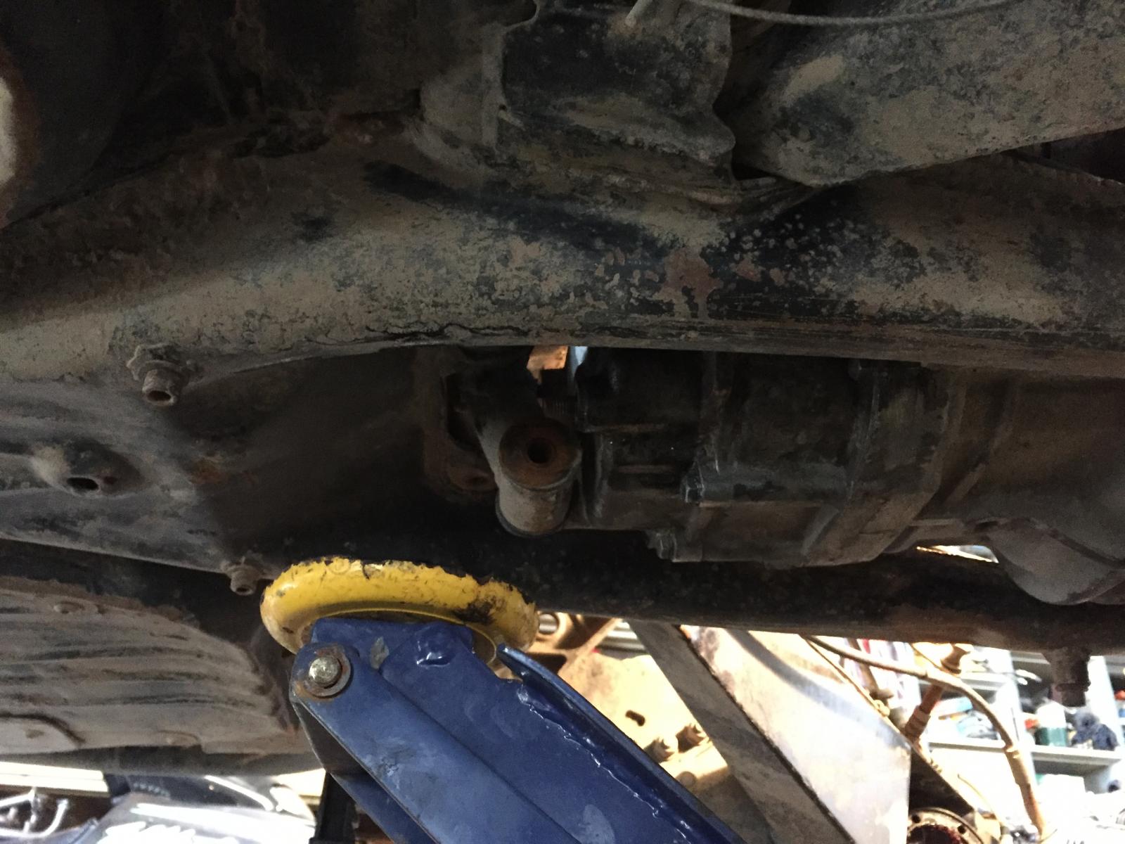

10* rear mount details
Here is the front mount that I will have to alter. All in all I am real happy with the ease it slipped in to the Baja

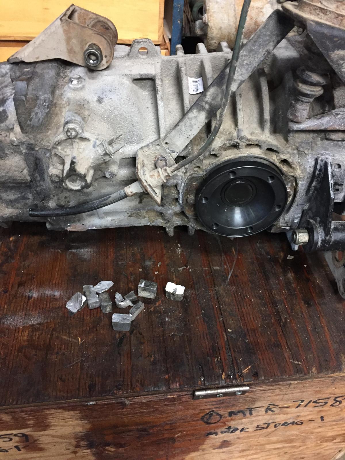

The bits that would not fit between the frame horns :oops: And new 930 conversion flanges
