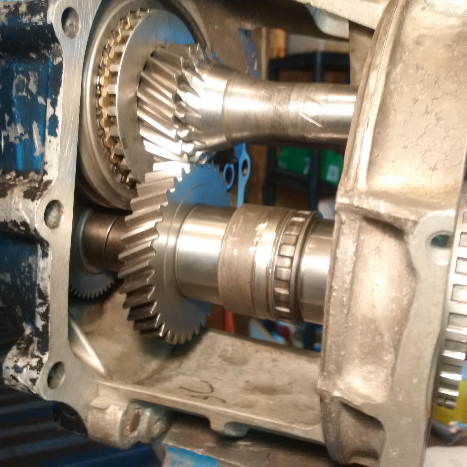

In the months since I started this topic, my customer had a few questions spread around. Then about 4 weeks ago they pulled the trigger and ordered the custom gears from Weddle.
We must have forgotten the choice of a 1.78 3rd because we bought a 1.84. High gear is 0.89. Both on a 4.37 R&P since they didn't think the finished car would be able to go much more than about 80mph.
While I started the trans project, they started cutting up the reproduction speedster to take the batteries. The car they started with was originally set up with a full automatic gearbox, so for the two speed, they had to sort out pedals, shifter and shift rod to the back. They had a dummy 4 speed to mock up the motor mounts while I built the gearbox.
Here's the assembled pinion shaft:

Post by Bruce2 » Sat Sep 09, 2017 8:09 pm
A couple of months ago I opened up a core and found one with the teeth on 1st gear cleaned off, so it made the perfect mainshaft for the 2 speed. I spent a bit of time on the bench grinder to make it look good. I also cut away part of 2nd gear's teeth.

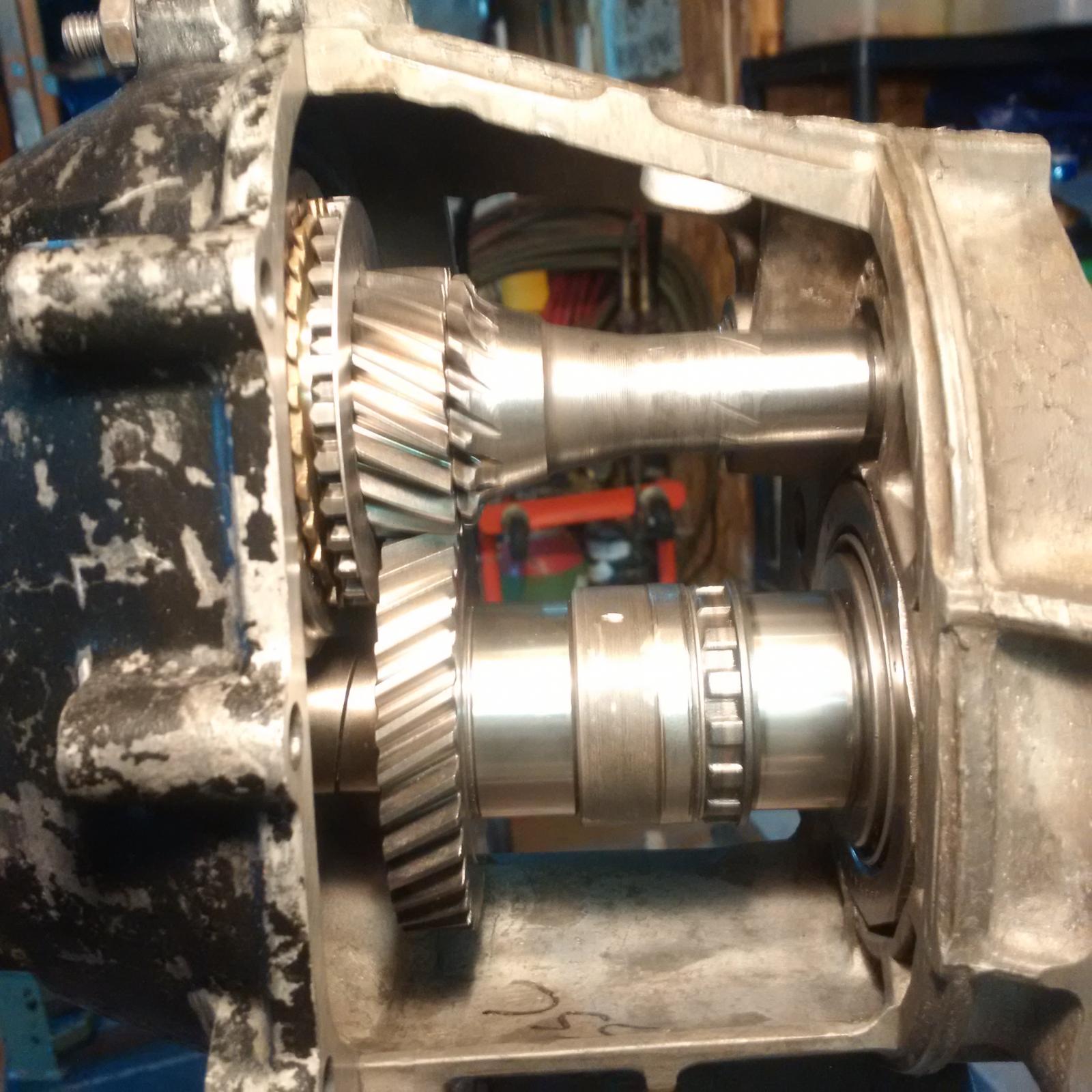

Post by Bruce2 » Sat Sep 09, 2017 8:16 pm
Here are the shafts in the gear carrier with the fork:
And installed in the fixture:

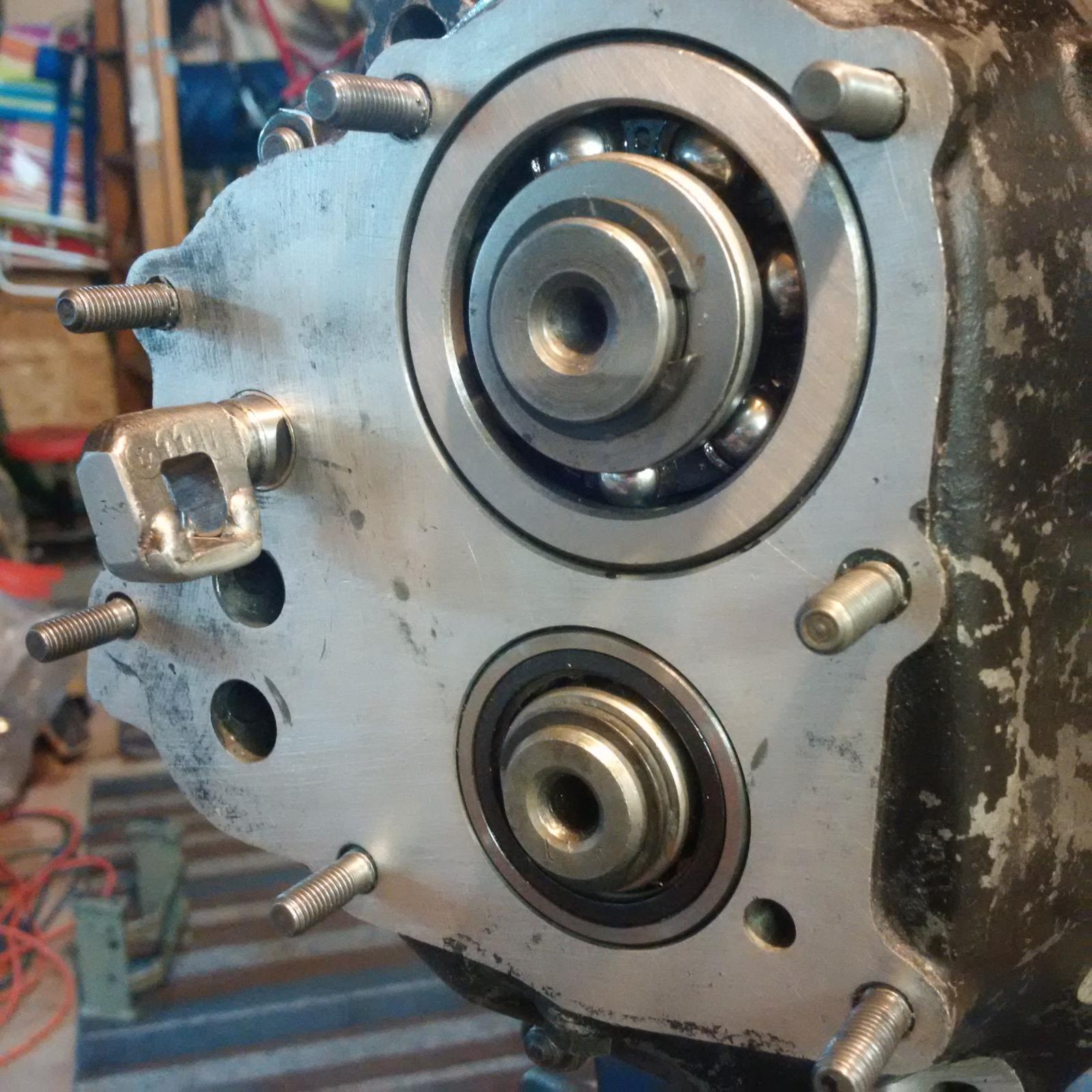

Post by Bruce2 » Sat Sep 09, 2017 8:18 pm
This pic shows the plate I welded onto the end of the 3-4 shift rod to contain the tip of the hockey stick.

Post by Bruce2 » Sat Sep 09, 2017 8:21 pm
This pic was taken minutes before installing the gear carrier and shafts. It sure went in easy when you don't have to play around with the reverse idler gear.
