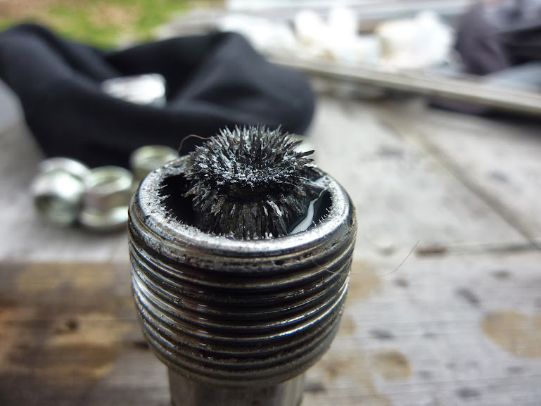

Ok, I've put 415 miles on this rebuilt transaxle. It is shifting smooth and feels great. it ended up with a LOT of new/used parts inside, main shaft, barings, 1st, 2nd gears, reverse idler, super diff, and a bunch of other stuff. I was told to change my gear oil after a few hundred miles because all the gears were re-positioned. here is my drain plug after 415 miles.
what do you think? too much metal? about right? check it in another 500 miles?
when I cleaned it off with a paper towel there were no big chunks, just fine particles.

Too much stuff on that magnet .. possibly R&P breaking in at new mesh position.
The next oil change will reveal if a real problem exists.
You are of course using a good GL-5 gear lube ?

It is a little more than I expected to see. i'm using valvoline 80w-90 durablend, it is GL-5. i'll change it again in a few hundred miles and see how it looks. unfortunately that will be in the late spring, it's getting cold and they'll start salting the roads soon. I was hoping to find pictures of other people's drain plugs after a re-build to compare but could not find any.
