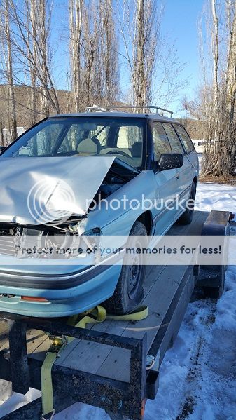

Trying to show new picture of leagacy decided to go subaru power got a 91 with front crash still fires and runs drove it on the trailer, got the adapter on the way then mount engine to get ready for wiring harness.
