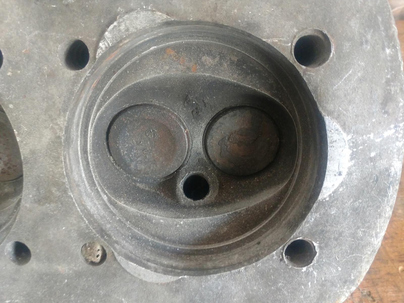

Also I noticed when I was rummaging through a school bus full of heads I noticed some had these 3 little nubs on the heads and some didn't. We're some flycut off or did some come with and some without?

There were different ways to strengthen the heads in that area with the 3 raised parts being one of them. VW's stock chambers are a simple wedge head with more squish and also more valve shrouding.
