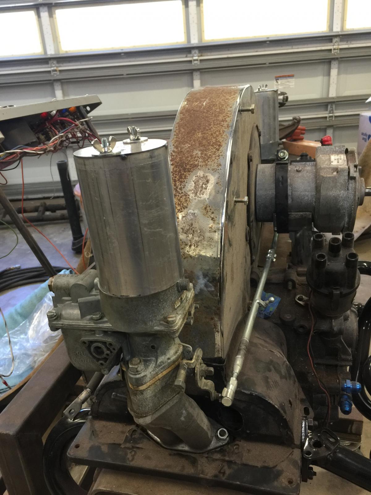

First thing is to make pressure hats for the carbs and get rid of that stupid air cleaner stud/bridge piece on the carbs:
3" exhaust pipe works perfect for pressure hat.
A split open length of vacuum hose might work for a seal. If not, we have other ideas
Test fitting
And sitting on the mock-up motor

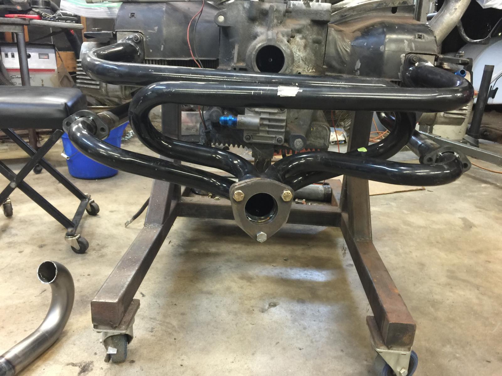

More progress and with the EMPI header bolted on
The header got a ton of re-work. The crappy thin exhaust port flanges were all replaced with 3/8" THICK flanges from Tiger @ A-1 Muffler. We also used these same flanges for the J-pipe joint. Then we de-burred and removed booger welds inside the collector and made 3/8" thick flanges for it also.
